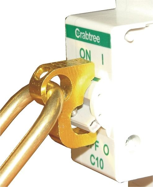

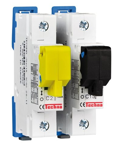

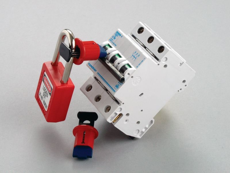

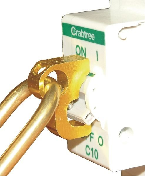

There are lock off and lock on adaptors. Lockoffon.jpg But it does depend on the make of the MCB,
If you could do that, you'd be negating any overload protection the MCB offers.

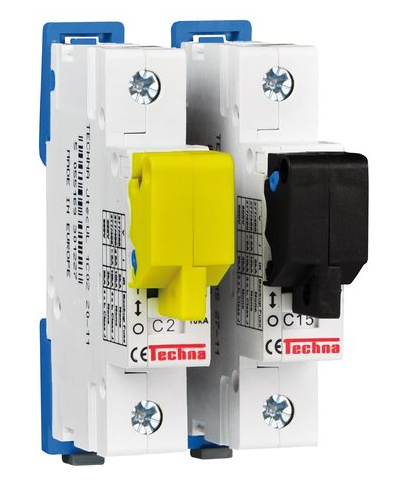

Depends on the make, but all I have used you can't defeat the tripping mechanism by hold the lever on. With this dmeu_lockap1_1_std.lang.all.jpg on this MCB it could lock on or off, but does depend on MCB design and in real terms all it does is show anyone that the MCB is on or off intentionally as those little wires could soon be ripped off.
This one dmeu_lockap1_1_std.lang.all.jpg with a screw which clamps the lever would be harder to remove, the lock prevents access to the screw, but since a screwdriver is a tool don't really need the lock.
Because to reset when lever is held you need to switch off and on again, it means should it trip no one but key holder can reset it. For essential supplies using the lock can result in the reverse to what was intended.

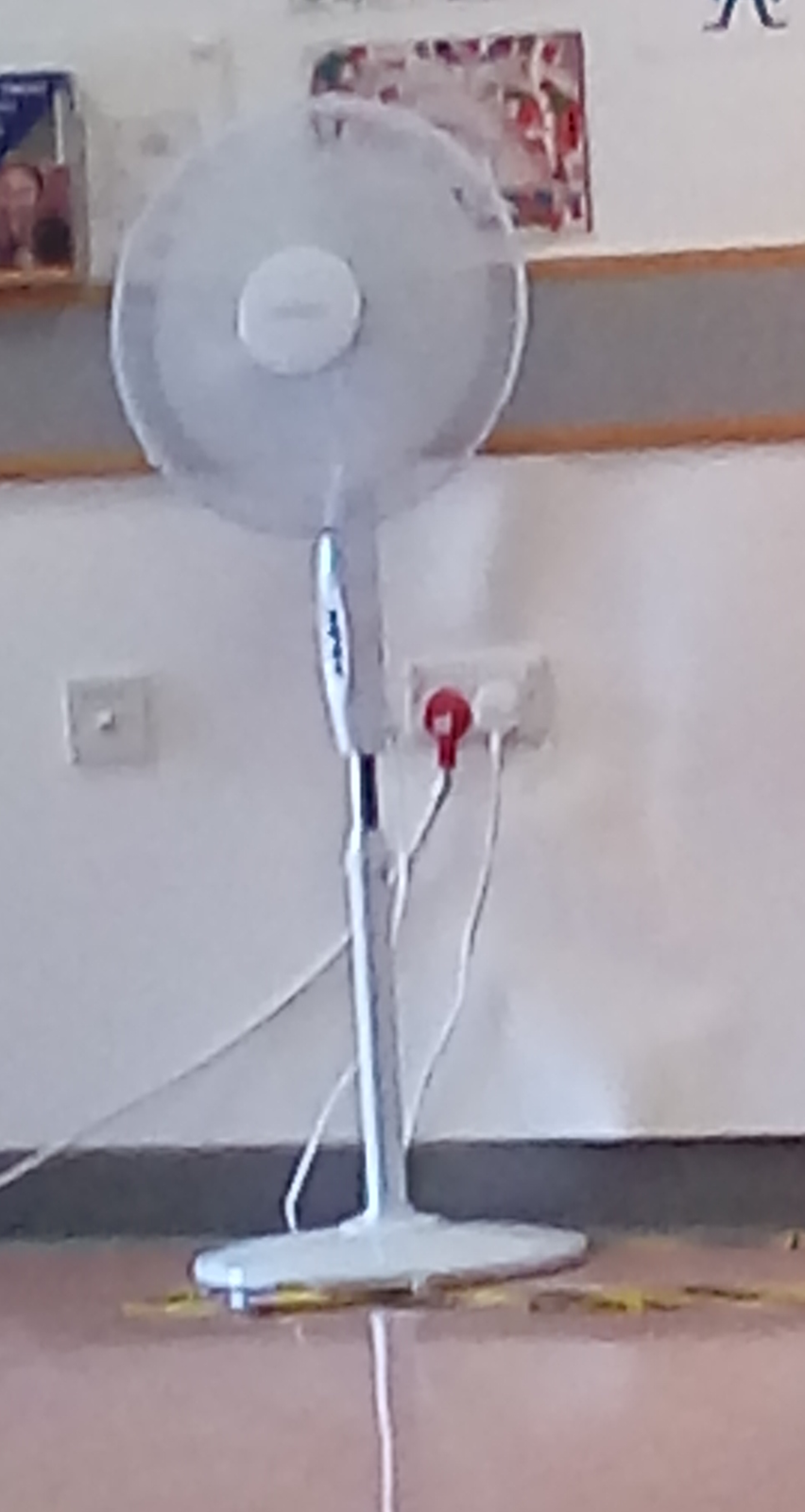

I came across this a couple of weeks ago in A&E:
The other end was a line of 4 metal clad DSO's which only appeared to be held together with coupler/bushes and just one fan plugged in. Seems like an abuse of the concession to me.

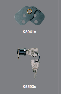

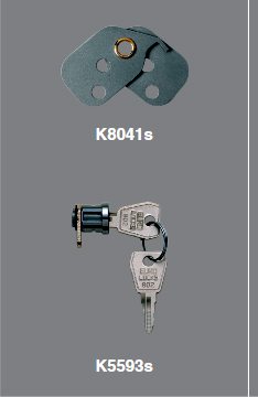

K8041s LOCKING DEVICE FOR USE WHEN LOCKING A SENTRY MCB, RCBO, RCD OR SWITCH DISCONNECTOR IN EITHER THE ON OR OFF POSITION.
K5593s BARREL LOCK AND KEY KIT SUITABLE FOR SECURING ‘K’ SERIES SENTRY CONSUMER UNIT LIDS.ONLY SUITABLE FOR HYBRID AND INSULATED Consumer units.
Sorry about caps, was copy and paste from MK PDF.
Problem is MK stuff is obsolete so not sure if you can get it any more.
View attachment 208033 K8041s LOCKING DEVICE FOR USE WHEN LOCKING A SENTRY MCB, RCBO, RCD OR SWITCH DISCONNECTOR IN EITHER THE ON OR OFF POSITION.
I sat there looking at the picture trying to work out how those 2 items were supposed to fit togeter. A case of where a picture doesn't paint a thousand words:notworthy:
