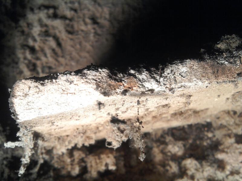

Just opened up a chimney that had been sealed with plasterboard in my 1910 house. Looking up inside, the opening is partially covered by a white board. Question is... is this some form of asbestos?
There are no obvious fibres sticking out of the cut part of it, there are some slight sparkly bits if you look closely at it.
So, can I dampen it down and carefully remove it (not even touched it yet, but it might be inserted into the brickwork), or call in the cavalry?
If the latter, anyone know a reliable asbestos company in the Birmingham area?
Help! :cry:
Here is a view up my chimney (steady!) and two closeups.

It's most probably asbestos cement board, but you should assume so in any case.
If you can remove it in whole - including the attached mortar, then do that and double bag it and the council will collect from the front garden.
Dampen the area, and if there is a good draw up the flue, then open some windows to maximise the draw and wear a mask.
Try not to break it in too many pieces or break the mortar off it.

After giving it some thought, I figured I'd get it tested to see if it was asbestos cement (probable - not so bad as low asbestos content and fibres are mostly bound to the cement) or asbestos insulating board (unlikely, but much nastier, has brown asbestos and readily sheds lots of fibres).
So, mask on, windows open, try and break a bit off to bag and send to the lab.
Crikey, its tough... really hard stuff. Hold on, its not bedded in to the brickwork or anything, quick wiggle and... out it comes (with a load of soot)! Into the bag, another bag and job done. Ready for the council to collect.
