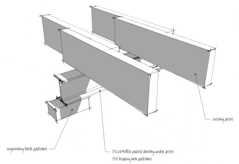

So that's a 152x89UB16 tight under the joists, with 150 bearing to an engineering brick each end.
Looks like this:

Are you saying joist span is 4.8m in total or both sides? If the former, my original design is well in and a 178x102 is stronger than a 152x89, so no problem; and if the latter, the 178 is fine anyway. I took the partition on top of the wall, in reality it's slightly less load onto the beam.

Ahah another Sketchup afficionado :).
Yep eng brick is fine, but just turn it through 90° from my detail. Cut out a slot for the eng brick either end, put the beam in first and acrow it up to the underside of the joists so it's tight to them. Then install the padstone tight to the underside of the beam on a 10mm mortar bed. If you've got the cutting out depth wrong, don't put a thick mortar bed in, but pack between the padstone and the underside of the beam with slate or steel shims the following day, then remove the acrows.
Before you start knocking out, put the temp support on the side where the partition upstairs is, about 200 back from the wall face. You won't need supports both sides, as the joists can span to the temporary support in the short term, as they are continuous from one side of the building to the other. The deals can go directly onto the plasterboard ceiling.
