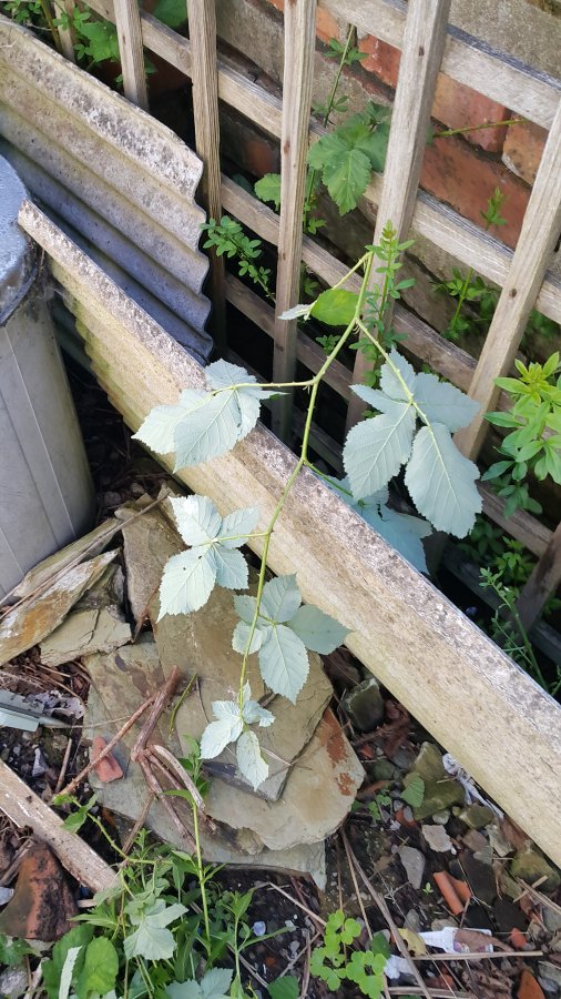

Hi
Two corrugated sheets been in my garden a while, ever since I moved in anyway. I am tidying up this corner and need to move them.
Not sure if it's asbestos though, any ideas please?
Mike

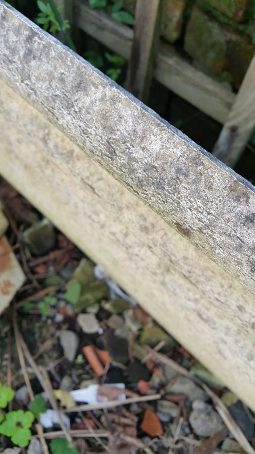

Easiest way to tell is snap a bit off and have a look at the fibers. Then take a lighter/blow torch to them and see if it melts or just glows red/white hot.
Without a microscope to look at the fibers, you will not know for sure. But, that looks very typical of asbestos cement corrugated sheet that is very common on older outbuildings/garages. For your info, there is not much ACM (asbestos containing material) in it, and the fibers are well bonded to the cement type matrix. If it is left in tact it will be of no health issue to you. If you smash it up with a hammer and put it in a fire, you will liberate the fibers and cause an issue though!
I bet your local tip has an asbestos facility for this. Put a plastic sheet in your boot and take it there. Sorted.
Thanks everyone, thought so, will phone council and check which tip to take it to.
Cheers.
Are you having a laugh?!? If it is asbestos and it's intact then it's perfectly safe. Perfectly. As soon as you start releasing fibres though...

But it works, cement board is reinforced with fiberglass which melt, the asbestos fibers do not.
So if the fibres don't melt that's a good way of checking if you've just released asbestos fibres?!
LOL
The asbestos in these sheets are embedded into the substrate, this material is so stable you'd have to sand it to get anything from it.

Take a look at your local council wesbite who do a pick-up service. A service like this is idea for un-broken sheet like what you have.
Nozzle
Thanks nozzle tried that route already they only provide collection for small amount's which fit in a bag which they supply. These sheets won't fit unless I break them up, which I'm not prepared to do..
