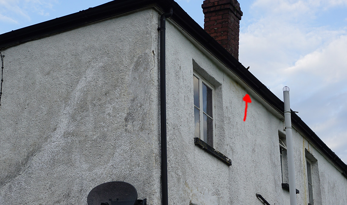

Get someone to take another look , check out the soffit in your pictures...something is moving or has moved.
Would the Structural Engineer be the person to do it and confirm it in writing?
Is the below picture showing what you mean? The builder did pick up on this and said he wouldnt know whats caused it until they were up there dismantling the chimney. What could have caused that!? As you see, it looks to have sunken inwards! (Maybe many years ago because the soffit itself looks intact)
yes your arrow is where I am talking about.
But also as well as that and on the end elevation there appears to be a large diagonal movement crack repair that has been patched ( not the vertical one on the corner)

The adjoining building Soffit and fascia look better from what I can see.

Wow - youve got a keen eye. Yes, the builder mentioned that diagonal crack. Theres a few like that dotted around the walls(!) The builders have said the cracks are just settlement and common on a building of this age which hasnt been well maintained. Again, I suppose its hard for them to tell until they start get their hands on it to see whats going on. Their plan is going to knock off the blown patches of render and repatch with lime render (its cob).
