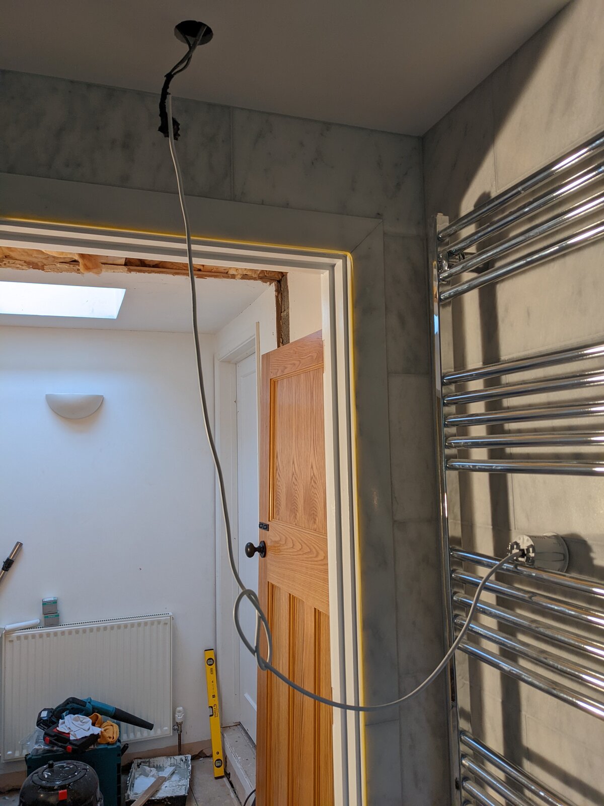

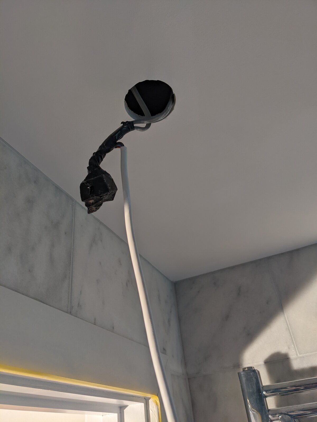

I've just had some work done from a company that has charged top money. One item fitted was a PIR sensor that I dropped down to change the delay setting. On doing so I found this...
The connections appear to be made using WAGO's. Is this considered to be acceptable?

Wagos are OK but it looks like the installer has used sticky tape around his work, which is not.

I would have expected the connections to be placed in a WAGO junction box, rather than just wrapping tape around them hiding in the ceiling recess.
is it switching mains voltage?
it looks like the sheathing of (some of?) the cables has been stripped back. In this case they must be enclosed in something giving equivalent protection. Sticky tape does not do this.

To access low voltage (50 - 1000 volt AC) it needs a tool or key, with the exception of a ceiling rose, insulation tape can be removed without a tool, so not permitted.
412.2.2.3 Where a lid or door in an insulating enclosure can be opened without the use of a tool or key, all conductive parts which are accessible if the lid or door is open shall be behind an insulating barrier (providing a degree of protection not less than IPXXB or IP2X) preventing persons from coming unintentionally into contact with those conductive parts. This insulating barrier shall be removable only by the use of a tool or key.
412.2.4 Wiring systems
412.2.4.1 Wiring systems installed in accordance with Chapter 52 are considered to meet the requirements of Regulation 412.2 if:
i. the rated voltage of the cable(s) is not less than the nominal voltage of the system and at least 300/500 V, and
ii. adequate mechanical protection of the basic insulation is provided by one or more of the following:
a. The non-metallic sheath of the cable
b. Non-metallic trunking or ducting complying with the BS EN 50085 series of standards, or non-metallic conduit complying with the BS EN 61386 series of standards.
