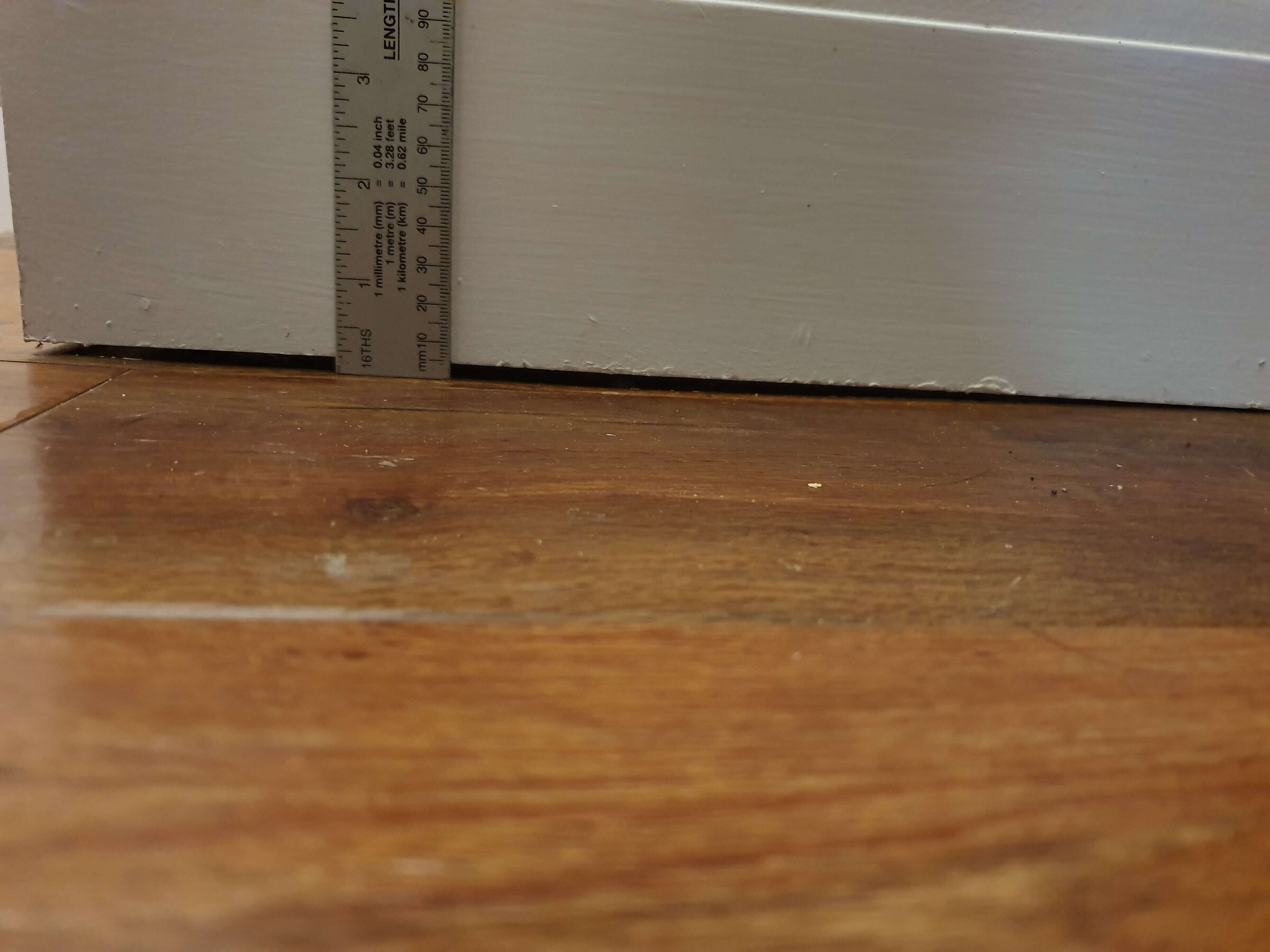

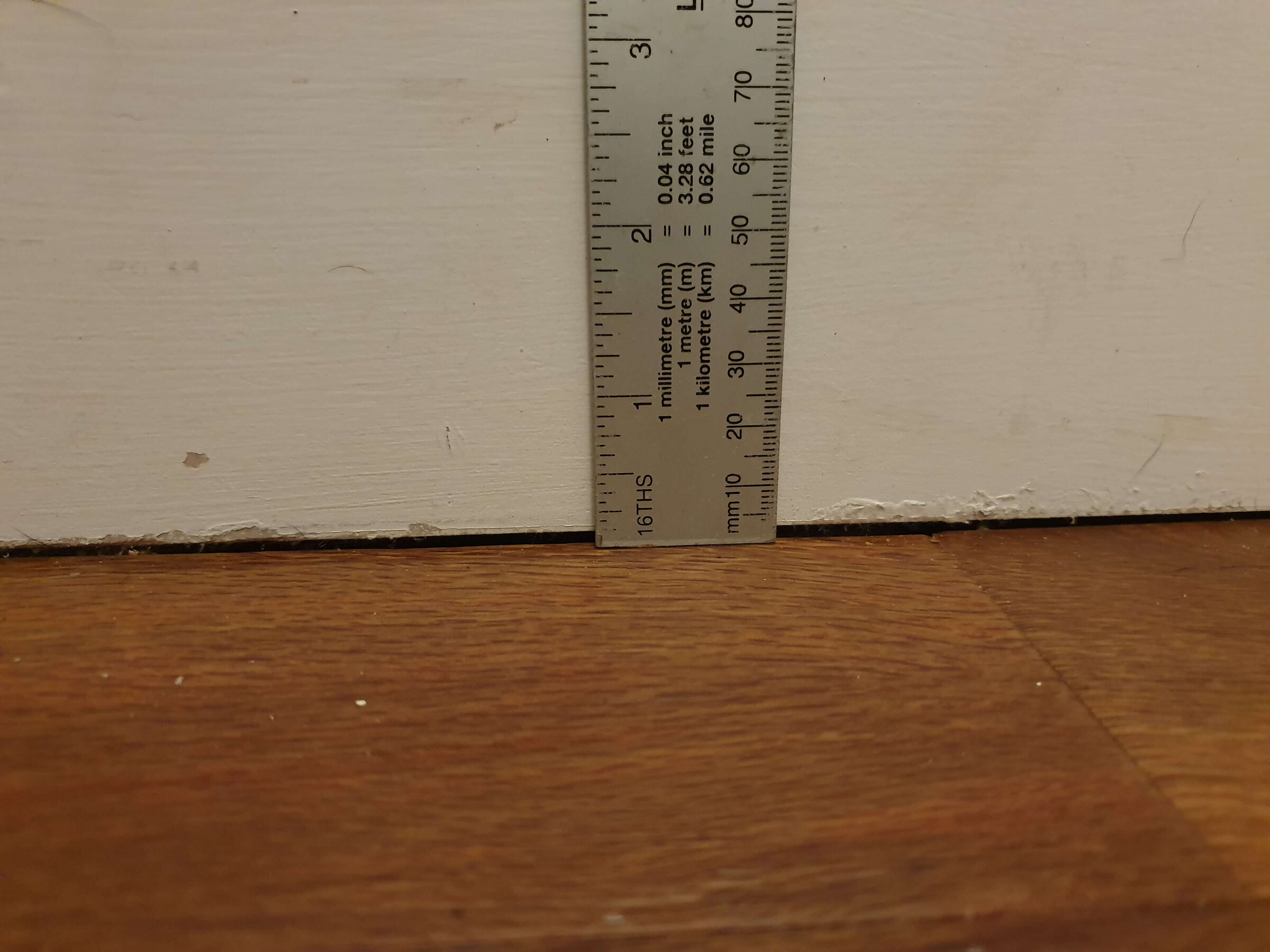

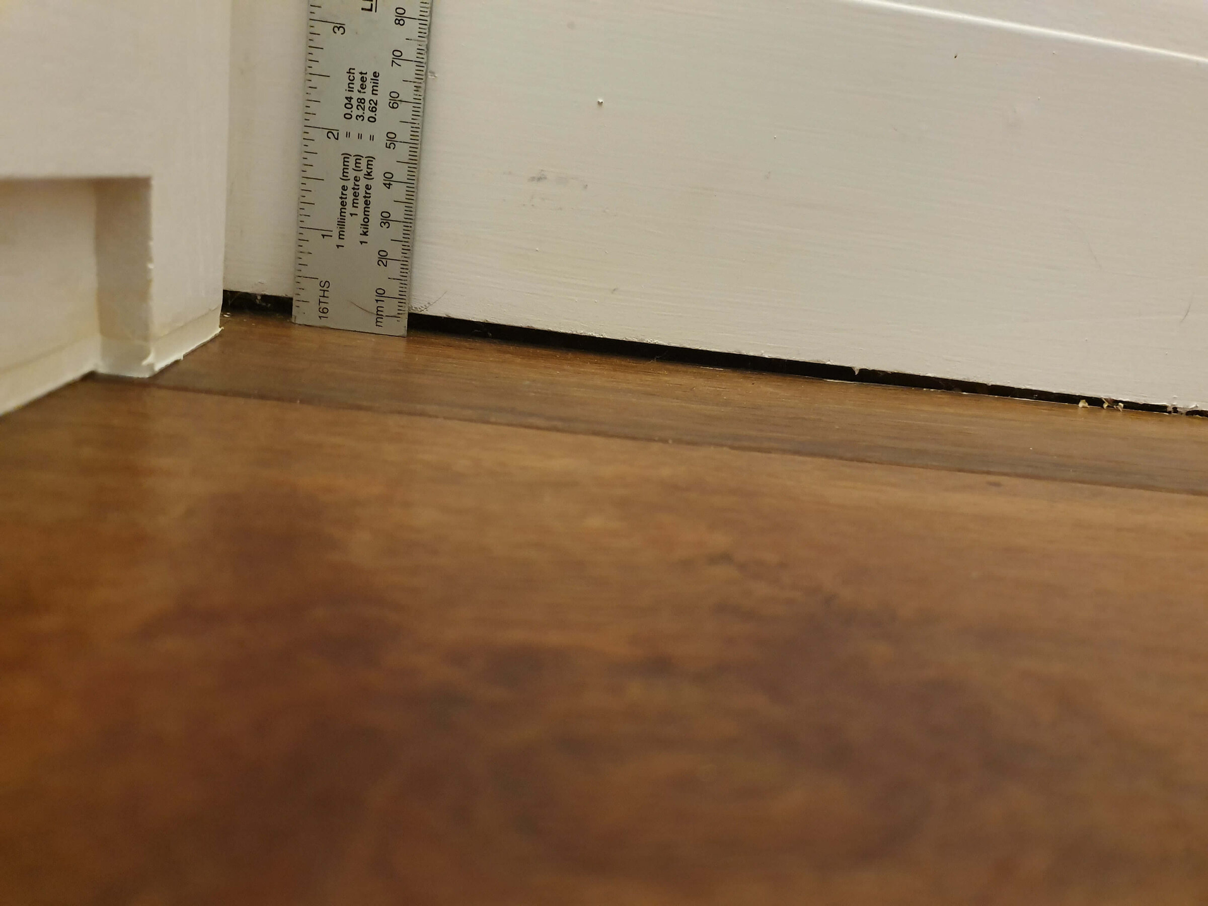

I hope you can help me. I do a little DIY, but I have a lot to learn. The current cold snap has made me realise how leaky my house is and I am on a mission to try and patch it up. I have noticed in our kitchen that there is lots of cold air coming in between gaps between the floor and the skirting boards. The floor is concrete with LVT (sadly we did not realise how uneven it was when it was done) and the walls are mainly dot and dab.
The gap between floor and floor board tapers down from about 5mm to 0. If I taped up the area, to avoid spoiling it, is there a way to get expanding foam into that small gap?
I have found items in America that look promising, but I cannot find similar in the UK
Is expanding foam suitable here? And is there something I can use to help direct the foam into that tight spot?
I do have a foam gun, if that helps.
Thank you!
Foam is not suitable here if you want to do the job with the skirting and flooring still intact.
You can get neat products like DraughtEx or other clones that are a foam rod you shove in and it expands.
You might then want to investigate where the air is comming from in the first place - if the joist ends are exposed into the cavity without filling gaps around or the dot and dab does not have a continuous perimeter of dabs perhaps.

Thank you all for your suggestions. I'm sorry I was not clearer, but the flooring is not floorboard - it is just vinyl tiles on a concrete subfloor (with underfloor heating).
In other parts of the house where there are floorboards, and the same problem, I have used caulk and that expanding foam (not at the same time). The foam works well, although is hard to squeeze in. But you need a certain size gap.
