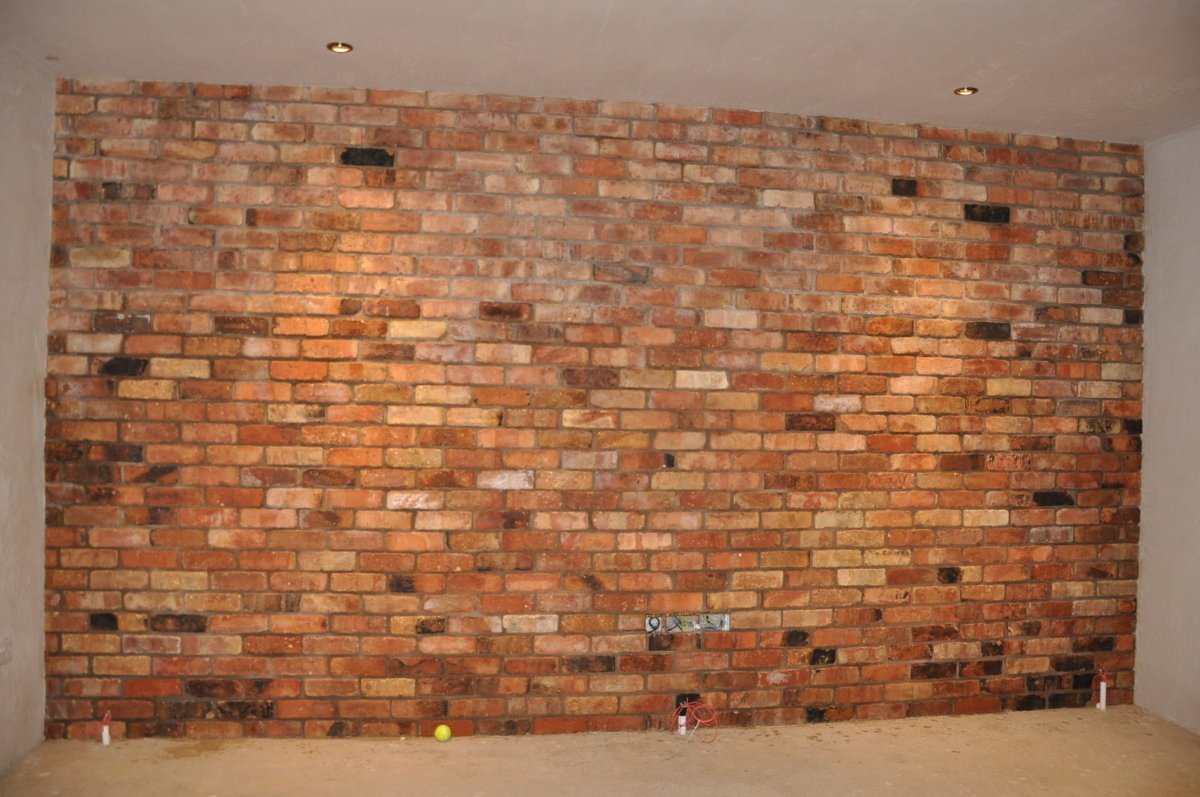

There are sealers on the market that creates a barrier within the fabric of the brick that allows water vapor to breathe out, but stops the water soluble salt molecules from migrating to the surface.
Amongst the possible problems are hygroscopic salts or that the brickwork has been washed down. Need to identify cause before applying solution (in both senses of the word!)?
Could be that every time salts appear its washed of with water which encourages the cycle.
Yes that is probably effloresence. Moisture from the air in front of the wall or from within the wall is the main cause.
As they are reclaimed bricks, the salty bricks were probably at or below ground level in whatever building they came from.
Keep brushing the salts off and it will eventually stop.
Hi Tony, its been a year since the internal wall was constructed, is it possible that moisture is still being pulled to the surface.
PS - its a question and not a statement. :) See even put a smiley face.
Dunno, but the presence of the salts suggest there is water from somewhere which is evaporating and bringing the salts to the surface.
Initial water from construction? Water penetration from outside? Condensation? who knows?
Agreed - Had the same issue on a grade two listed building that remained on site during a new build. It only became apparent near completion when the heating was being commissioned. We were advised the salts absorb back into the masonry when there is a high moisture content and get pulled to the surface when the air becomes dryer. We use a product to clean of the efflorescence and a microporous breathable liquid membrane was applied to hold back the salts. We remained on site a further 7 months during the summer I might add, with no sign of a reoccurrence.
Hi all
thanks you so so much for all your replies.
I have attached a pic of the whole wall. It is ground floor of a 2 story extension. The upper rows are all effected, and then random bricks lower down.
There are about a dozen black bricks, which must have come from a chimney - why is this bad??
I must admit, I hated the black when I first saw it built, but now I've got used to it, they add to the reclaimed look!
I know the builder applied some sort of acid to the whole wall, and then applied larson acrylic sealer to the brick wall and concrete floor. ( the wetmarks at base of wall are from this sealer), but I have tiler coming this week to tile the floor.
We had dehumidifier running for a few months last winter to help house dry out, and there isnt an issue with condensation. I really cant see water getting in from outside.
All the bricks feel really dry.
I haven't been washing the wall, I attach the hard brush onto the hoover and run the hoover brush over the whole wall, but I literally dont want to have to hoover my wall forever.
