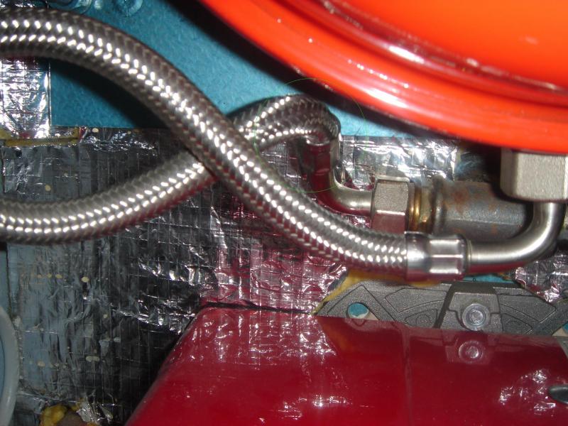

Inside our boiler we have this expansion vessel - please see the attached picture.
The flexible hose seems a little bit kinked where it comes off of the boiler.
Would this stop the vessel from working ?
Would the best way to test to see if it is working is to check the pressure when the heating system is running ?
Cheers
its probably not kinked enough to stop it working, but it will be a potential blockage point and yes, if the pressure rises excessively with the heating on there's a problem. Don't recognise the boiler..is it oil?

It is an oil fired boiler - a Grant Vortex.
The vessel is precharged to 1 Bar.
When the heating in on the pressure rises to around 1.3 Bar on the built in pressure gauge.
If I place a pressure gauge on the valve of the vessel when the heating is running then I should also read 1.3 Bar.
Is this correct ? This would tell me that the expansion vessel was seeing the increased pressure ?
Cheers
The fact that the heating is only rising 0.3 bar is indication enough that you have adequate expansion so I wouldn't be too concerned. It would only be worth checking the vessel while the system is drained to check the air pressure.
The hose looks perfect to me, and your pressure testing backs this up so no worries
