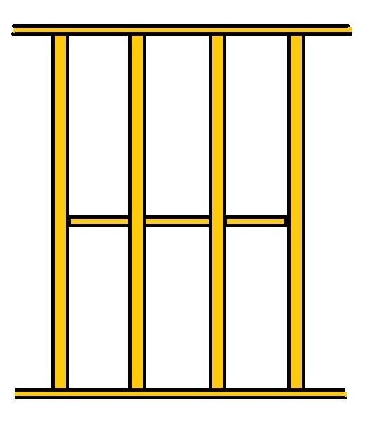

Thanks for your reply.
The timber structure was already there when I removed a slatted roof.
Does it have to be 600mm apart?
I was thinking of putting up the boards in 4 pieces. Each being 1.2m long and 85cm wide.
I have got plasterboard screws to fit them to the batons. Do I Need to use any adhesive atall for further support or are the screws suffice?

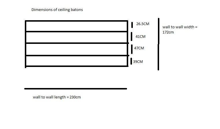

Okay. Just trying to picture it.
My room width is 170cm and the length is 230cm.
There is one baton on each wall for the structure (one each end, one each side) and 3 more beams across the length (230cm) of the room to provide the support to the middle of the frame.
If i get 900 x 1800 boards I can fit each board across the room (170cm). This means that I will need 3 boards that size to make up the length of the room (90cm x 3 boards = 270cm so will have a bit spare.
will I need straight edge or tapered boards for the ceiling?
The width between the batons working from one side wall (230cm) to the other side wall (230cm) are: 27cm, 41cm, 47cm, 39cm.
So whoever put them up first of all didn't even them out obviously! Will this matter when putting the boarding up?
As you mention having to overlap, as I am putting the boards ACROSS the beams, does this still apply or should I just fit them as close as possible?
Sorry for long winded question, first time at this so want to give it a good go. Thanks.

Are the three batons across the middle of the image referred to a noggins?
If so, am I right in saying that I need to put this noggin between the long beams across the length of the room, covering 88cm to 92cm if I were getting a 90cm board? - so that the edge of each board will have 2cm on the beam to screw in to?

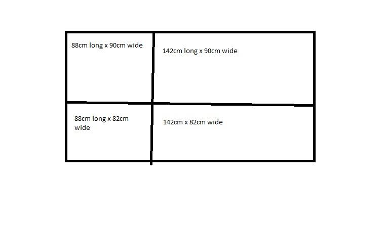

I have now drawn up a final diagram of the ceiling batons for you to have a look at (please see image below)
I have purchased 3 more batons measuring 2300mm x 25mm x 39mm, which i intend to use for fixing across the framework, providing the support. is it best to nail the support batons in?
my plasterboard sheets had to be cut to 142cm long x 90cm wide. I have 4 of these sheets (all are square edge, 12.5mm thick).
what i plan to do in terms of putting the plasterboard up is as follows:
Does this plan look okay?
Last bit of help then i'm done - am i right in saying that the baton to go ACROSS the beams, should be spaced at the points where the two boards meet? So in my case i make this at 140cm - 144cm, to allow for 2cm of each board to be on the baton for screwing.
Im going to have to put another baton in across the middle of the room (length ways - 230cm) at 88cm - 92cm distance from the wall so that the boards can each rest on the edge of the baton and be screwed in.
And once all of the plasterboard is screwed in to the ceiling, i will put tape over the joints. I intend to be painting this plasterboard, so will the tape alone be suffice or will i have to get it skimmed? If i need to fill the joints aswell, do i do this AFTER i have put the tape on? (if so, is plaster finish okay to use, or just any gap filler?)
Bare in mind this board is on the BATHROOM CEILING, will i need to put a primer on to prevent any moisture damage? Any suggestions on what to use that wont break the bank?

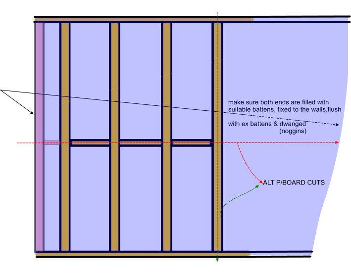

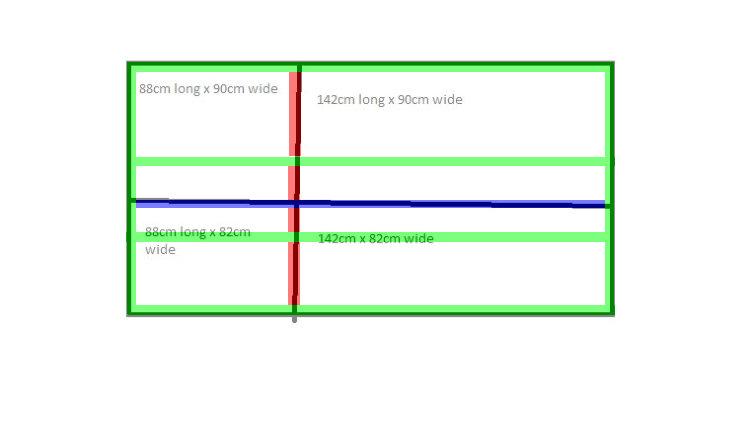

OK, going back to your original post and in particular the photo of the existing joists/battens, there are 4 in number running the length of the room, so forget everything I've said/sketched so far, the procedure for you should be as follows :-
Ensurer each room end of joists are in filled with dwangs (3 each end = 6 in total) each cut to fit it's particular gap/spacing, only one other row of dwangs is required across the room, between the joist and in line with the p/board cuts running across the room. You can put another row in which would help stiffen the framework, but is not really ness. But I would cushion using 25 x 39 mm as dwangs, 50 x 50 mm would be my choice, but if you intend going ahead with the thinner material, I would pre-drill these on the skew and screw them into the ex joists, bearing in mind everything I've said above, here's a sketch -
[I've overlaid your p/board sketch onto the assumed ex frame set up colouring the ex joists green and an extra one (if it's actually required?) to catch the central cut! and coloured this blue. But i wonder whether you cant twin this with one of the ex, to give you a wider fixing to the central cut(s)] ...pinenot :)
