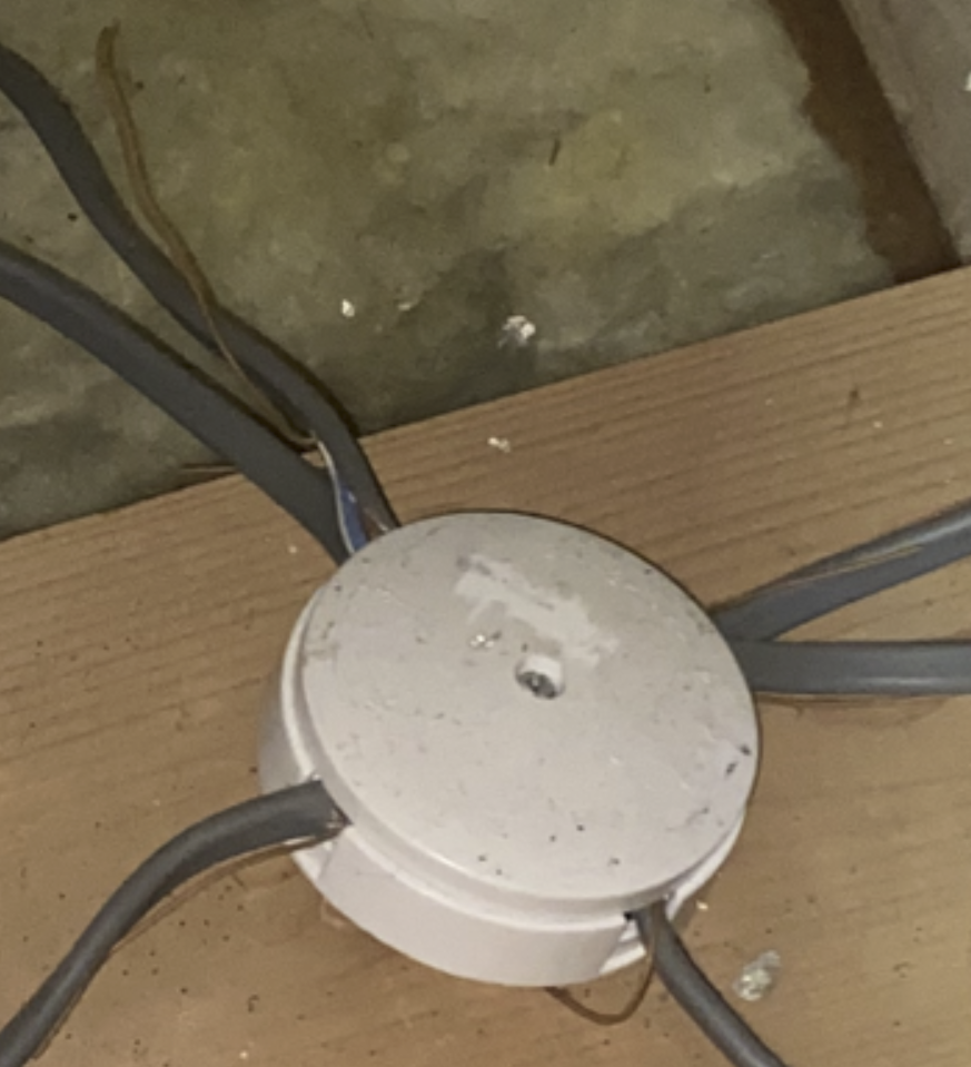

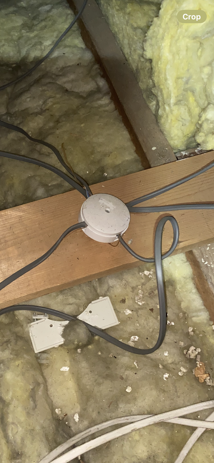

Hi all,

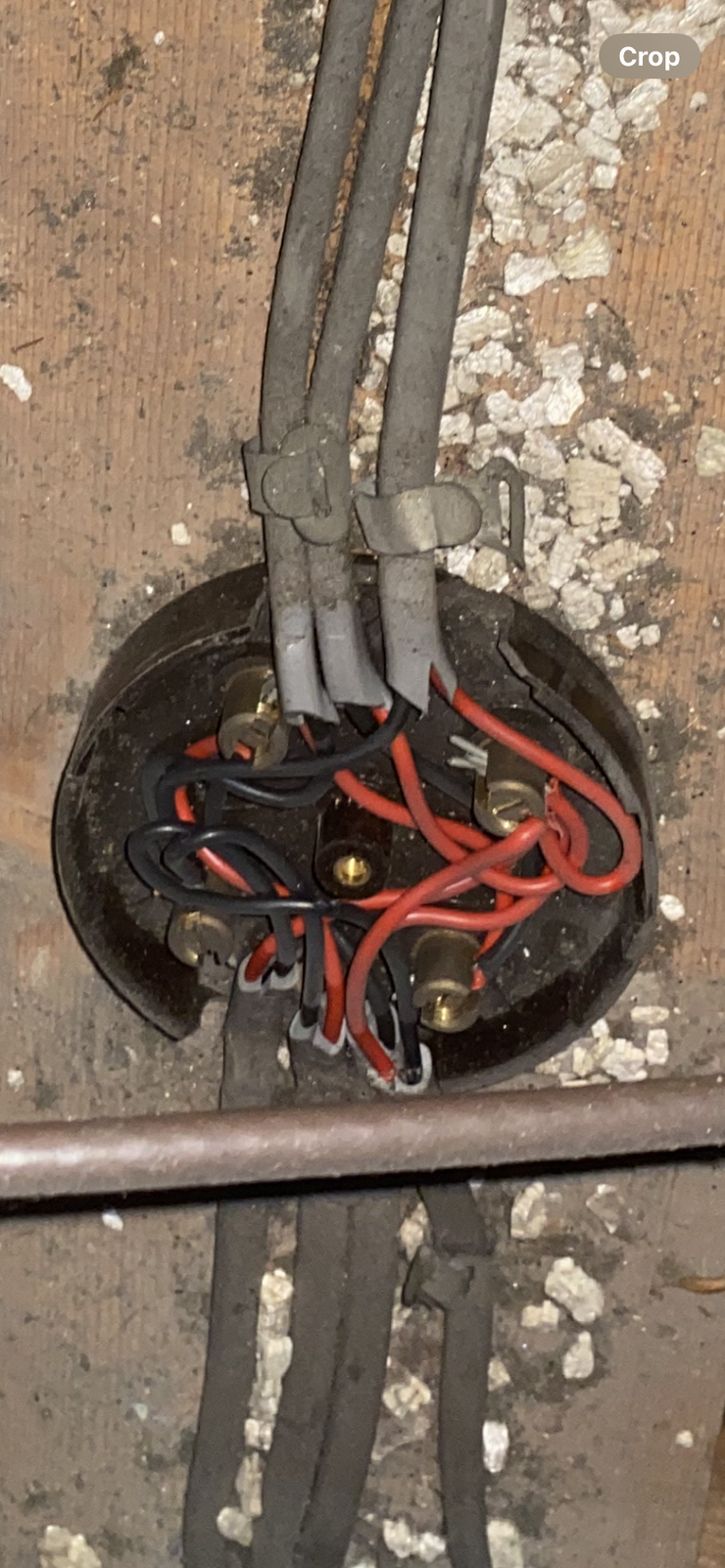

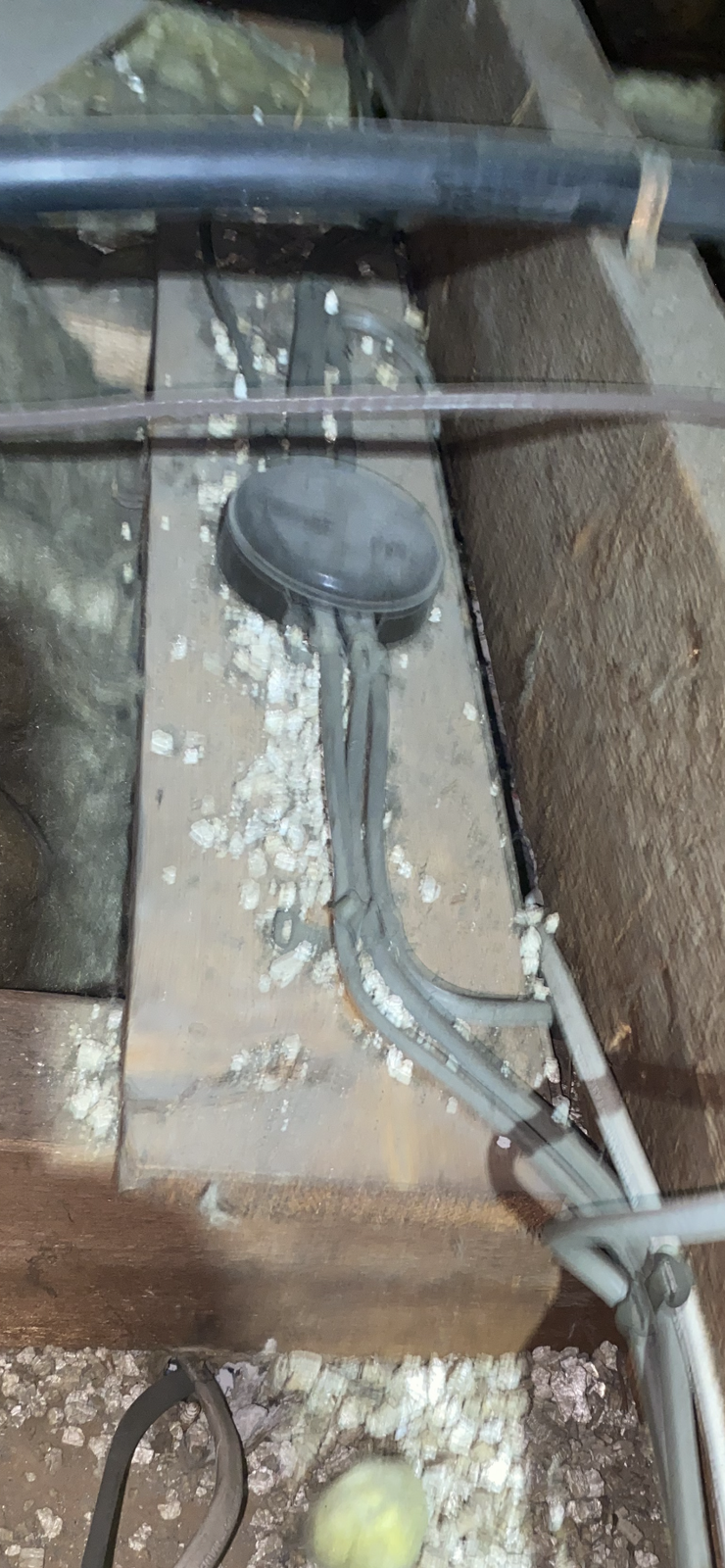

I’m looking to replace a pendant with 4 downlights in a bedroom at my Dad’s place. The wiring is from the 60s, a single lighting circuit for the whole 3 bed house with no earth. All the first floor lights are radial spurs fed from a single Bakelite JB in the loft.
Bathroom downlights and integrated extractor were added a few years ago using a second JB.
Is it safe to consider taking the existing feed to the bedroom pendant and change that to the first downlight in a daisy chain? The combined load is probably 30% the load of the existing single bulb.
I’ve sought some AI advice but it suggests either a new dedicated circuit from the CU which although obviously a safer option, could work out expensive just to add some downlights. A full rewire is probably overdue although the last electrician who fitted a new CU last year said the wiring was in surprisingly good condition. My dad is 93 next week and doesn’t really want all the mess, upheaval and expense of a full rewire at his time of life.
So could it be done - plastic body downlights of course. Or is the existing setup with multiple lights from a single JB a risk that should be addressed before anything else?
TIA for any advice

Unless i can’t see it are there any earth / cpc cables in those lighting cables?
If there aren’t that would suggest the cabling is at least 60 years old
What did the spark note on the EIC?
IMO the presence of the old tarnished buckle clips suggests it at least 60yrs old as an installation.
Didn’t see the report, just commented to my Dad while doing the CU.
Yes, it’s the original cabling from 1961, no earth.

You can still buy buckle clips today - if you want too, but not as easy to find as they once were.
Age is only one indication, some cables of "old age" might actually be safe for continues service!
Sorry - just realised those are the new cables, nothing to do with the old lighting wiring.
Which means....
Added by someone who didn't bother to connect the earths.
Ah, this is for the bathroom lights + fan. All powered from an FCU. Added maybe 10 years ago.
Nope, earths are just folded back. If it’s from an FCU, why wouldn’t they use the earths?
That is the correct option, assuming the consumer unit has Type A RCDs or RCBOs.
That cannot be extended or modified in accordance with BS7671, as a protective conductor is required at every point.
A full rewire was due several decades ago.
Doing anything with that circuit will be non-compliant as far as BS7671 goes.
The correct option (other than a new circuit) is to leave the lighting as it is.
If you absolutely must have these downlights and extend that old circuit, then the only viable option is to obtain Class II fixtures which have no provision for any earth connection, and extend the circuit using 2 core 1mm² flex.
It still won't comply with BS7671.
T&E cable cannot be used as there is nowhere to connect the protective conductor. Leaving it unconnected is not acceptable as a voltage may appear on it due to capacitance, and others in the future may assume it's connected to the earth and install fittings which require that.
