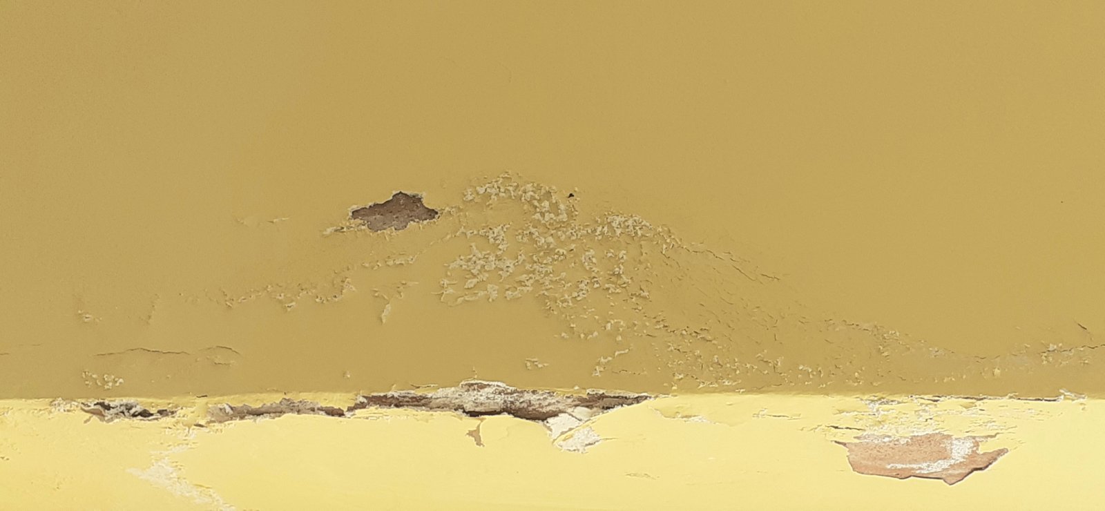

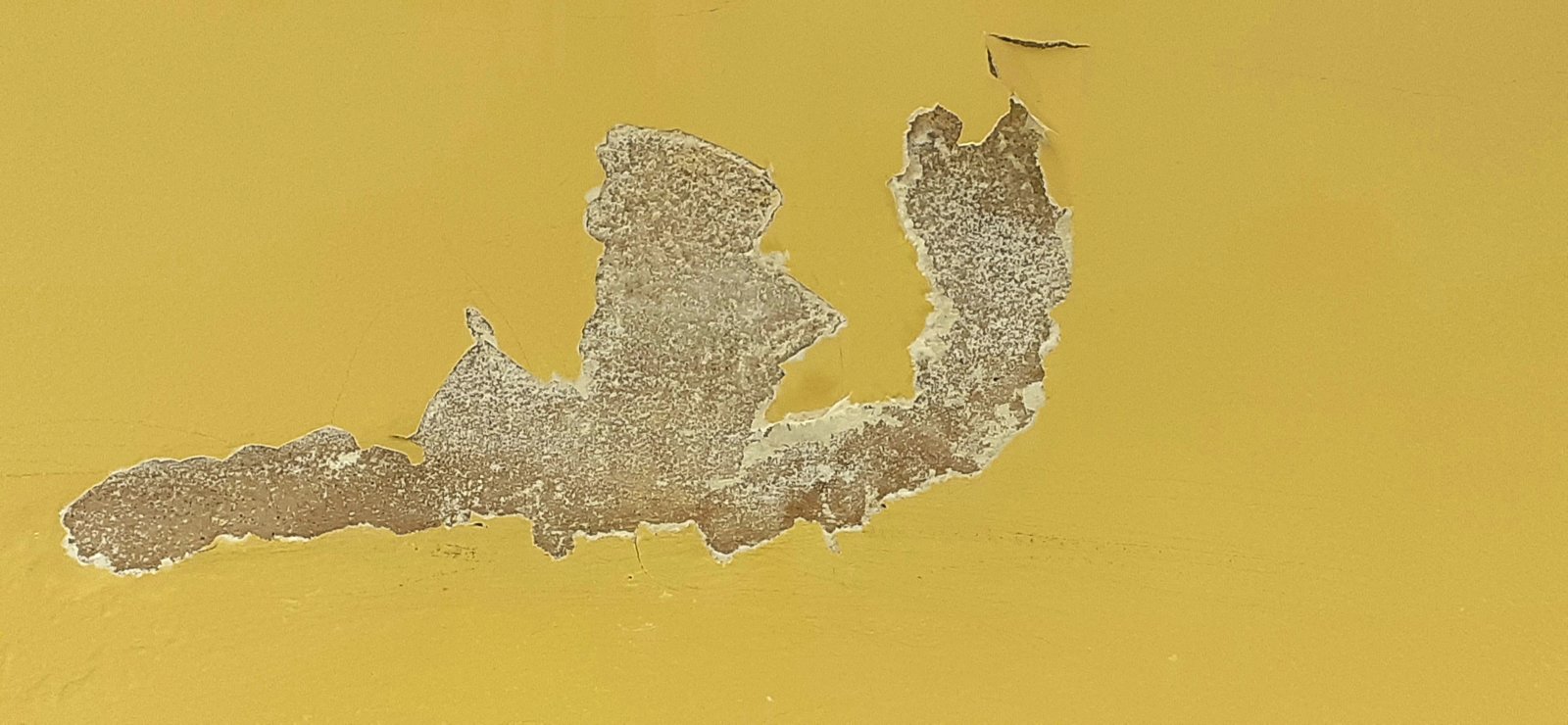

Hello ive just joined so Thankyou for any advice as ive no idea how to tackle this or hold it back for a few months untill i can get it proffesionaly fixed
so.
1, No idea what Mold it is ?
2, Any treatment
3, Does the plaster need removing

more likely mineral salts crystalising on the surface, probably due to a water leak above. Scrape some off and drop into a small glass of vinegar. Do they fizz?
What is above? Roof, bathroom, pipes?
Which bit is the ceiling?
Its a problem from outside when its terrible rain once suns out i then get more peeling. Its below the over flow pipe from the bathroom and above the kitchen window.
I actually had a small drop of water trickle from the cieling edge vety scary but its dry now theres no rain and baths not making it worse.

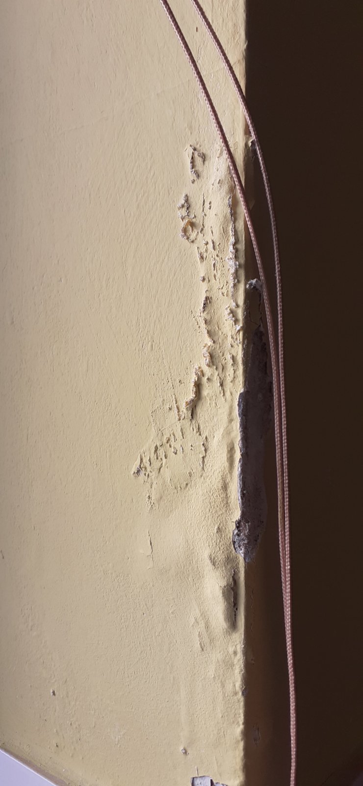

I don't know what that photo is.
Show us the pipes that are (probably) leaking, and what they attach to inside the house.
It is useful to put a hand or coin in your photos to show scale, and indicate which way is up.
The photo is the window side with the blind pully strings , Its not the pipe from the bath flow its used daily and no signs, rain stopped a 5 days ago been no wet plaster since. Ill go up a ladder tomorrow outside to see if any cracks The 2 double glazed windows above are extremely blown with damp insude, not knowning about double glazing im not sure if that doesnt help.
You have penetrating damp.
The window frame might need sealing?
Do you have cavity walls, or render?
Use the search facility to follow threads on "penetrating damp" - many with pics just like yours.
Thankyou ill search up now and I did the drop it in water test but its just like chalk. Hard to gather up like Talcum powder

Its necessary to find the cause of any water/moisture damage before any repairs.
Your plaster is damaged - plus the outside corner usually has a metal angle bead that will be rusting - maybe caused by penetrating damp over a long period.
All damage needs hacking off back to masonry and re-doing, the angle bead will need sawing off & replacing.
If the CWI is indeed bridging the cavity its usually removed.
