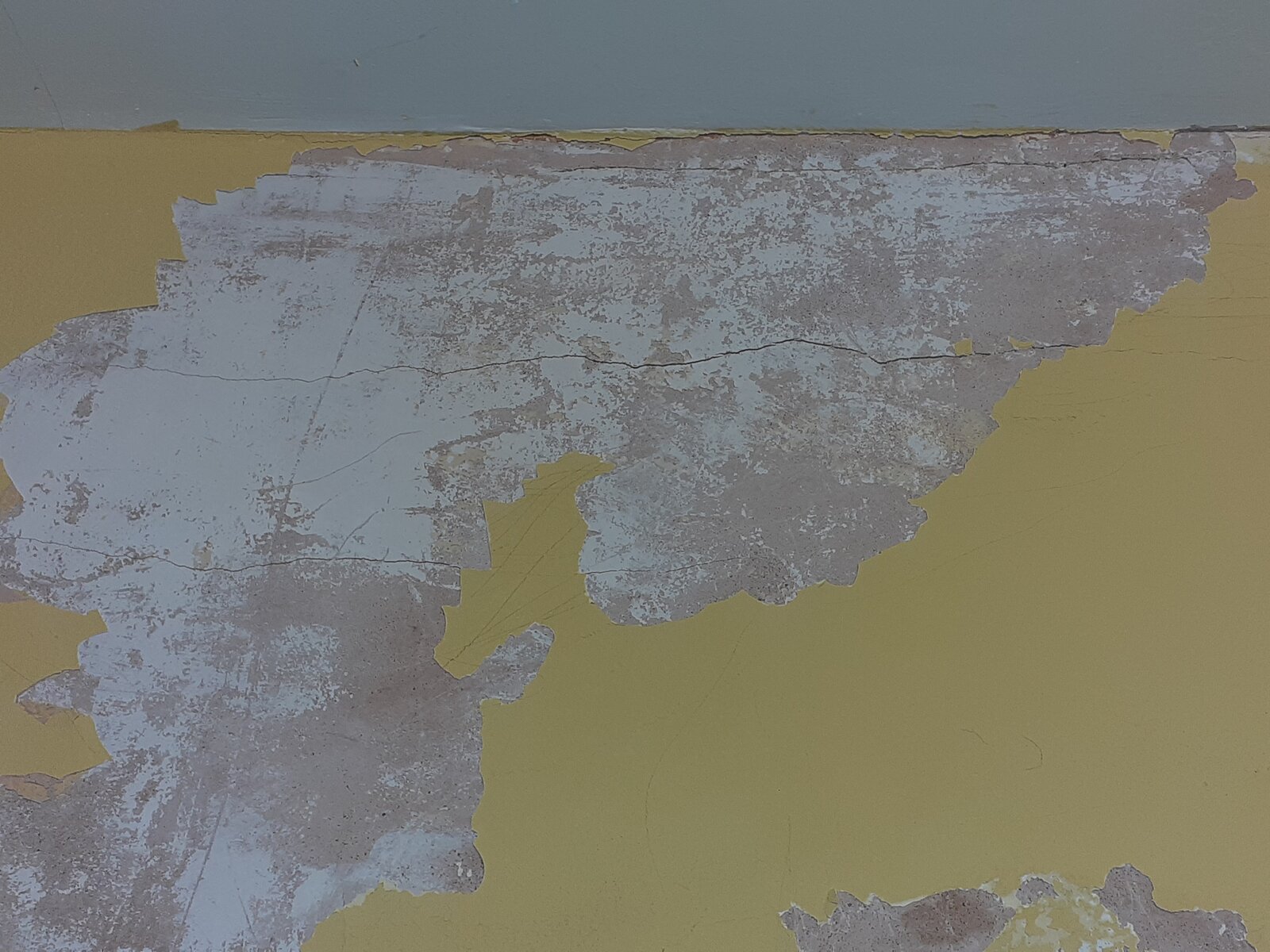

Is this mould on my plaster?

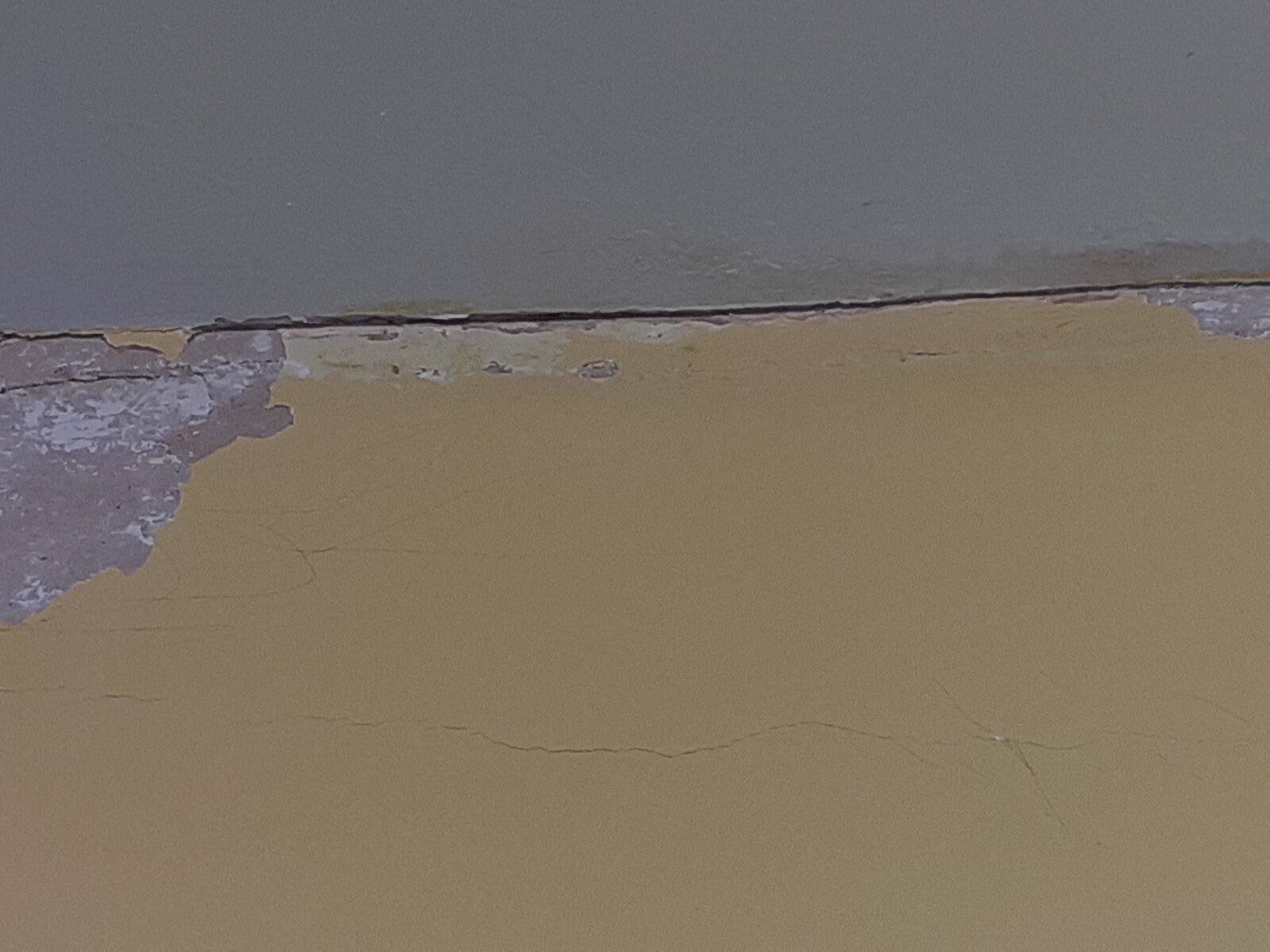

Sorry forgot to add is this Talc a dangerouse mould.
I don’t see any mould in your pictures.
In the second pic, I can probably see salts/minerals that have been carried through the wall by damp.
You obviously want to fix this. But it is not “dangerous mould” as far as I can tell.

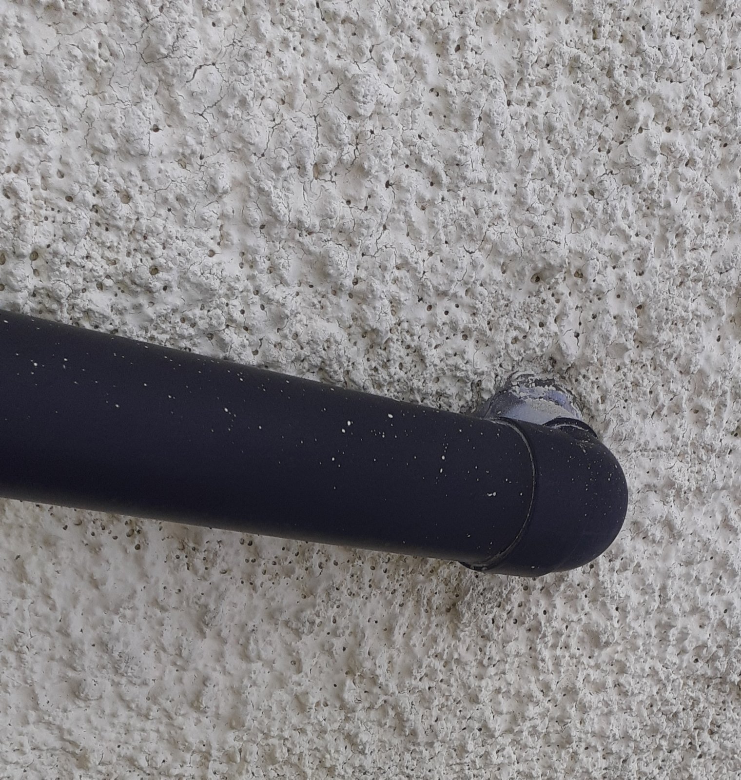

Ok thank you these are the bathroom pipes both seleant looks ok in place lcant reach to check by touch. Ive used the bath lots since this and its still dry. Im almost sure its rain now, ill have to wait for a bad rain fall again. Nothing i can see outside. I did reach out and apply sealant along the top window ledge a few weeks ago just incase

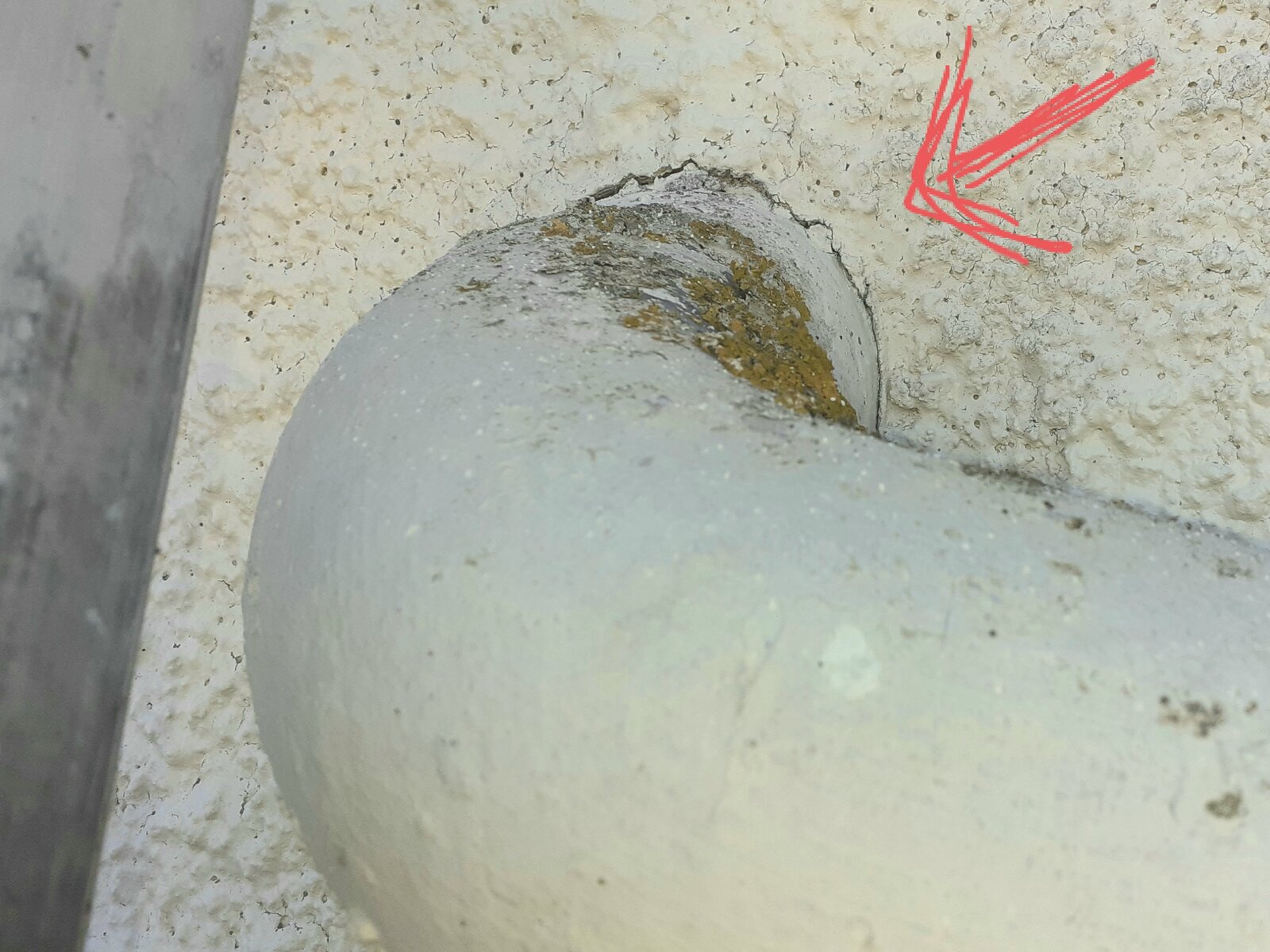

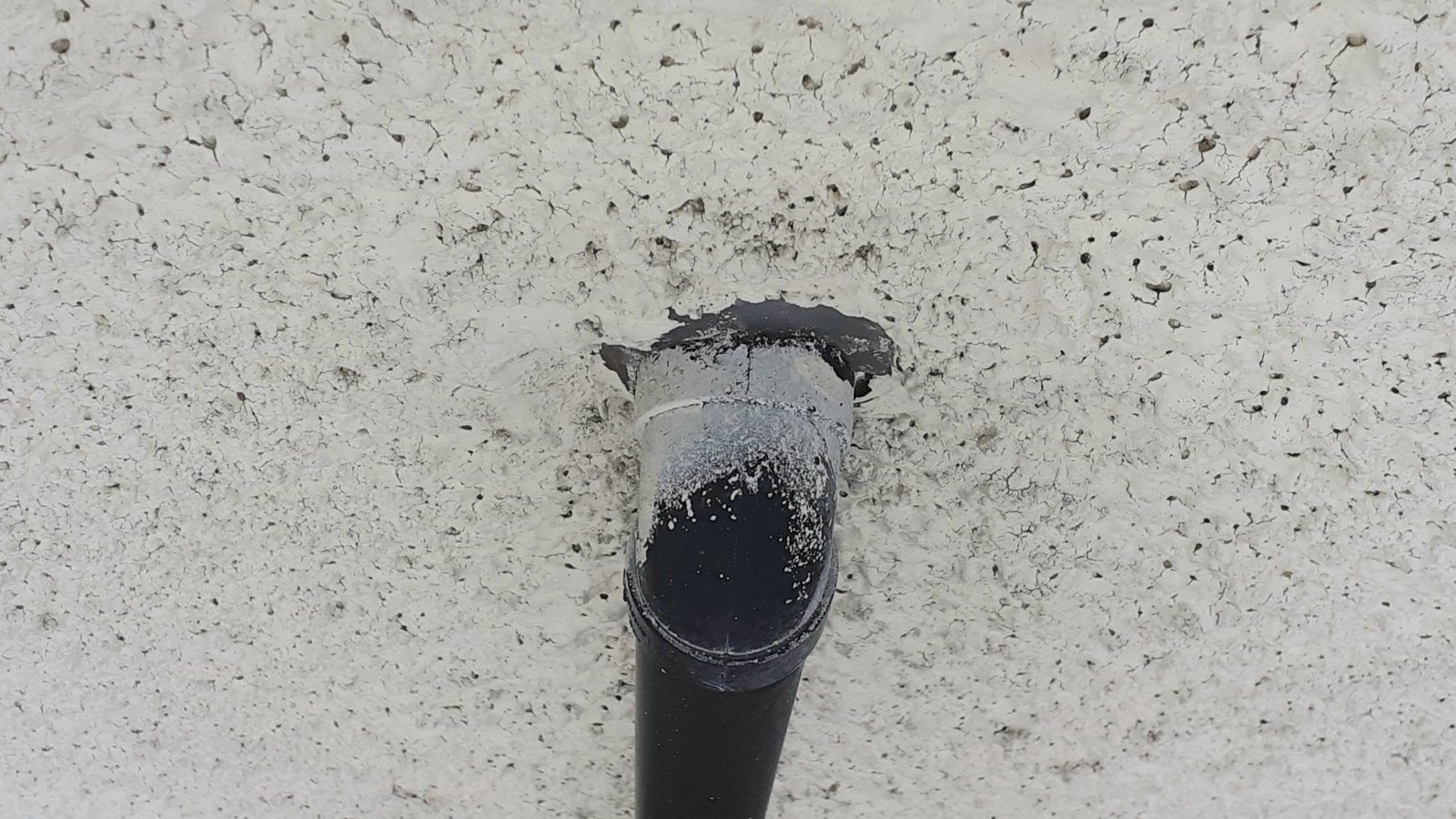

Just painted the full outside wall, and resealed pipes etc.
Found above the soil pipe there was a gap enough to allow a small amount of forced rain in. Lower down the soil stack bolts ( original are the cause of a cracking area) all sealed up now.
I also noted there is 2 old cistern pipe that doesnt exit into the bathroom 1 high cistern and ither sink hieght so ill try to fit an end on the lower obe. I cant reach the higher one hopefully it will stop any rain being pushed in it.
However Since i reached out and filled the upper window sealant gap i havent seen any patches. Theres no crystals back yet either.

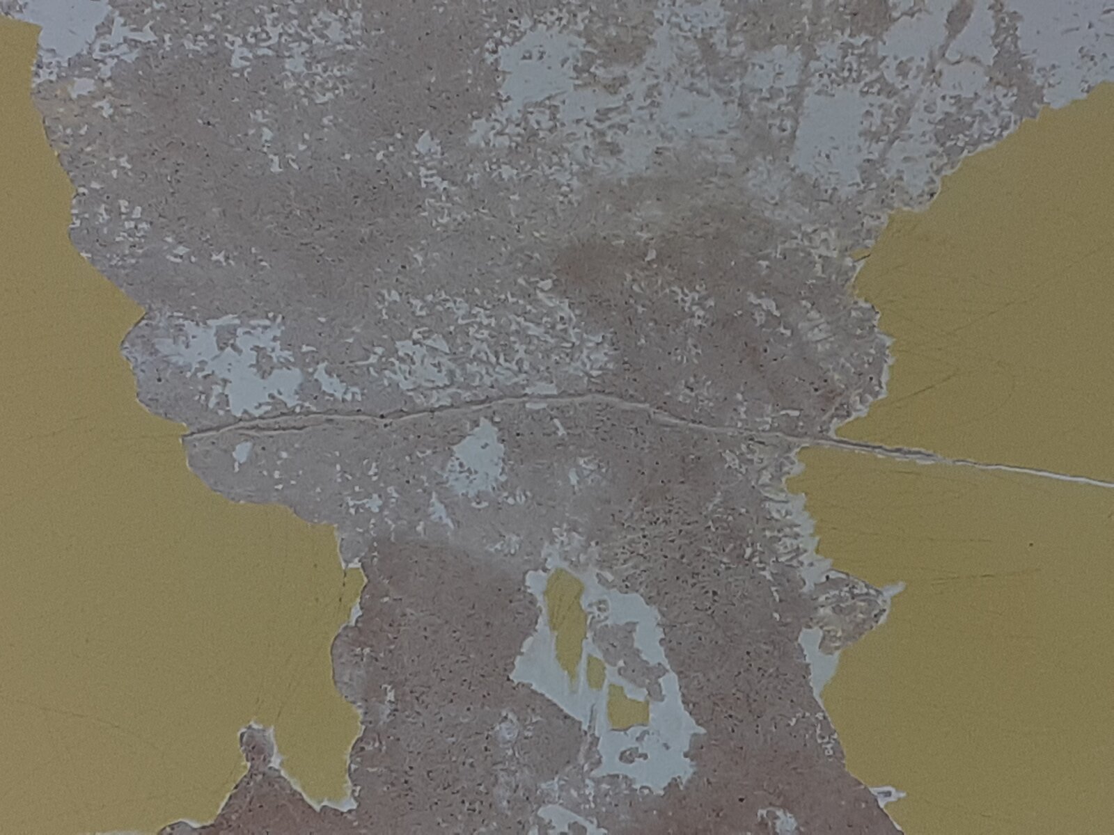

Now ive painted the exterior wall well. It was sprayed over the terylene 10 years ago very thinly and loads of gaps like honeycomb all over. Im filling it all in carefully and taking my time.
Inside im lifting off the top plaster to monitor any more damp before smashing away at it..
Ive hit the plaster its going to be a devil to smash off its very solid.
The skims off in places but thats also stuck fast to.
Im going to dig out the major cracks ive been bodging paint over these for years, to see if they show water. There is a gap from cieling to wall where a drip of water came down through last year. I havent seen it again since.
