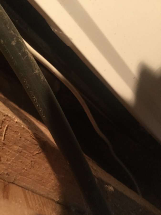

Four weeks after moving into a new house have discovered that the power supply to the shed and a freezer inside, is supplied by an armoured cable connected as a spur to one of the sockets in our downstairs ring circuit. The 3 leads, L, N andE are passed through the wall and are simply connected into the back of one of the sockets. In the shed, the freezer is permanently on and the surge protected sockets work welll enough. Any problems with this layout?
A spur should only have one socket (single or double) on it. So it depends on the number of sockets in the shed. Any lights there?
The armoured cable is fed into a small 'mains' switch with neon indicator and from there into a single power breaker double socket but there is also a 1.5mm cable taken from that to a low voltage single Phillips 11w energy saving bulb via a switch.
That is the 'informative' guidance, but that guidance appears to relate to a situation in which the spur is wired in 2.5mm² cable.
The spur is wired into the 2.5mm ring circuit but I don't know if it is wired in 2.5mm² cable!
Well that is wrong then as your spur which is no more than 2.5 mm cable (could even be 1.5mm) is feeding both a socket and a light.
Also that light is straight off a socket circuit probably protected at 32 amps. It should be fed via a switched fcu with a 3 or 5 amp fuse.

On the TLC site, 1.5mm² 2-core SWA cable is described as having a Nominal O.D of 12.4mm. So let's hope it's fused at the house end!!
OP / @Motivated1 have a closer look at the cable sheath. The cable size is usually embossed on it, every half meter of so.
