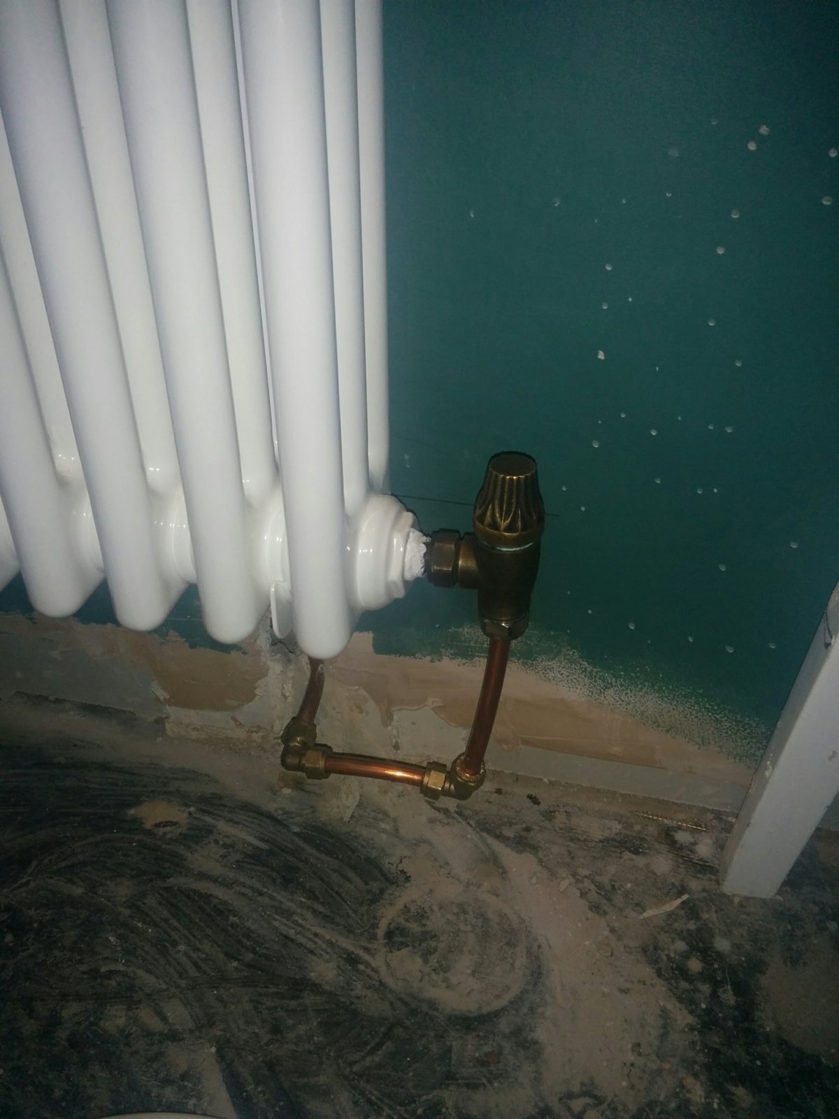

Hi,
We've recently had a radiator fitted and the pipes look a little strangely done!
Is this normal or should we get them fixed? (The floors are concrete so they can't run down)
Thanks!

It will work well enough, but for sure it aint very pretty!
Assuming that the pipe that exits the wall cant be moved at all, it could have been cut nearer the wall and then the copper pipe formed so as to lose that second elbow.....it wouldnt be so obtrusive that way. The pipe looks like 10mm stuff?

The pipes seem 10mm I think? Is that too small? The radiator is only actually getting luke warm so might this be the reason why?

It'll work but it looks terrible, doesn't look plumb, not sure why they've used compression fittings (probably can't solder).
Strikes me as a chancers work.
A friend of mine who's done a lot of cast iron rads told me a while back it's usually 13 mm (rarely 22mm) then changed over to BSP sizes, as they're often refurbished and of course, still in imperial.
They will take slighlty longer to get up to temp compared to a modern convector radiator but they should end up as hot.

Will this poor pipework be what's affecting the function of the radiator or is that something else that he's not done right? He has told me that it's not working due to a missing pin in the exit valve...which didn't sound right to me!
I doubt it but at the same time, looking at that work, I'd take what he tells you with a pinch of salt.
Its only possible to use solder fittings when the pipes are dry, compression fittings are an easy way out. 10mm pipes should be fine, perhaps the radiator hasnt been bled or maybe there’s some dirt in there.
A missing pin usually refers to a TRV fitted on the other end - it stands for a thermostatic radiator valve that closes down when the room temperature has been reached. A pic could help!

Yes! Those are the exact valves. Apparently the smaller one is missing a pin. We have bled the rad but it is still only lukewarm.
I wasn't too bothered about the push valves initially, it was the really ugly pipework that will look dreadful once we have the skirting board fitted. I don't think we will be letting this guy anywhere near the radiator again!
If that's the case and the other rads in the house are getting much hotter I'd say theres a problem with the valves. Were they new or used? If your fitter has supplied them as new it's down to him to replace them with a working as new set.
