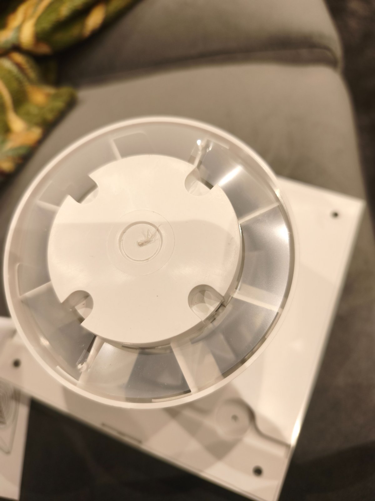

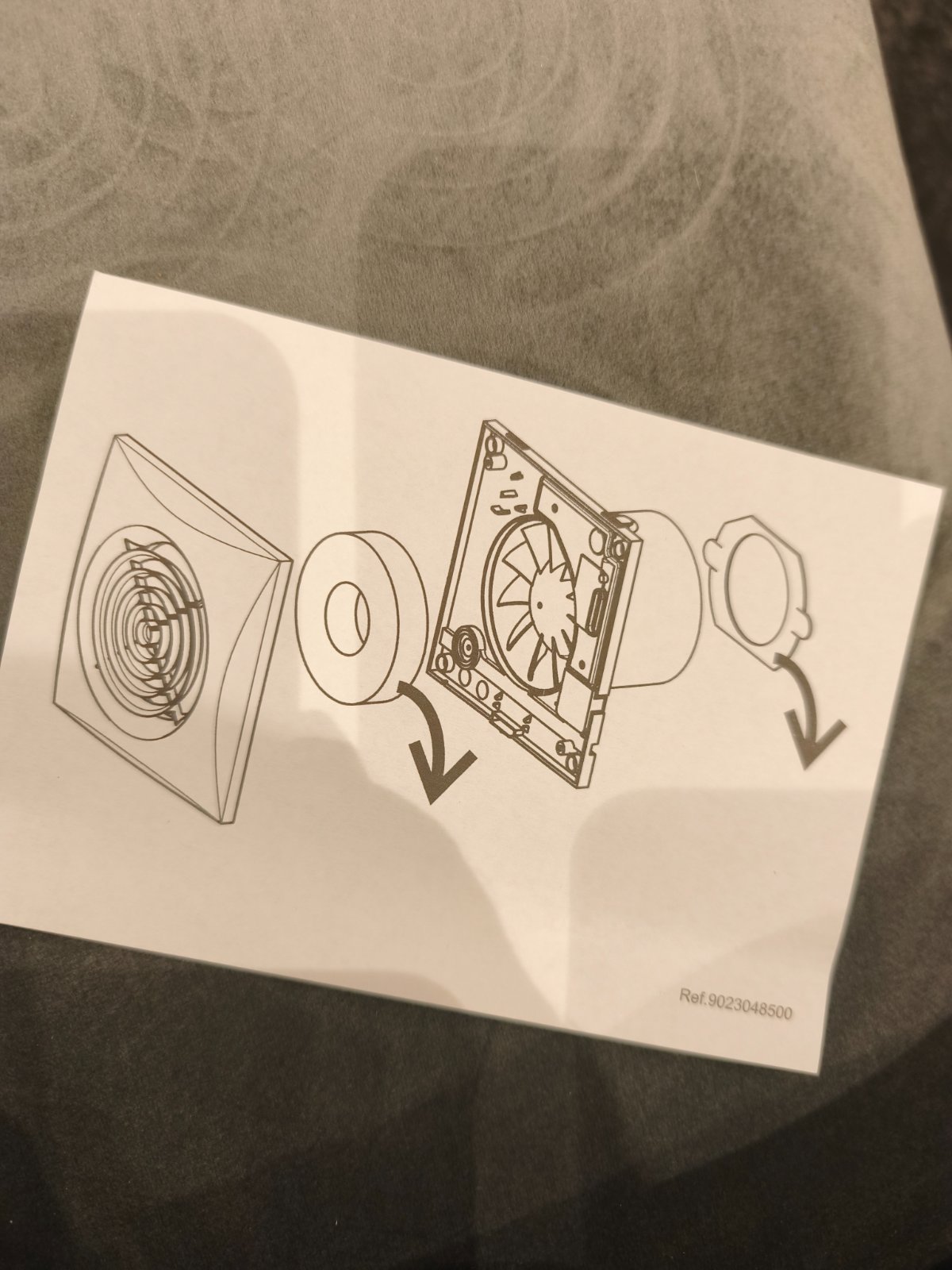

I've just bought an Envirovent Silent 100T fan.
As usual with modern stuff (I'm making myself sound a real old git now), the instructions are absolute pants.
There's a piece of paper implying that you throw away two items attached to the fan (a cardboard insert at the back and a foam spacer under the grille, but there is nothing showing you (or telling you in the instructions) what the very thin transparent disc of plastic is at the back of the fan. It appears to be deliberately (but at the same time quite flimsily) attached to two plastic nipples.
So is it some kind of shutter?
If so, I can't quite believe that things are getting so cheap and nasty!

If that disk is not very flimsy, it's just going to obstruct airflow (in both directions), isn't it? Are you sure you weren't meant to throw it out as well as the cardboard?

I think I'll get rid. It does seem ridiculously insubstantial.
It works.
Mine is not clogged or broken.
It moves like a butterfly's wings
In response to air movement.
Fair enough - but to what extent do you think it impairs air flow in the desired direction?
I agree with @JohnD
Mine works well. No back draught (even when the outside vents are rattling in a breeze) and it sucks the damp air out well (and quietly). So minimal flow obstruction, if it's even measurable.
I do need to give the fan blades and housing a clean up wipe / vac to remove the dust / talc powder build up though; that'll likely impair performance more than the 'flaps'.
