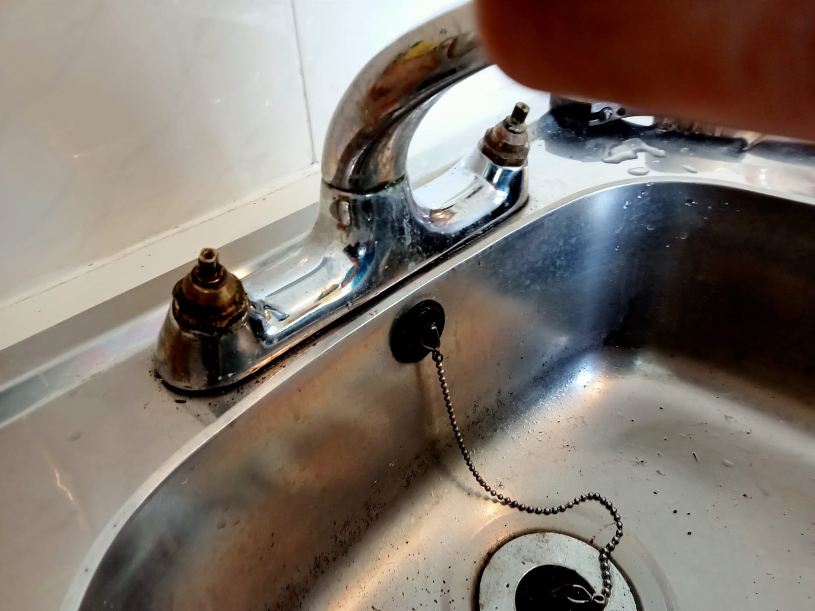

Is this tap repairable
16 Jul 2009
1,155
15
Hull
Do you think the bodys will remove from this tap to rewasher?
Dont fart around trying new tops because the inner seating could be worn. Save yourself time and frustration and opt for a new mixer of some description. Here you are, a new garanteed deck mixer for forty quid
I’m very much a believer is repairing rather than replacing if possible. Too much thrown away these days for the want of a little work and some new parts.
Then what will the OP do with his new tops when he finds the original seatings are the major problem? I doubt if he/she will know how to reseat the deck block even if they had a monument seating cutter.
@Fallout is a tradesman, so all he needs to do is add a seat cutting tool to his tool bag. That being said, in all my years of doing this I’ve only ever had to cut the seats on a deck mixer twice and then that was just because they were pitted not that they actually really needed it. I’ve found a valve reviver kit works 99% of the time and takes all of 5 minutes to do.
