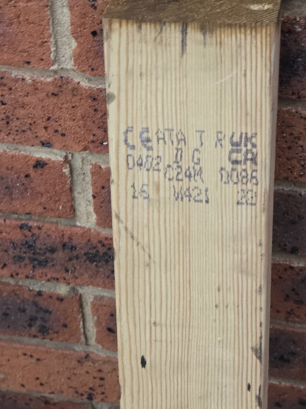

Is this timber pressure treated?

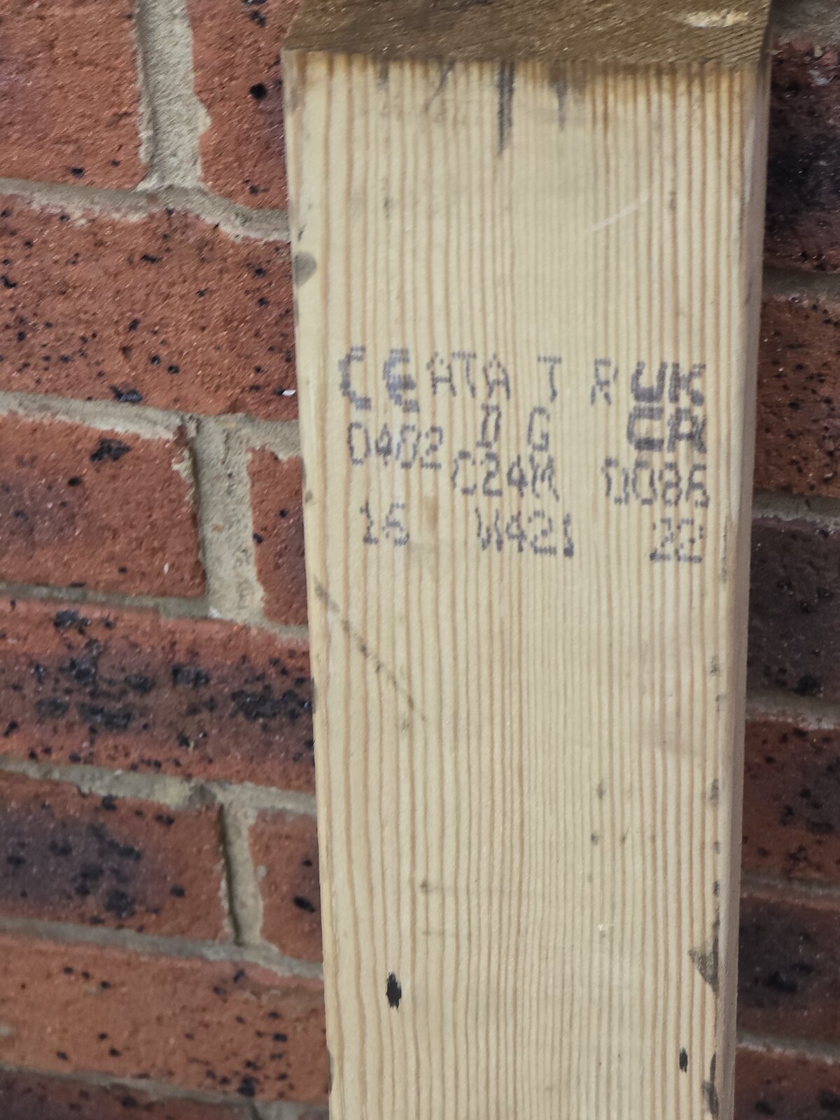

Hi, my builder has used this timber for the floating deck frame that sits on paving stones (no prolonged ground contact). However I couldn't see any treatment markings and I'm having doubts now.
Can anyone advise please?
You have a C24 stamp so I read this is treated.
Look it up.
Id put a clear primer preserver on it next summer if you want extra protection
C24 timber is not typically treated. C24 is ordinarily used for structural work like joists etc, so no need to be treated normally. It doesn't look treated to me.

In my case it sits under hardwood deck boards that have 5mm gap, so very little exposure to the joists and absolutely no contact with the ground or organic material as the joists sit on pavers that were then covered with plastic membrane to sit between the joist and paver. I'm wondering though if the joists are not tanalised timber, whether I should take the boards off in the summer and coat the subframe with bitumen paint as I really want the deck to last for the next 20yrs and beyond.

Thanks, in my case I'm only referring to the joists as they seem to be untreated. The boards are bangkirai which has excellent wet and rot resistance capabilities
