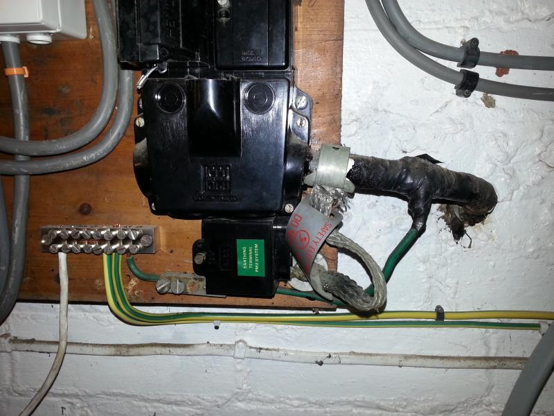

is this TN-S or PME?

The green, sweated cable connects to the MET. The braid, connected immediately to the RHS of the cut out goes to the Henley - there is no other connection within the Henley. The Henley has a label which states PME - I doubt that tbus is correct - what do you think?
Regards
Cannot understand why somebody would go to the trouble of connecting the (later) braid to an unused Henley and label it as PME?I mean , the braid isn't even connected to the neutral - who would do such a thing and to what purpose?
Regards
Although it looks like TN-S the definitions mean if some where between the transformer and the consumer the neutral and earth share the same conductor then it's classed as TN-C-S the point where it separates does not have to be in the consumers premises.
Hence why it's down to the DNO to tell you what it is.
What if that point is a mile from the consumer and a foot from the transformer?
As we've discussed before, AFAIAA it would still technically be TN-C-S - although I'm not at all sure that it would be appropriate, helpful or reasonable to regard it as such! Having said that, I suppose that a break in that one foot of CNE would result in the same sort of 'lost neutral' issues as people fear with TN-C-S supplies (potentially worse, due to the absence of formal PME).
Kind Regards, John

Looks to me as if the DNO has been asked to PME but only done part of the job - cannot think why anbody would bother to fit braid with a clamp to the incomer and then terminate in an otherwise, unused Henley. Will have to ask supplier what they say it is - will update in six weeks or so.
