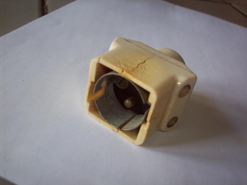

I was brought up with lots of these:
(in case it's not clear, there is a bayonet plug on the opposite side from the bayonet socket, and one 2-pin outlet on each side). As you can see, this one has been overheated to the point of developing multiple cracks.
It was a particularly 'cunning' design, since if you plugged things into one or both of the two pin sockets, and also plugged in a bulb, it was guaranteed that the flex(es) would lie against the hot bulb!
