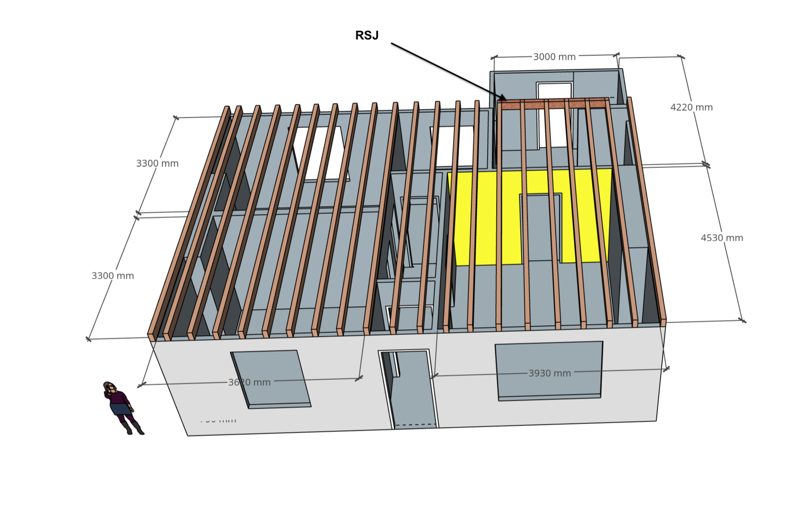

Hi All.
I know what you are going to say, go and get the opinion of a professional struct eng.
But this is a DIY forum so let's forget about the professionals for a moment.

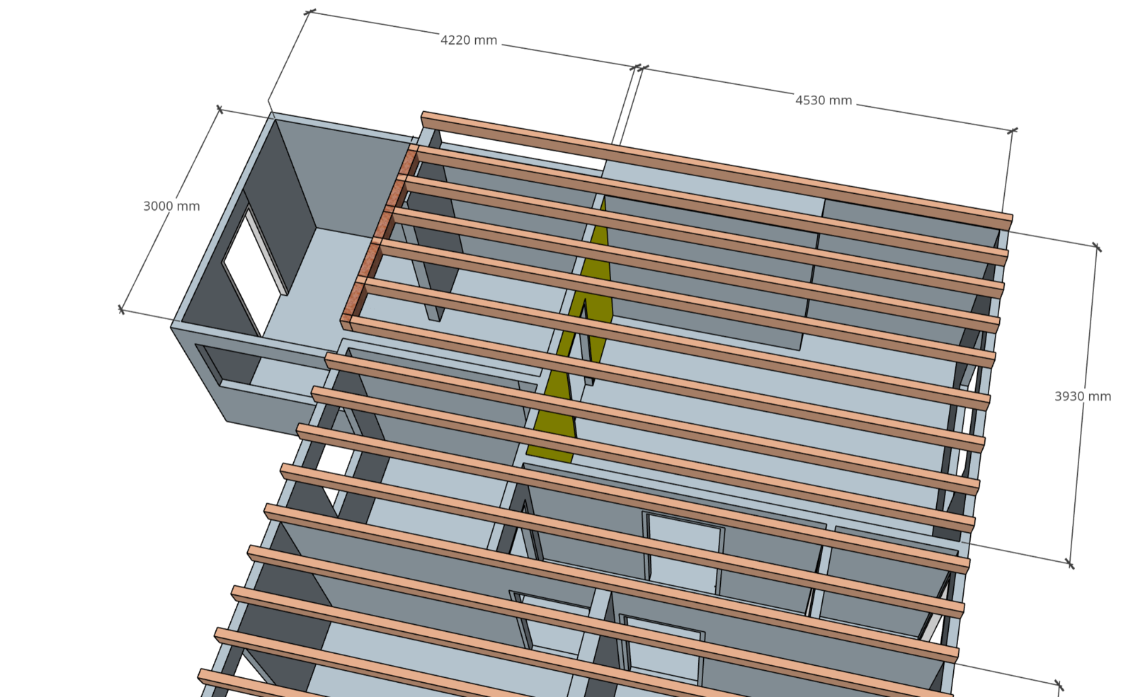

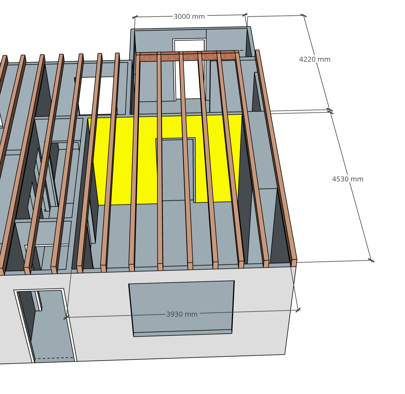

Trying to determine is the wall shaded yellow is structural?
Some background.
Bungalow, no second floor, so the yellow wall finishes where it meets the roof joists. No wall above.
Brick built in the 1930's.
The main roof joists span the whole width of the building, there are no joints, overlaps, sistering etc.
Where the joists meet the yellow wall they appear to rest on the wall.
The RSJ is not floating at one end, its just the way i drew it. (new to sketch up)
I had an architectural designer look at the wall and he could not determine if it was structural (i realize it is not his job to do so).
Basically I am trying to determine if I need to apply for a building warrant to take down the wall and if i need to add in a beam to support the load of the joists.
Based in Scotland if that makes any difference.
Would appreciate your thoughts.
Thanks.

If the ceiling joists are small (3" - 4"?) it is likely that the wall may be providing some support.
in the loft, there may be sticks supporting some of the joists, nailed to the ridge or some other main timber. If you nailed similar support sticks to the ceiling joists where they cross overthe wall, that should be OK to stop the ceiling deflecting.
Personally, I wouldn't class it as a structural alteration, but then I'm not your building inspector.....
The joists are at least 6 inches deep by 2 inches wide.
Yes there are struts in the loft that support the joists. I hadn't thought about those come to think of it, so thank you. I'll check on the location of the existing struts and see what point they attach.
They're not so much struts as hangers - the ceiling joists are suspended by them.
