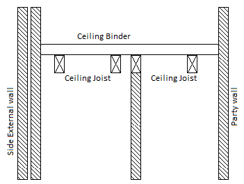

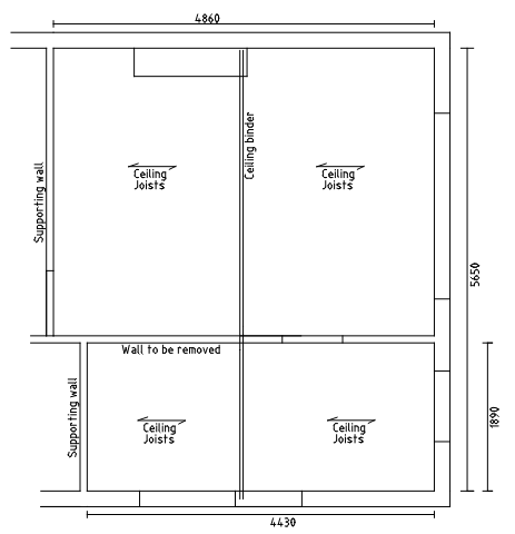

I have an internal brick wall that I want to knock down in my bungalow. The ceiling joists run parallel to the wall in question, but one appears to run along the top of the wall. There is a ceiling binder than runs perpendicular to the joists/wall, and it seems like this binder gets it's support from the wall (in addition to the hanging from the rafters). Here is an example of what appeared to be going off when I looked in the loft space.
Suspecting the wall may have been structural I employed a local structural engineer to take a look and he came to the same conclusion, so he calculated a steel beam for me.

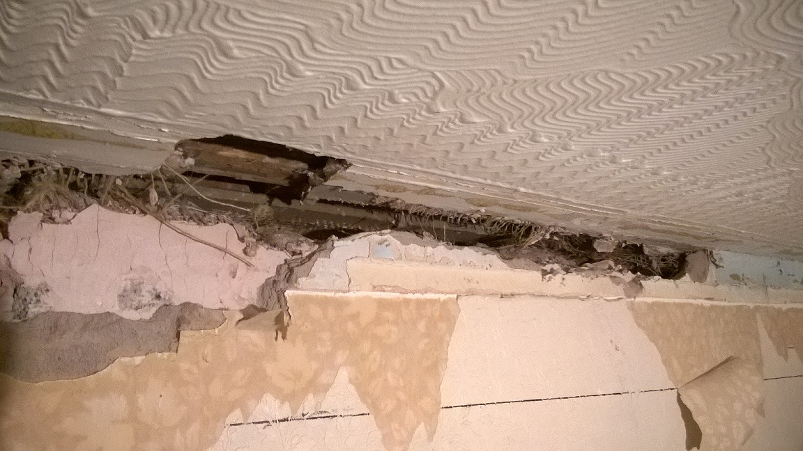

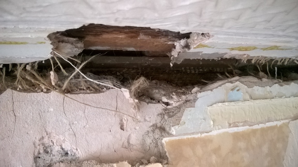

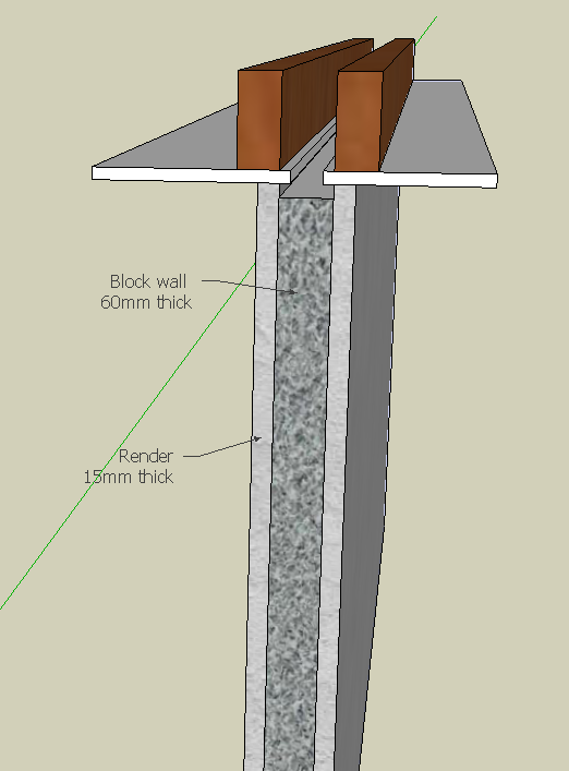

Today I started to work on taking the wall down and chipping away at the render/plaster along the top where the beam will go. I didn't get far when I discovered that the ceiling joist we thought sat on top of the wall actually doesn't. The wall itself finishes 30-40mm below the joists in some places and the joists (there are two) aren't even directly above the wall, thy are offset. They 'float' above the wall on either side of it with the plasterboard ceiling hanging from them, and the gap between the ceiling and the top of the wall is just filled with render. Thus, the wall doesn't appear to be offering any kind of structural support to the joists or binder.
Here is a quick sketchup drawing of what is actually going off.

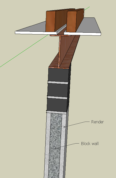

As you can see, the joists don't sit on the wall but actually sit on the render (with plasterboard sandwiched between). My question is, what do I do now? I have already purchased the steel and notified BC, and if I was to continue as planned and use the steel, then the joists either side of the wall would be half on/half off the steel (see example below). I don't know if that is likely to be passed by BC as I would have expected the joist to have to sit wholly on the steel.

In the last picture there, the top of the wall is level(ish) with the top of the chipped render. I haven't broken any of the wall away there, I just tapped at the render and it fell away exposing the void behind it.
