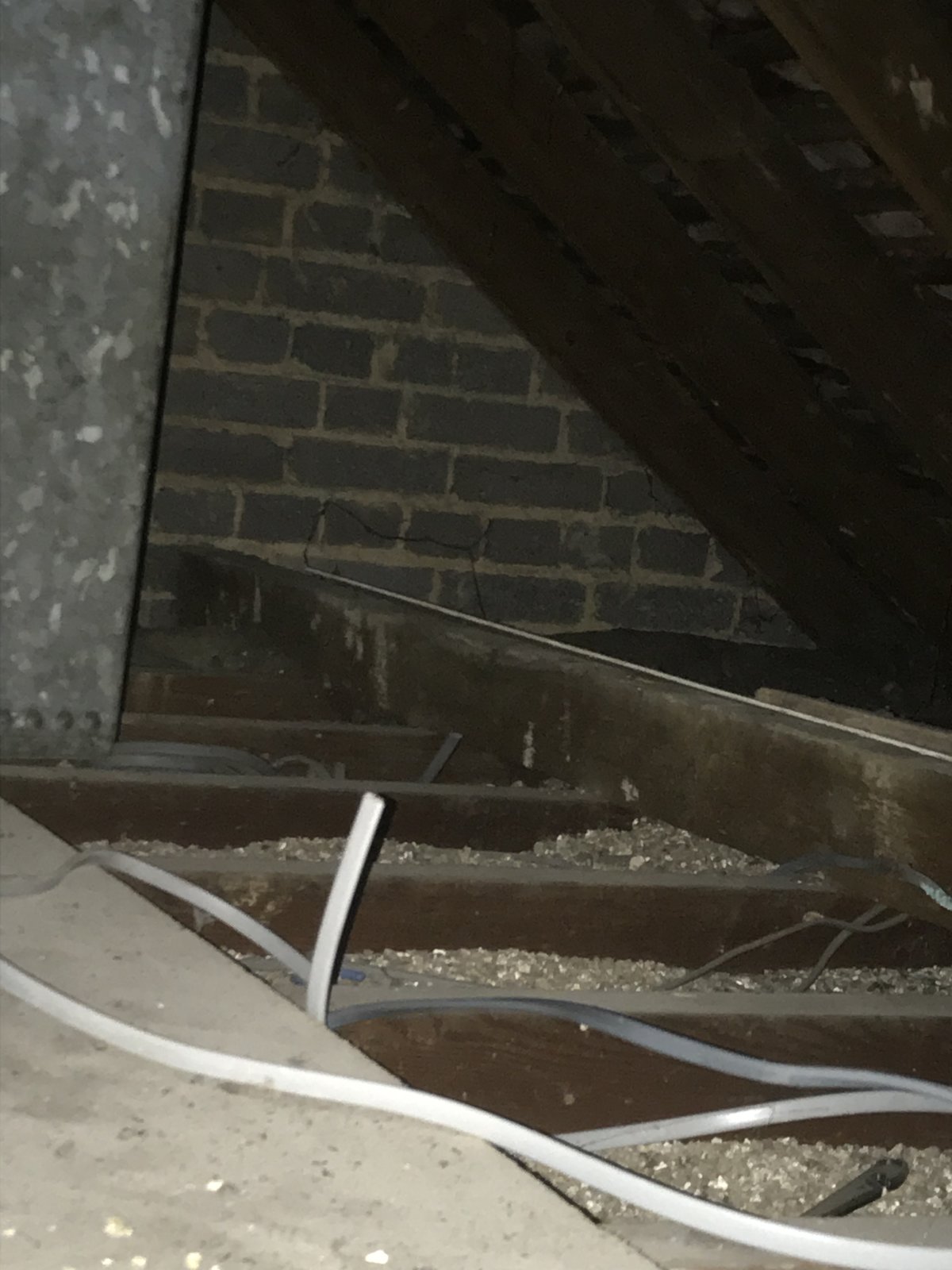

Hi Everyone

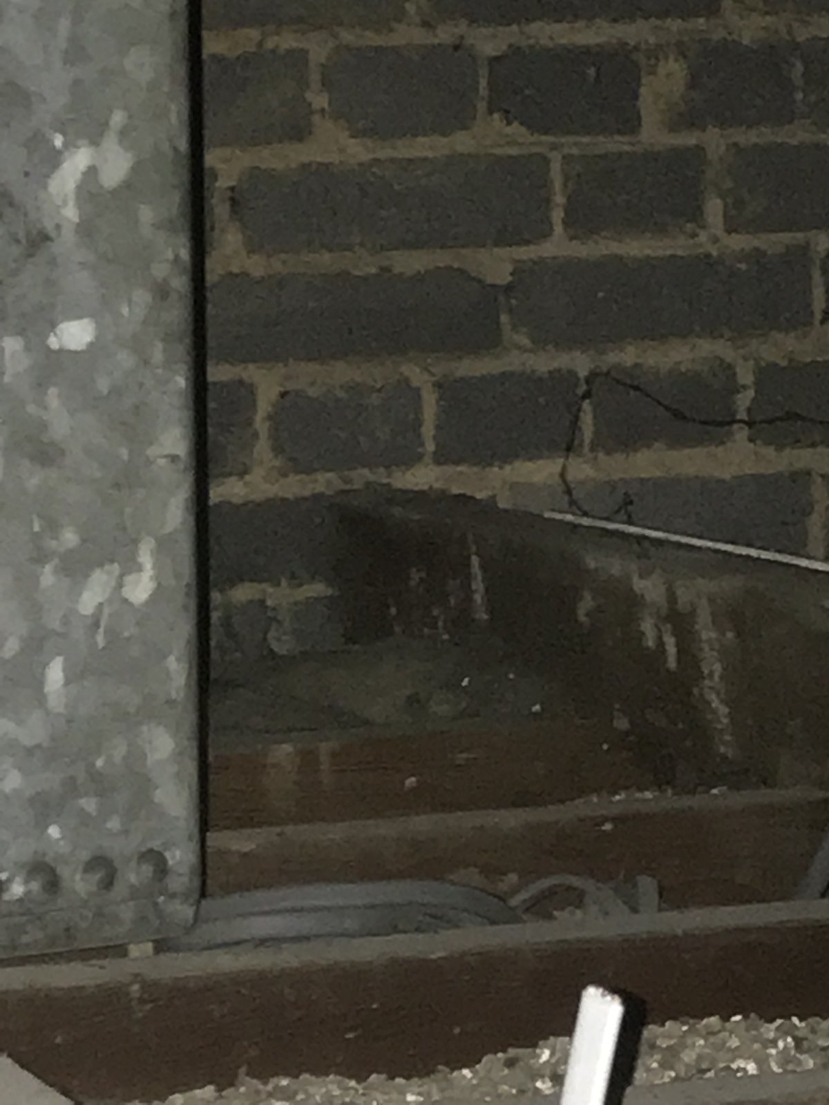

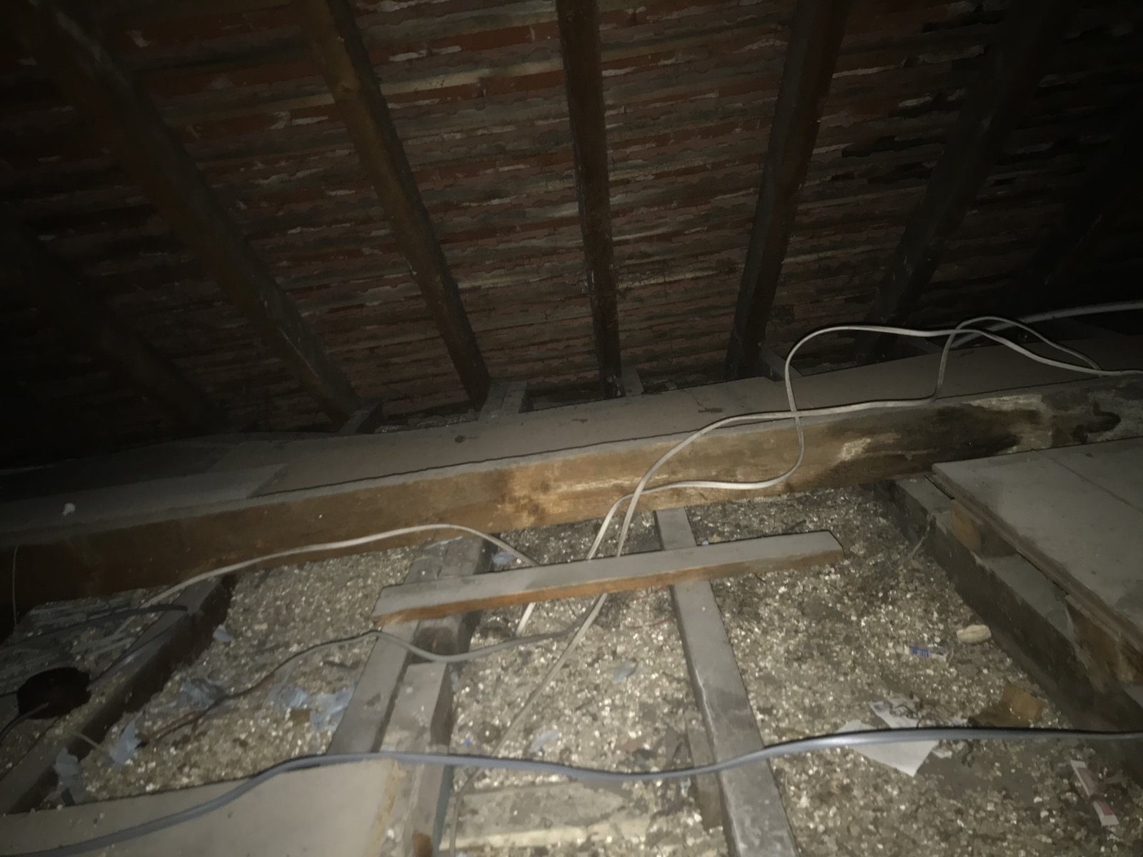

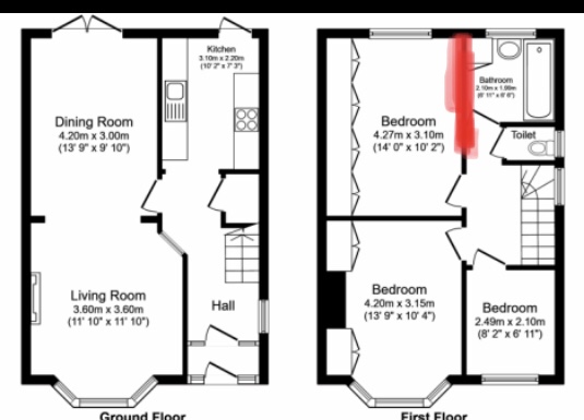

I would like to remove a wall on the first floor. The house is a typical 1930s terraced house. Attached is the wall in question.
The wall is a brick wall, but I have checked the loft and the joists are parallel to the wall except one joist that sits on it.
However on top of the ceiling joists there is a beam running between the two external walls and is perpendicular to the wall.
What is this beam doing? Is it to limit deflection of the joists? Or is it a hanging beam? How can I know if this wall is supporting this beam?
Please see image below.
Regards

Not sure from the photos but you need a structural engineer's proposals for building regs approval for removing a loadbearing wall or structural alterations.
Yes I’m aware. I want to establish if it is first.
The wall doesn’t support joists and isn’t supporting the struts either.
I just want to establish if the beam in the picture is considered a point load or not.
I can't tell what's what from the photo but that large timber looks a bit manky.

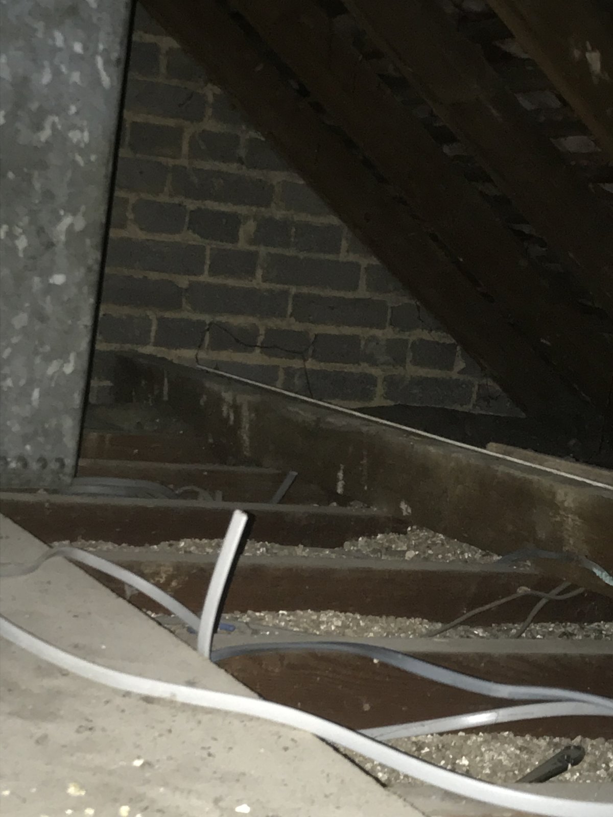

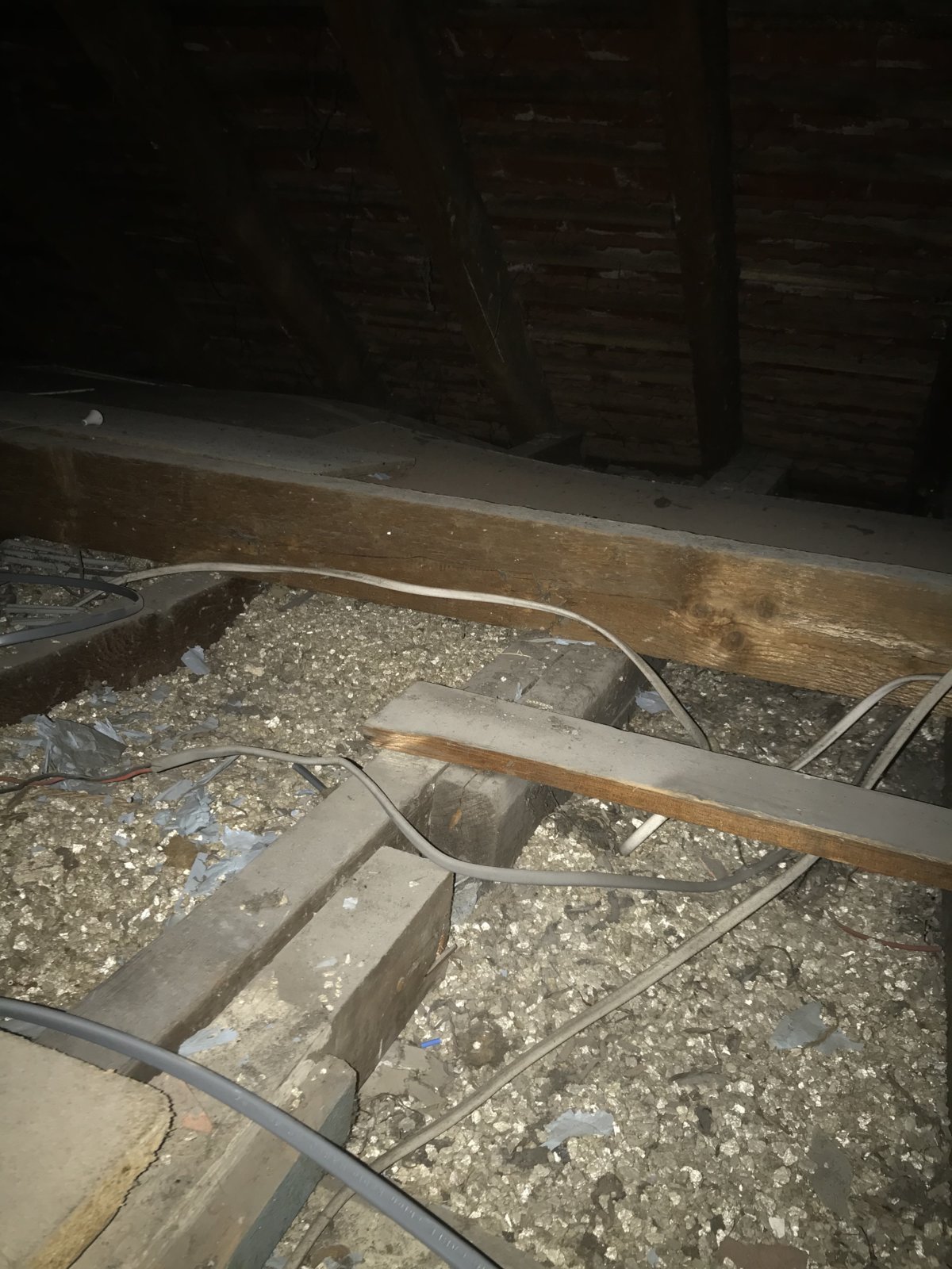

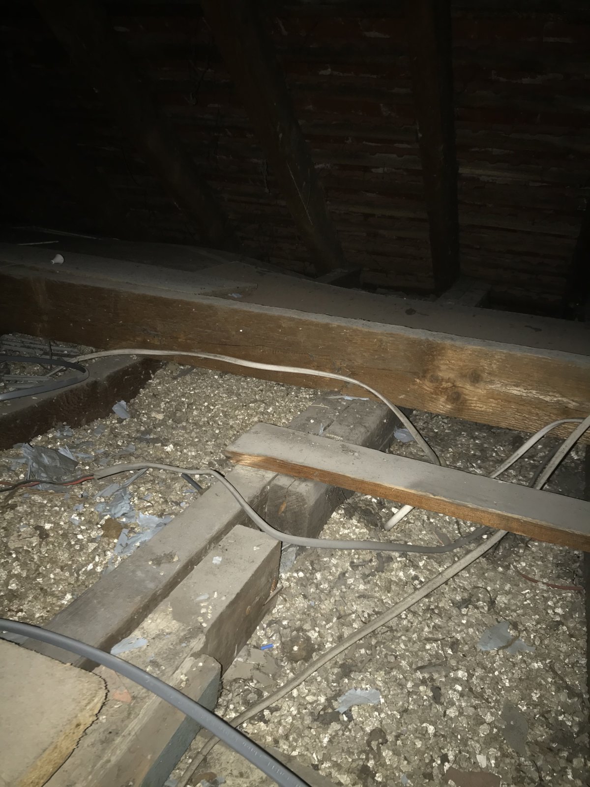

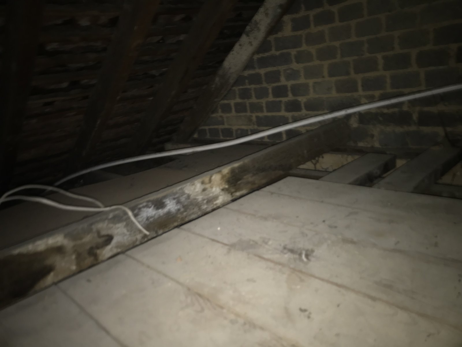

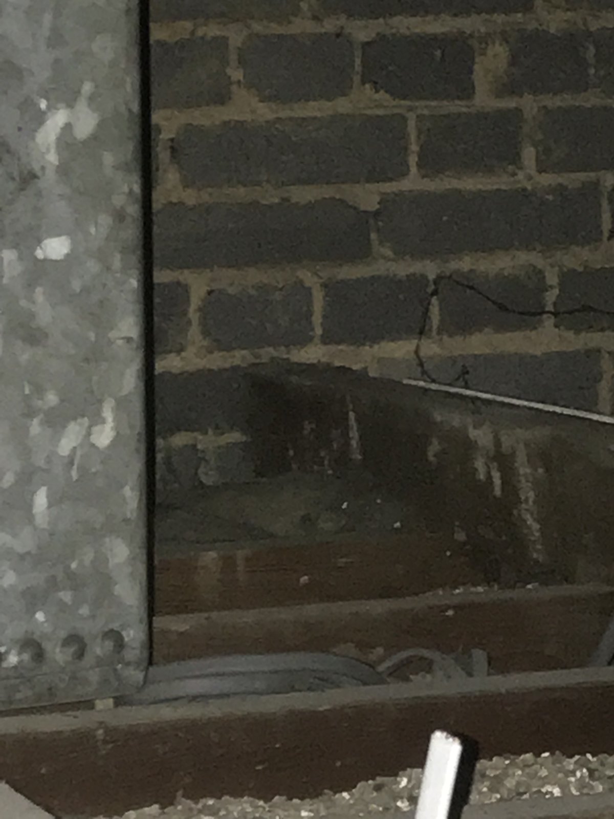

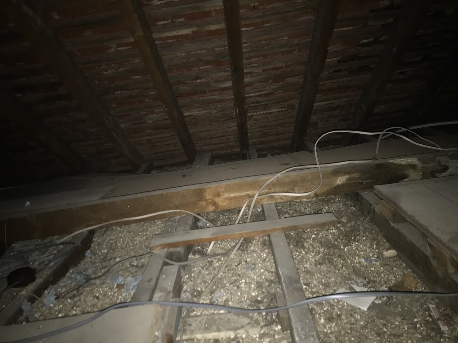

Added some more if you fancy a look.
In The second image, the wall sits underneath the 2 joists.
The timber sits on top of the roof joists.

That beam is a binder, and it suports the ceiling joists.
It wont be loading that wall unless it is actually sitting on it or if those two joists are sitting on the wall.
