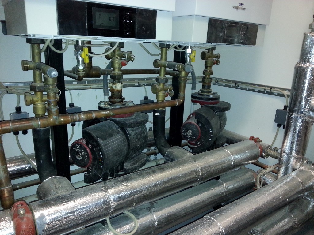

Nah - that's the new 35kW. primaries split just to the right of my head into 2 x 28mm circuits.
These are the 2 leaky 60kW bad boys. Flanges and bellows leaking all over the place.
