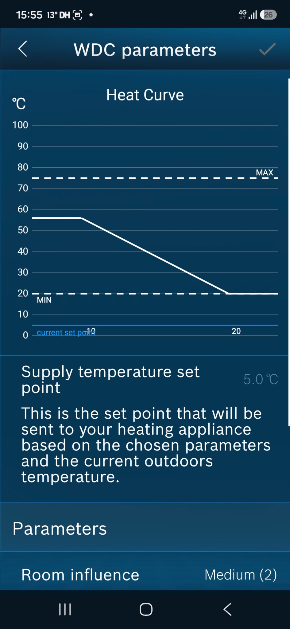

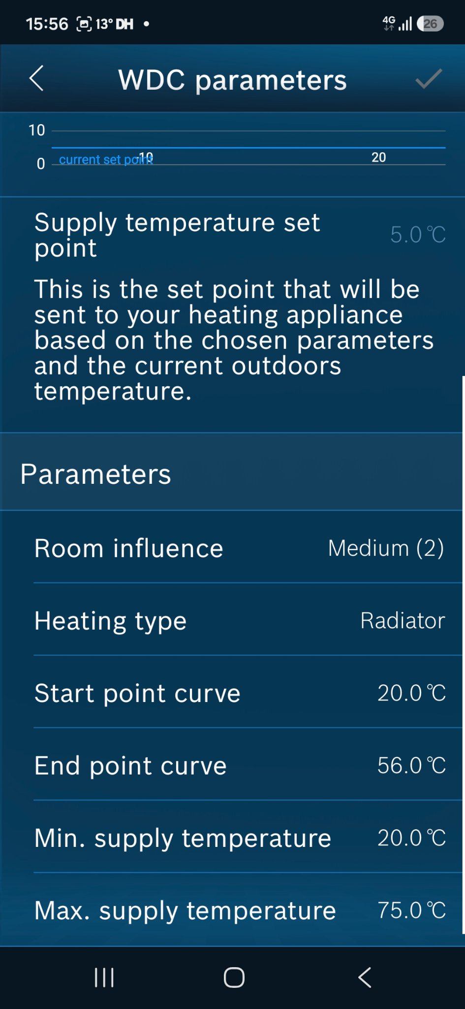

Right, the idea is that it modulates to the lowest possible flow temperature that will be sufficient to reach the temperature you want.
So maybe taking an hour to do the last one degree is "working as intended". Or, maybe you need to slightly adjust the parameters. I have no idea about your boiler, but I imagine there will be a setting you can adjust that affects its relationship between the external temperature and the water temperature. Turn this up a bit.
I have the max set to 56 as the flow temp has to come back lower than 56 or it wont condense

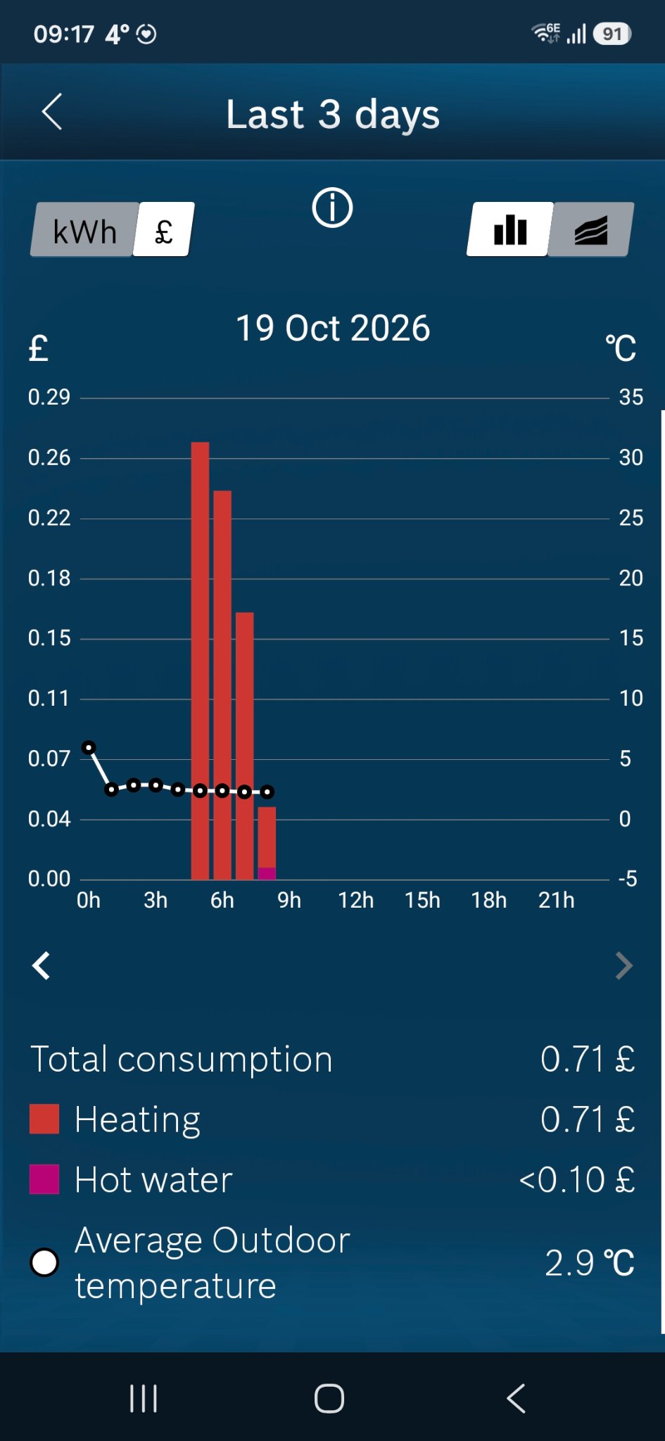

I am not convinced weather dependent is right for me. I have it set to have house to temp for 730am. Its coming on at 5am. I think with off it will come on and at at a hotter temp which yes is a bit harder on the gas but i dont know i just feel at a hotter temp for less time still might save money. I am not penny pinching i just want to run it at optimum leave.
