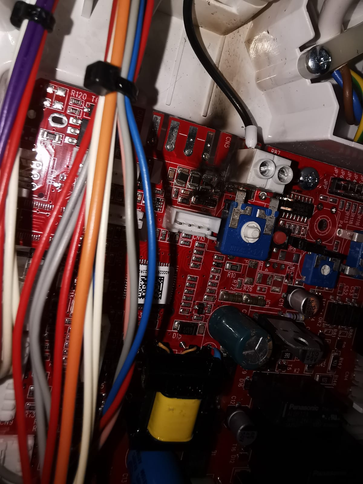

The fuse wasnt blown but there was burn damage on the pcb (see the pic below)

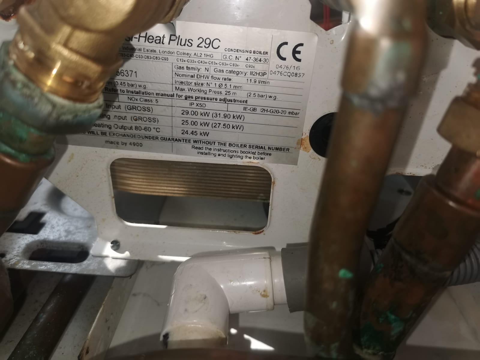

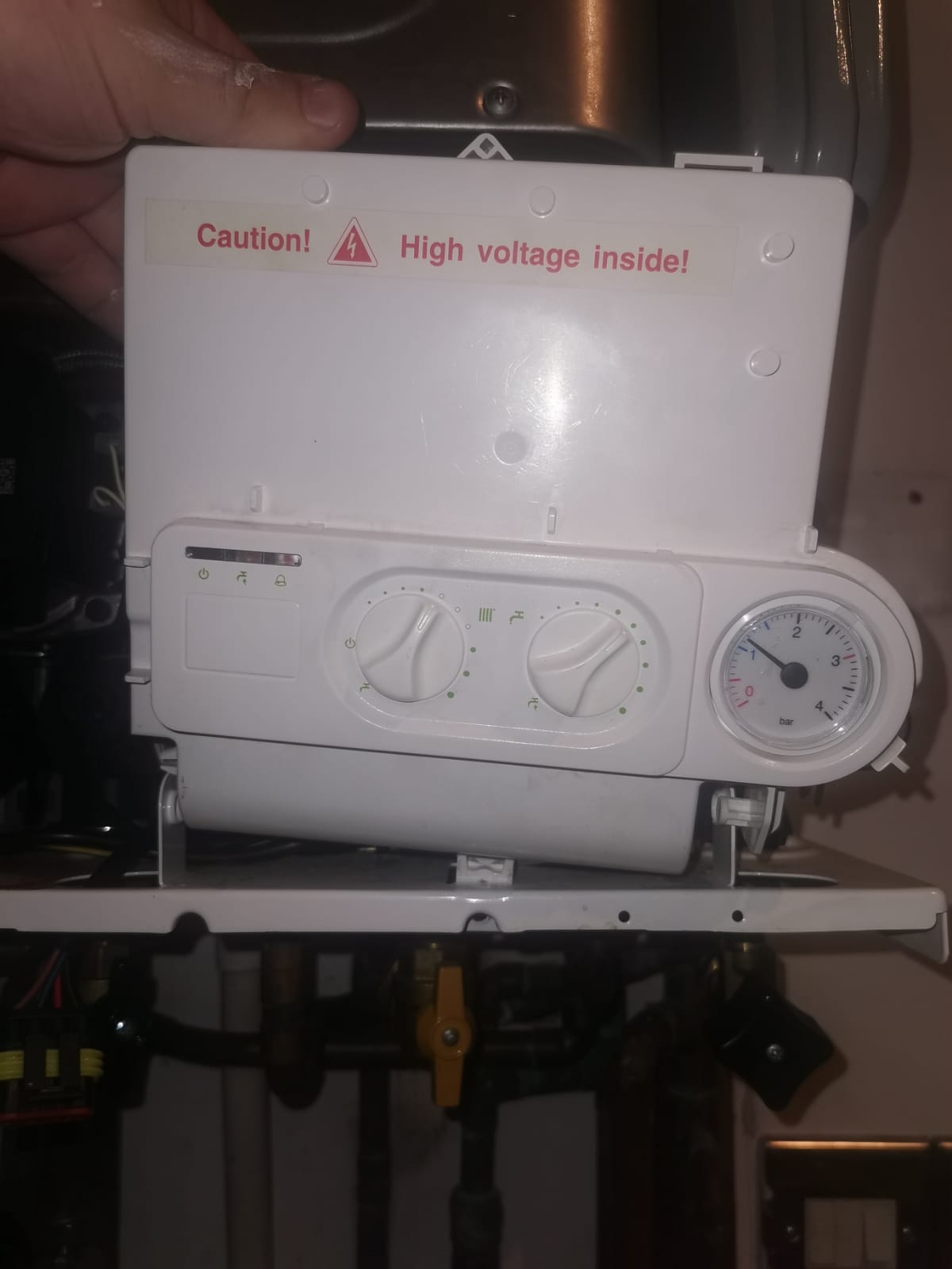

Also what is now really confusing me is that although he has told me its a isar he24 the picture he sent doesnt look like any of the ones that i get from google when i search isar he 24

OH Dear you couldnt have gotten that more wrong, that is a Vokera Easi heat and the thermostat switching on that is indeed 24 v , new PCB time
Ian,
Are you saying that boiler is a vokera - all the paperwork he showed me was for an ideal isar
Oh what a mess
Yes definately a vokera , if he looks at the bottom of the chassis under the drop down electronics panel the data badge should be there
I will bloody kill him !!!
Ian Thanks so much though you have saved me buying another ideal pcb, just have to source a vokera.
What are they like as boilers though?
yes decent boilers, getting a PCB will be easy, if he takes a pic of the data plate I will send you the part number

So attached is the photo of the plate
Realizing that there are 2 pcb types, he phoned up vokera and they said that the part no is 20069541. Sound correct to you.
