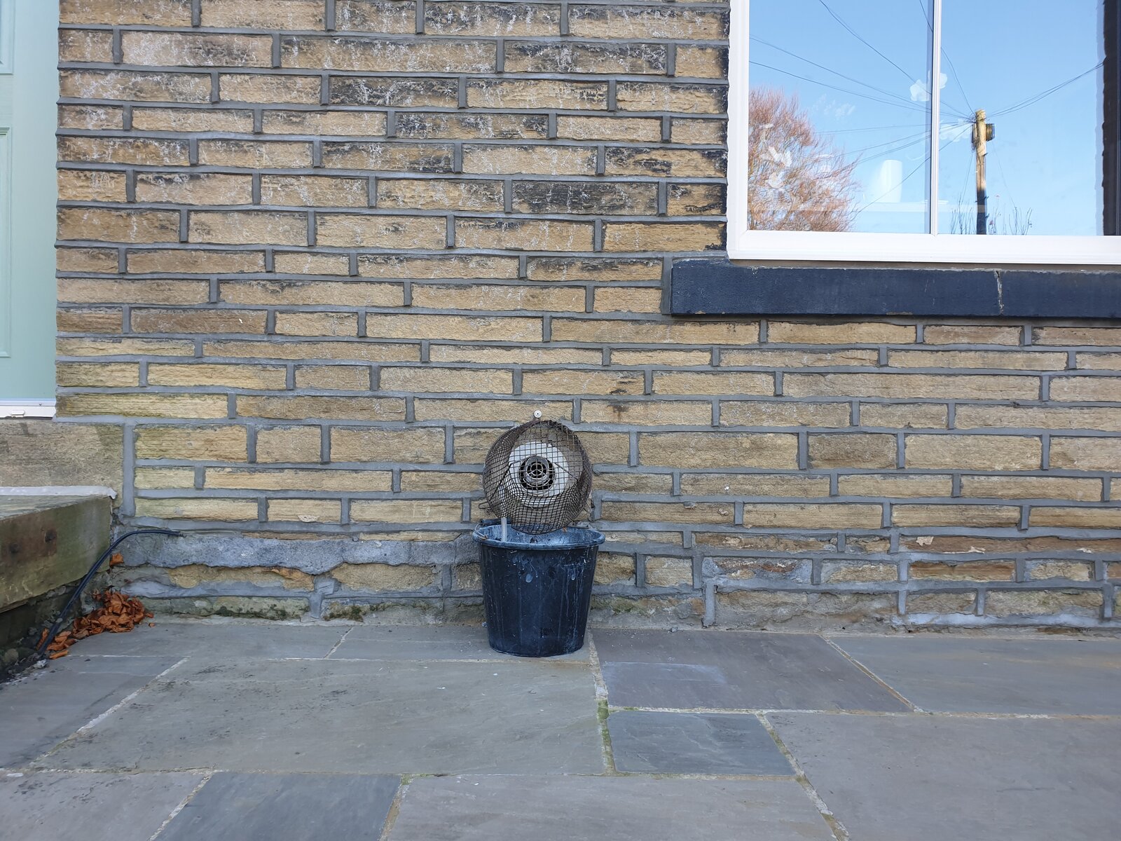

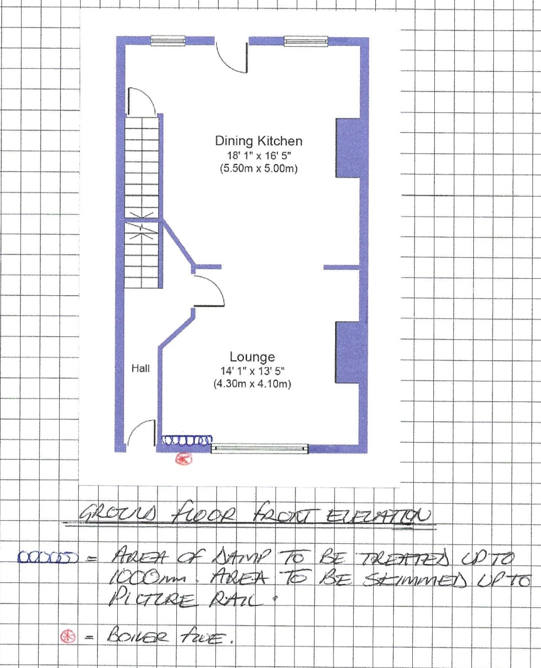

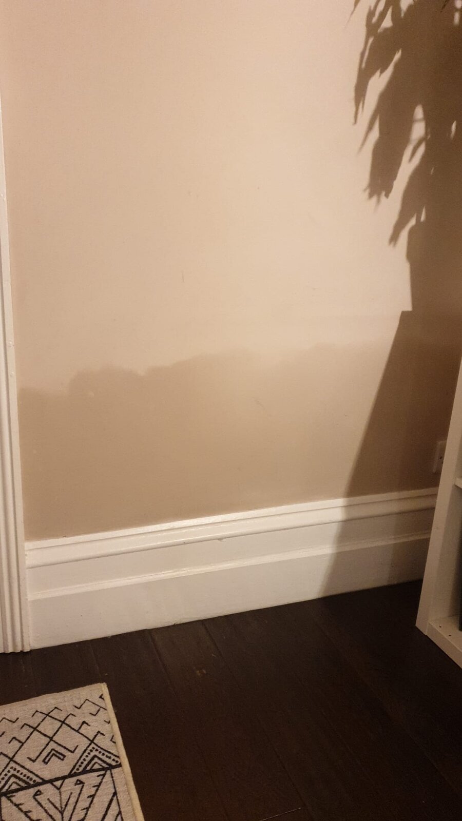

I'm having an internal damp issue on the front internal wall (north facing). See pictures of internal and external. House built in 1875. Yorkshire stone build.
Damp ONLY occurs in winter, coincidentally when turning the heating on twice a day - the tide line and wall up to it appears "wetter" and darker but not wet.
Initially I suspected the flue (which passes through the affect wall), this was checked and no issues found. We have a sub-level tanked out living room below ground.

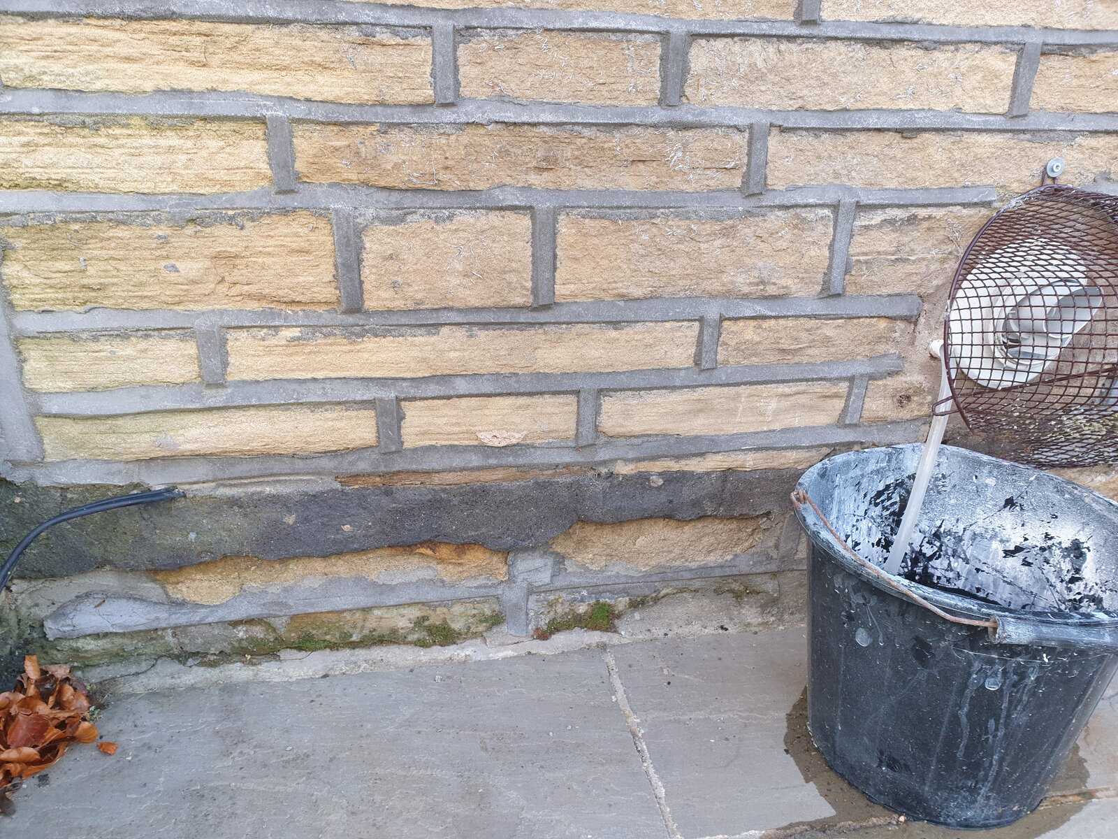

I also suspected the condensate pipe was just stuck into the ground with no soakaway, this is still a possibility BUT I placed the condensate pipe in a bucket for week to check, the damp was still there.
I've now had 7 damp people, and a plumber come round, all with meters and all citing rising damp, penetrating damp, ripping plaster off, injecting a DPC course etc.. I've deleted all their numbers. I'm still none the wiser.

I've looked at your wall, but I don't see signs of a DPC. If there were one, at the age of your building it would be something like a double layer of slate, but from what I've seen slate DPCs are not that common in older stone terraces in Lancashire and West Yorkshire, and if you don't have a DPC with a sandstone wall you'll get damp at the bottoms of the walls - just like you have. With narrow cavities there is also the chance that mortar has fallen down the cavity and that also brings the possibility of moisture from the outer skin bridging to the inner skin, which is another reason you might have damp in the plaster at the bottom of the wall. Obviously you also need to look at other issues such as defective or even non-existent soakaways, damaged or missing timber troughings and damaged downpipes.
You have it in your mind that injection isn't the way to go, but the bottoms of your walls are soaking wet through, and that isn't being caused by condensation - it's either water coming through the wall and bridging across a blocked cavity, or it's water getting pushed/sucked up from the ground in masonry which is porous (and some Victorian "colliery brick" I've come across is like a sponge) in a house which lacks a DPC. So first off you need to find out if your wall is cavity wall or solid - and if it is cavity you do need to find out if the cavity is blocked, but please don't be so dismissive of injection DPCs, they do work for a lot of people in stone terraced houses.

looks like a water leak to me, and there is a lot of water.
is it all round the house? higher in certain areas? or just in particular places? please stand back and take some wider pics, inside and out, and especially of the "highest point" of the damp, if there is one.
As you are in a terrace, I presume all the other houses were built with the same materials and techniques, at the same time. Are they all damp? Do they have damp patches, and do those patches coincide with, say, a kitchen, bathroom or downpipe?
does rainwater lie on the paving, or run towards the house wall?
please sketch the position of drains, gutter downpipes, gullies and manhole covers
and water pipes, sinks and taps, and especially the incoming supply pipe. Does it run under the hall floor? is the floor solid or wood with a ventilated void beneath? Is the floor wet?

Caveat with I don't think this is the primary cause - but I would remove of some of the cement strap pointing and investigate the condition of the original lime mortar behind. Potentially water is getting trapped by the cement not allowing the wall to dry, thus making condensation more likely.
