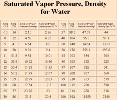

The essential detail may be that this occurs when you turn the heating on in winter. Two things we can take from this - 1) warm heated air has the ability to carry more moisture than cool air, so it may well be that your moisture-load in winter with the windows shut is higher than summer. 2) As it's winter the bottom of the wall will be colder.
It's a fairly straightforward calculation. Get a hygrometer/thermometer and an infra red surface thermometer. One evening, take a humidity reading and room temperature after a full day of heating and normal living. In the morning, after a chilly night and after the heating has been off for a while, take a surface temperature reading of the base of the wall.
From the table for room temperature you can see the saturated vapour density which multiplied by the RH% gives the actual vapour density. Looking at the table you can see what the dew point is for that vapour loading (it's the corresponding temperature for saturation). If your wall temperature in the morning is lower than that, you are getting condensation on the wall surface
Say 25 degrees and 60% RH (yes warm and quite humid) the vapour load is 23 x 0.6 = 13.8 g/m3. The dewpoint for this vapour load will be about 16 degrees (from the table 15 degrees is 12.83).
If calcs show condensation is a risk, then the principal remedies are to avoid moisture-creating activities, improve ventilation and possibly get a dehumidifier.
And for the pedants - yes, I know technically relative humidity is the ratio of vapour pressures not vapour densities, but the calcs are virtually identical and it's easier to visualise/quantify grammes of water/cubic metre

I thought I'd provide a quick update on this - especially the calculations you've provided. Tuesday evening I noticed the darker patch appear on the wall again - checked the thermometer/Hygrometer nearby and it was reading 70% humidity (we'd just finished having dinner etc..) at 19 degrees indoor air temp (i don't have a thermo gun to check the wall) BUT it was the first sudden drop in temp all year - with outside temps of 14/15 degrees. I used a dew point calculator and it spat out a number of 13.5 degrees, which correlates near enough to the outside temp and consequently the affected wall - of course, there must be a reason this section of wall is much colder and will need addressing.
So, this MUST then be the source of damp on the internal wall - there's no question about it that it's condensation related. The questions now remains of how to fix it.

You can't cure condensation with membranes and paint. There are only two things you can change to prevent it - the humidity - dehumidifiers and/or ventilation, and the surface temperature of the wall. This is what internal (or external) insulation does - because it passes heat energy slowly, it is likely that the insulated wall surface will be closer to room temperature and condensation can be avoided.
The problem to watch out for though, is if that warm room air can get behind the insulation it will condense IN the wall. This is obviously not desirable, so internally insulating a solid wall is problematic. I've internally insulated my 1902 ventilated cavity wall with good outcome, but don't have first-hand experience of insulating solid walls. I have my opinions (that don't involve any sort of damp treatment) but hesitate to offer definitive advice. Have a read here:- https://assets.publishing.service.g...attachment_data/file/1019707/iwi-guidance.pdf
