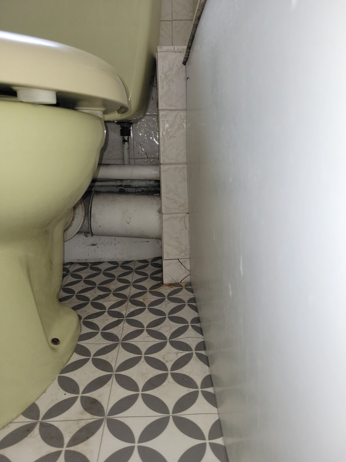

Hi we have a 70s bathroom where a 22mm pipe comes around back of bath exits at the end of bath panel against wall short stubby 22mm bit of copper pipe pops out of tiles then goes to a 22mm 15mm 15mm soldered reducing tee. Top of 15mm tee straight up to solid copper pipe(roughly 45mm length) to soldered tap connector straight onto bottom of cistern.
Other 15mm part of tee continues on to basin to the left hand of toilet.
I want to some how fit a method of isolating the toilet and basin so I can do some repairs on the bathroom floor.
There isn't enough space to fit an isolating valve under the bath, at the end of the bath, before the reducing tee, or in between the cistern and reducing tee.
I can fit isolating valves before the taps easily but isolating the toilet is proving to be impossible.
Plus the basin waste pipe is right in the way of the copper pipes
Any ideas how to isolate the cistern?

Need to see a pic of the toilet pipework - but you would use either a service valve (not an ISO valve) on the fill valve or trim the pipe up to the cistern back and then connect a flexi with a valve.

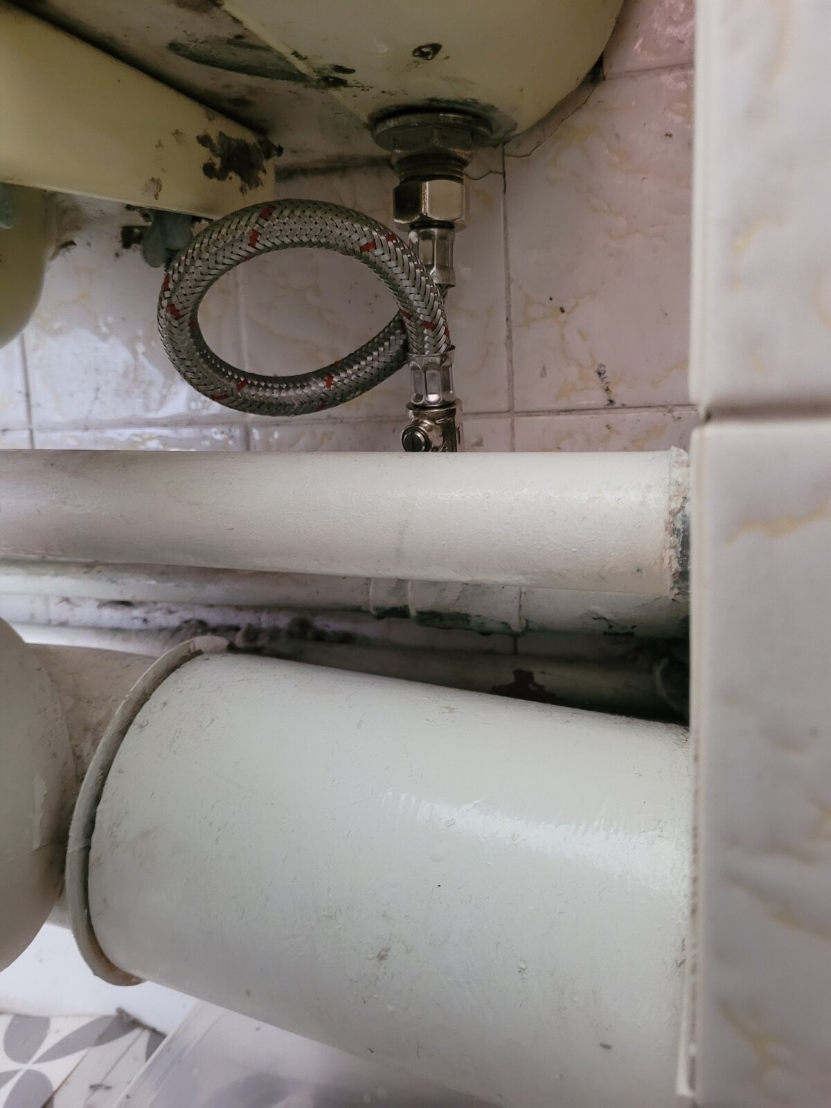

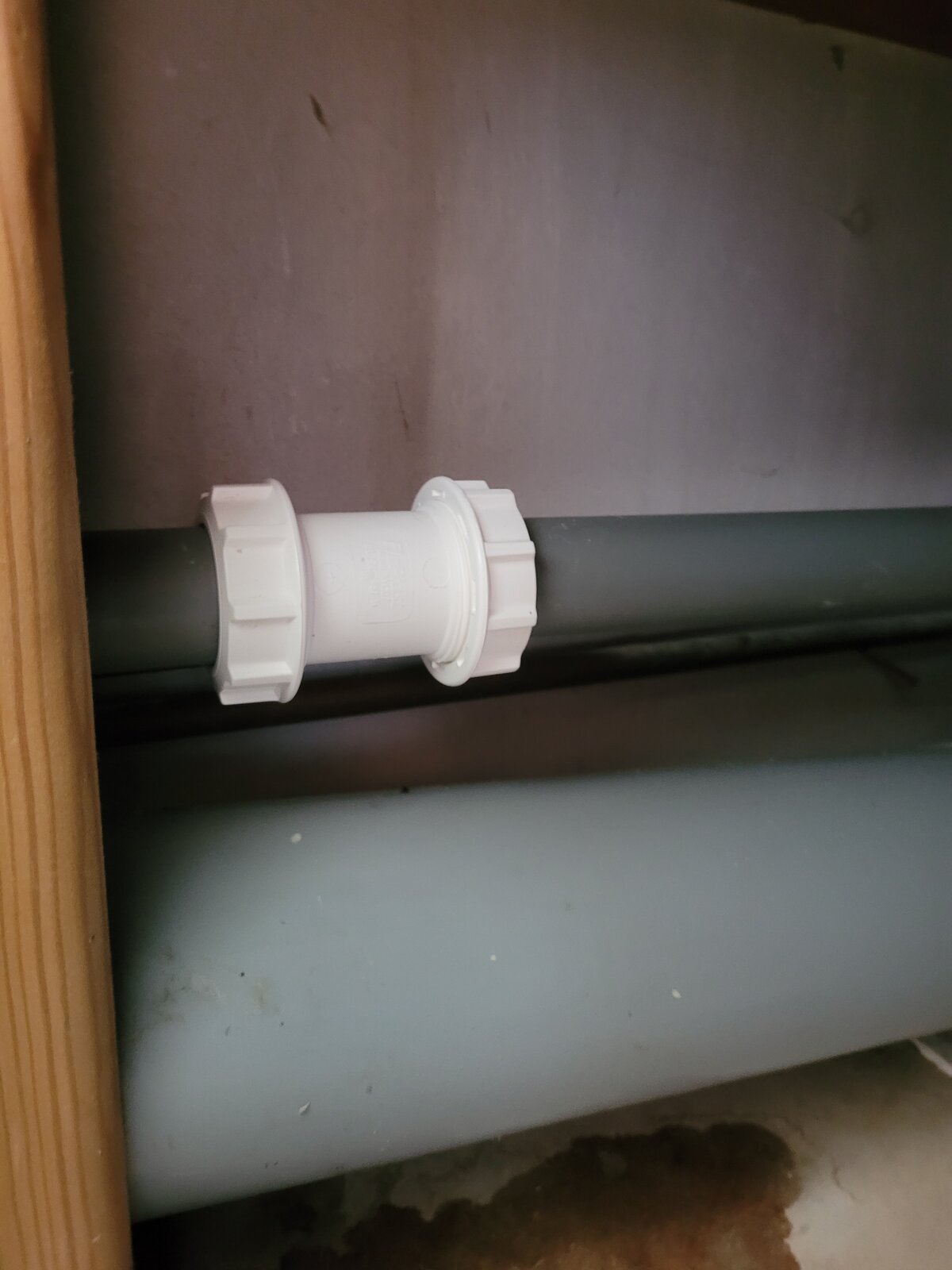

Had to cut the basin waste under the bath to get it out the way but toilet now has an isolator valve. Thanks for the advice.

Sorted and such a lovely pigtail ;) - can I recommend that you use McAlpine stuff in the future rather than the B shed's Floplast - it's so much better quality stuff.
