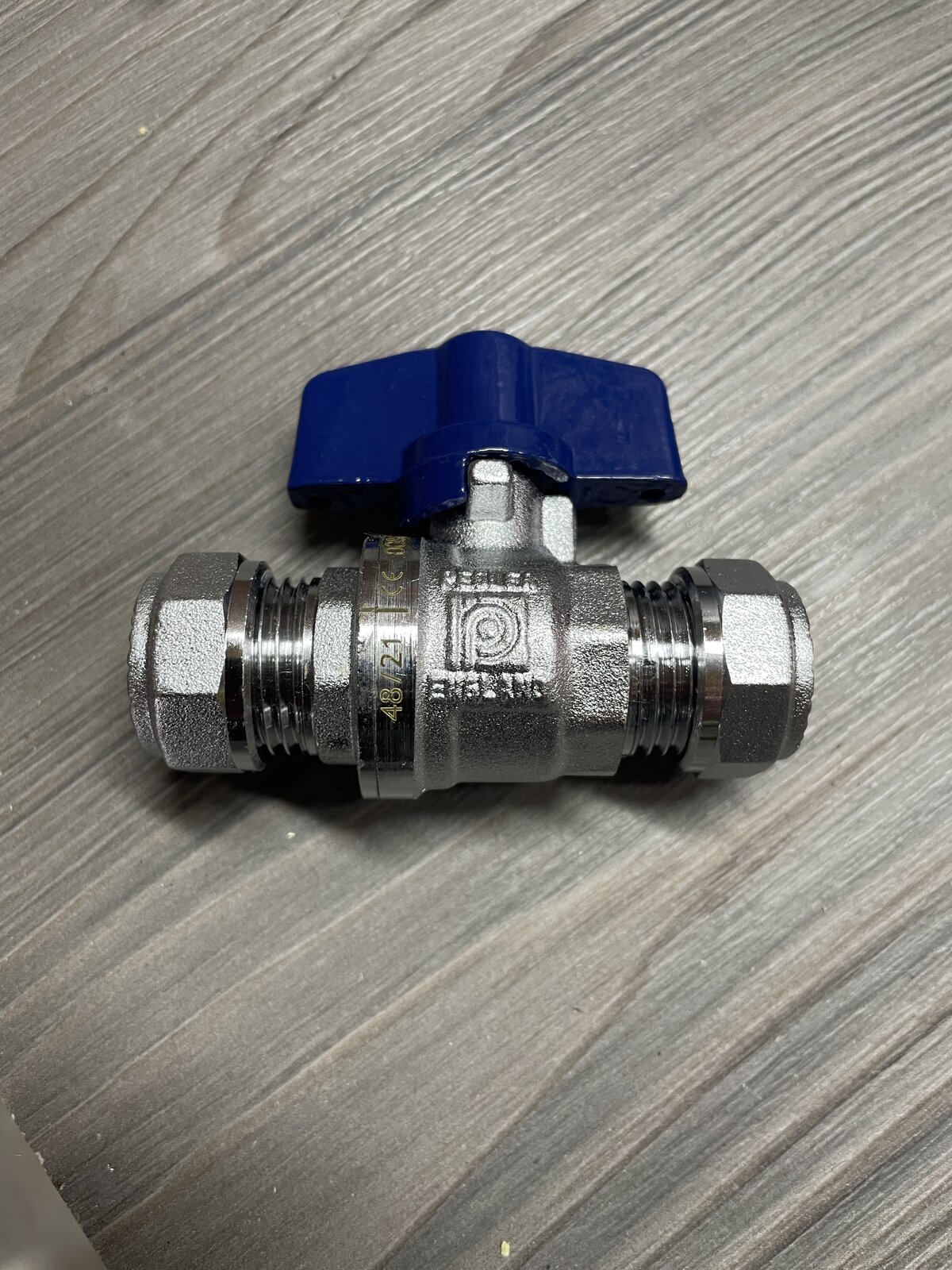

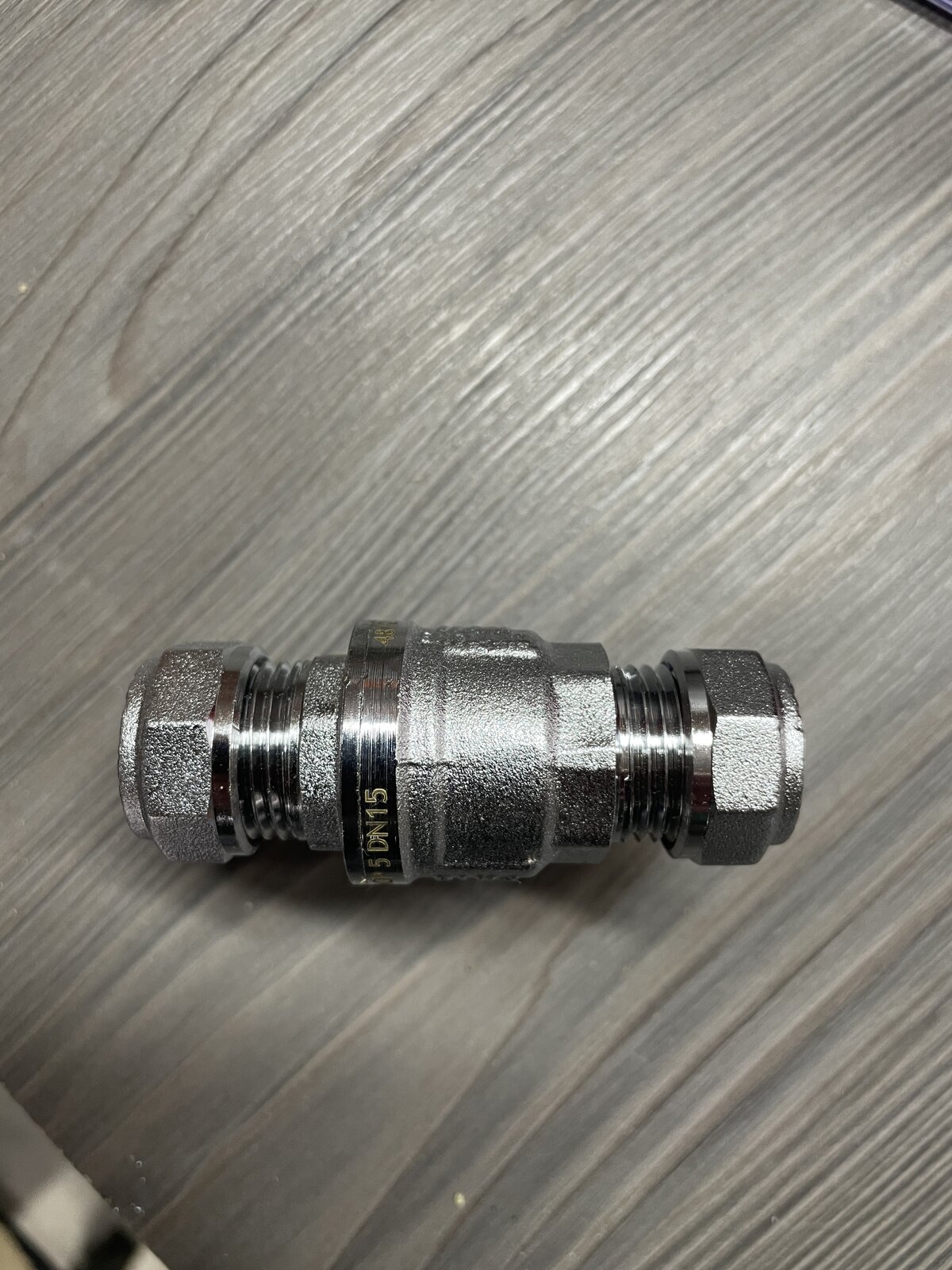

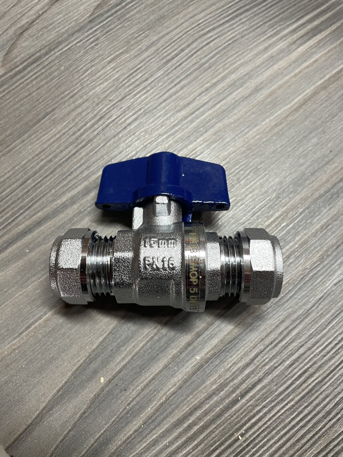

Hopefully a very quick question for those in the know
Can anyone tell me whether there is a right and wrong way for this isolation valve to be put on, please?
I have an equivalent for the hot water also
There’s no directional arrows on the body that I can see, so I’m assuming no
Is that correct, please?
TIA

No ,it looks like a full bore isolation valve. If you open the valve and look straight through it ,the inner diameter should be close to the same as the pipes connected to it.
Thanks @terryplumb
I just found this thread on another forum which seems to indicate there is a right and wrong way in which case why don’t they stick an arrow on it
Take both nuts and olives off yours and show us two pics,one of each end looking into the valve.
According to Pegler's MI, all their ball valves may be installed in any orientation with absolutely no reference to flow direction unless indicated by an arrow.
Sorry @terryplumb by the time I saw your reply, I’d already fitted them as that previous link I shared mentioned
Looks like @Madrab replied also and was able to confirm that they can be fitted either way also
Thank guys much appreciate your replies
It seems to be working just fine btw
