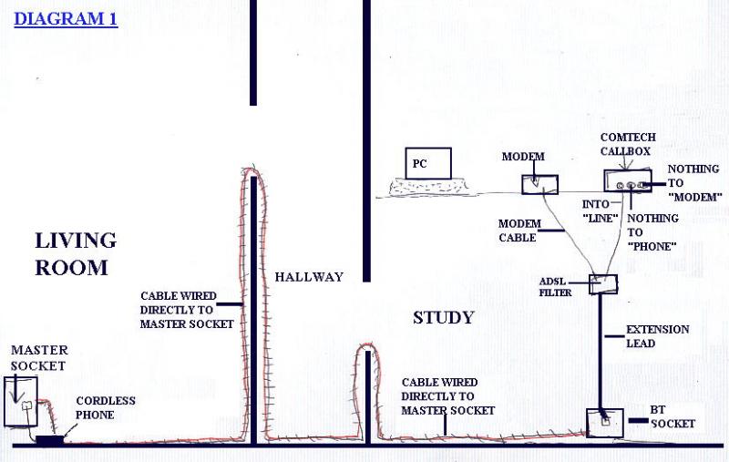

DONT KNOW IF THIS WILL WORK BUT THIS IS EXACTLY HOW ALL THE CABLES RUN.
Why is there no diagram it says upload successfull and I see my pic in the uploads but not on here. How do I get it on here.
Assuming you mean upload to your images at diynot to your album you need to insert the code for the image into your post. Select the image and click on it - from the new page select the code for diynotbb code and paste into your post.
I have managed somehow to put in a link to the diagram which you can see if you click the little thumbnail each time you will see a big pic.
But still dont know how I get it directly into my post.
Also my internet line has not dropped yet, still pugged straight into master socket. Is this starting to mean something.???

My edit on your diagram assumes that the cable that runs from the master socket to the Bt socket on your diagram is wired into the master socket and doesnt plug in the front
Thats correct. the cable is wired to master socket.
But if I put my filter at the phone end then I wont have one for the other end. Or do I need to just purchase another ADSL filter.?
Bingo!!!
No wonder the bloody thing disconnects if thats how you have it set up!!!
Get another filter and I assure you it will be fine.
Right, so can I for now leave everything as it is on my diagram. Then tomorrow purchase an ADSL filter and connect this into the Master Socket and then plug my phone into the ADSL filter. but leave all other cables as they are.
Correct.
By the way this still has not disconnected yet.
It will.
