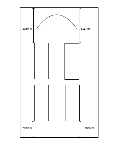

I'm looking for some advice on the following issue
Recently had a new composite front door installed. On initial inspection, the install was very good, and the installer was paid on the day.
The following day, I noticed that the door just didn't look right, it was almost as if it was lopsided.
I took some measurements, and there is a 2mm difference between the top and bottom of the door to where the glass cutout begins and whilst that doesn't sound a lot, it is noticeable to the naked eye particularly as the whole middle section of the door containing the glass appears be slightly tilted.
I brought this up with the installer who has contacted the manufacturer, at the moment, the manufacturer is saying that the difference is within the standard tolerances, but I can't believe that to be correct.
Here is a simple drawing of where the differences are to explain what I described above, can anyone comment on whether this is acceptable ?
note that the measurements are not the actual measurements, I can't remember exactly what those are, but the 2mm difference is accurate.

Have you tried placing a level on it to see if its hung badly. I'd be surprised if 1% was noticeable. Avoid dialogue with the manufacturer, your claim - if you have one is against the retailer/installer
There's no issue with how the door is installed, it is how it has been manufactured, it is most certainly noticeable, everyone I have asked has said they can see that it looks like it is tilted to the left.
Are those differences with the door sash closed in the frame , or open ? if closed , it could just need adjusting
The whole glass industry works on quite a large tolerance of +/- 3mm so I could well beleive that the manufacturer is saying it is within tolerances, can't say I'd notice a 2mm difference on a comp door ...or any door to be honest
@motorbiking , you will always have issues with shudder on that door set up , whether it is composite or Upvc. there is technically nothing keeping that frame layout 100% rigid due to where all the joiners are. the joiner directly above the door is not physically attached to the joiners down either side of the door , so those side joiners are suscepitble to Judder...It will happen on a pure PVC door too, just an unfortunate issue with that layout...obviously with wood the top joiner is fixed to the side joiners, so won't move as much ( I would still expect to see a minor amount of movement though.,..)
The difference has come about probably during the CNC routing when that particular size door was cut from the slab/blank but as Ronnie says it's within tolerance, I'm very surprised 2mm stands out as much as you say, I'd like to see a picture though if poss

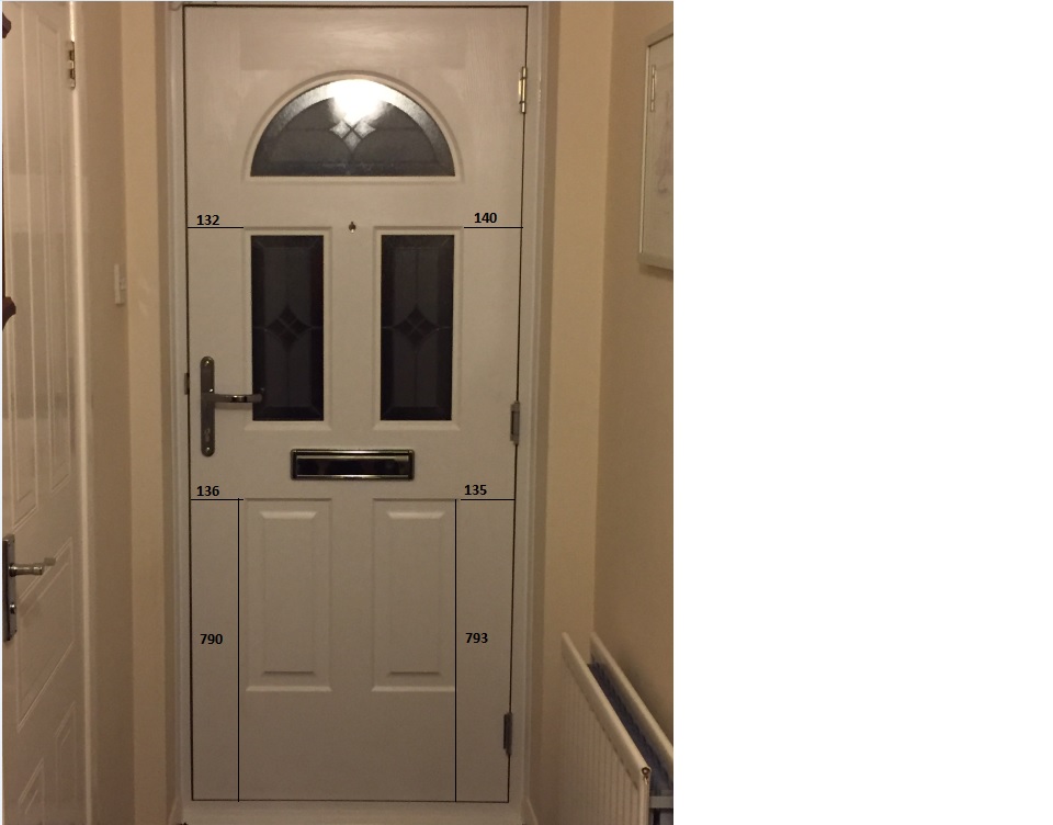

So I took some more measurements and discovered more discrepancies, please see the attached photo which hopefully explains what I'm on about.

Are the measurements from the edge of the door slab , or the internal edge of the door frame?
Have to say , without your measurements , not sure I would have noticed anything adrift from the photo
How about a photo without the dimensions? Can't say that I would notice them. No offence but your recent revelation that there are other discrepancies suggests you didn't notice them until you measured them.
No offence taken but do you think I'd be wasting my time doing this if I couldn't see something wrong ? Obviously it's subtle and viewing a photo on a computer screen is not going to show up a 5mm difference anywhere near as much as it would in real-life.
The fact of the matter is that there are the discrepancies as shown in the photo, and whether one person notices them more than another is not really the point, what I'm trying to get to the bottom of is whether legally I have to accept is as within tolerance or whether this is beyond acceptable.
Measurements are from the edge of the door slab
