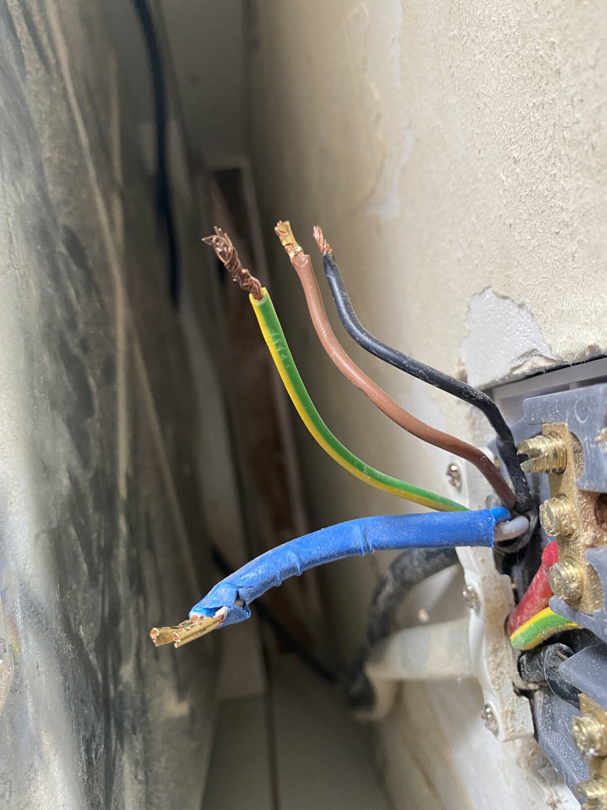

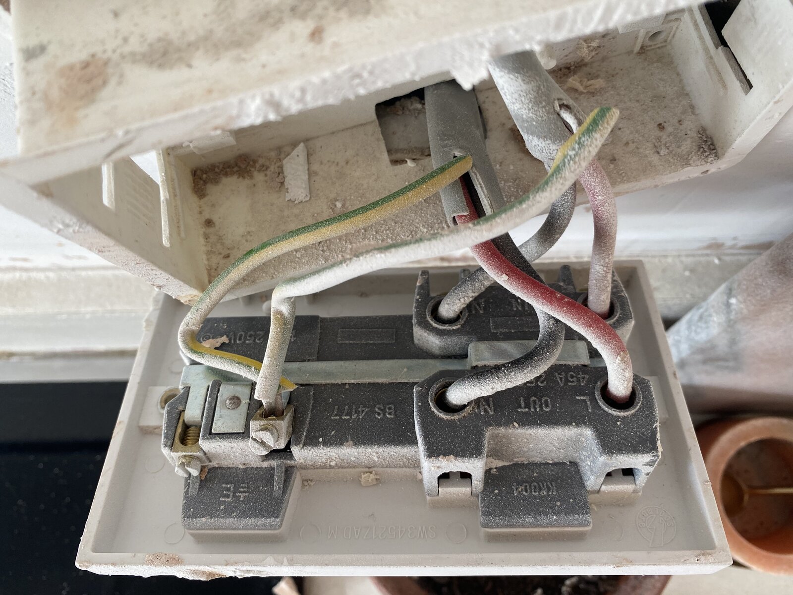

Hello, I hope someone might be able to help me. We recently removed our old standalone hob/oven and replaced it for a separate integrated oven and an induction hob fitted into the worktop.

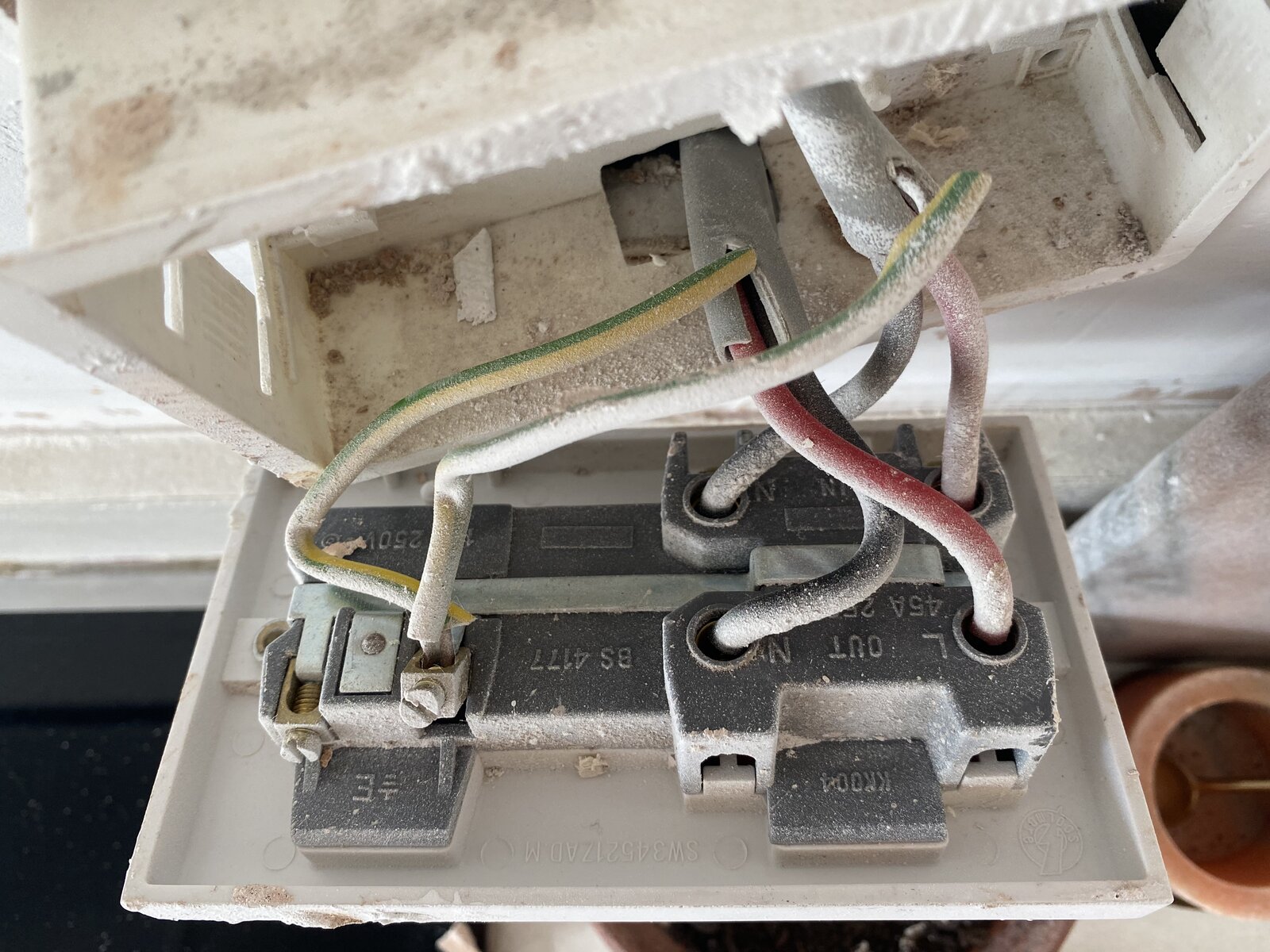

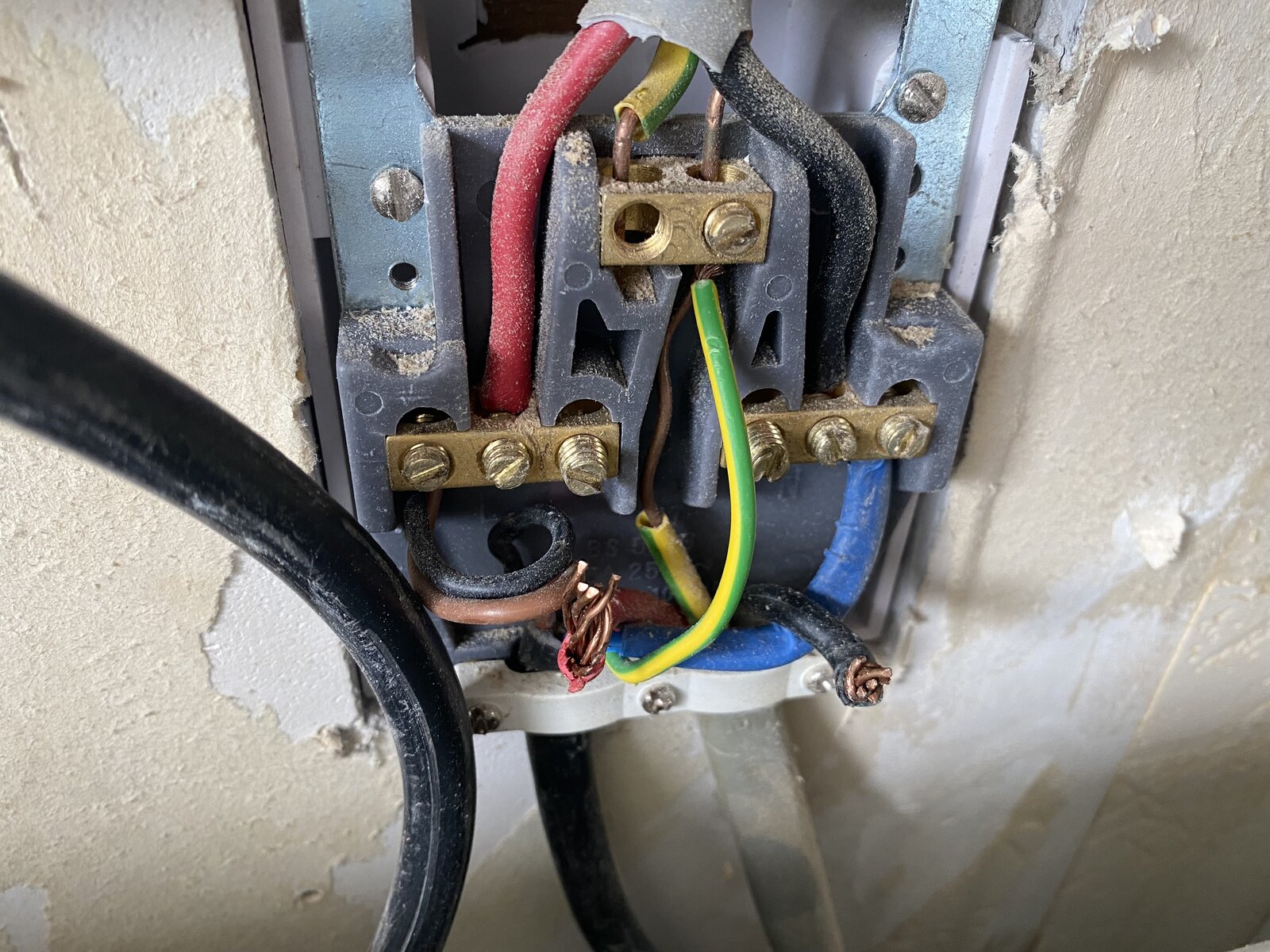

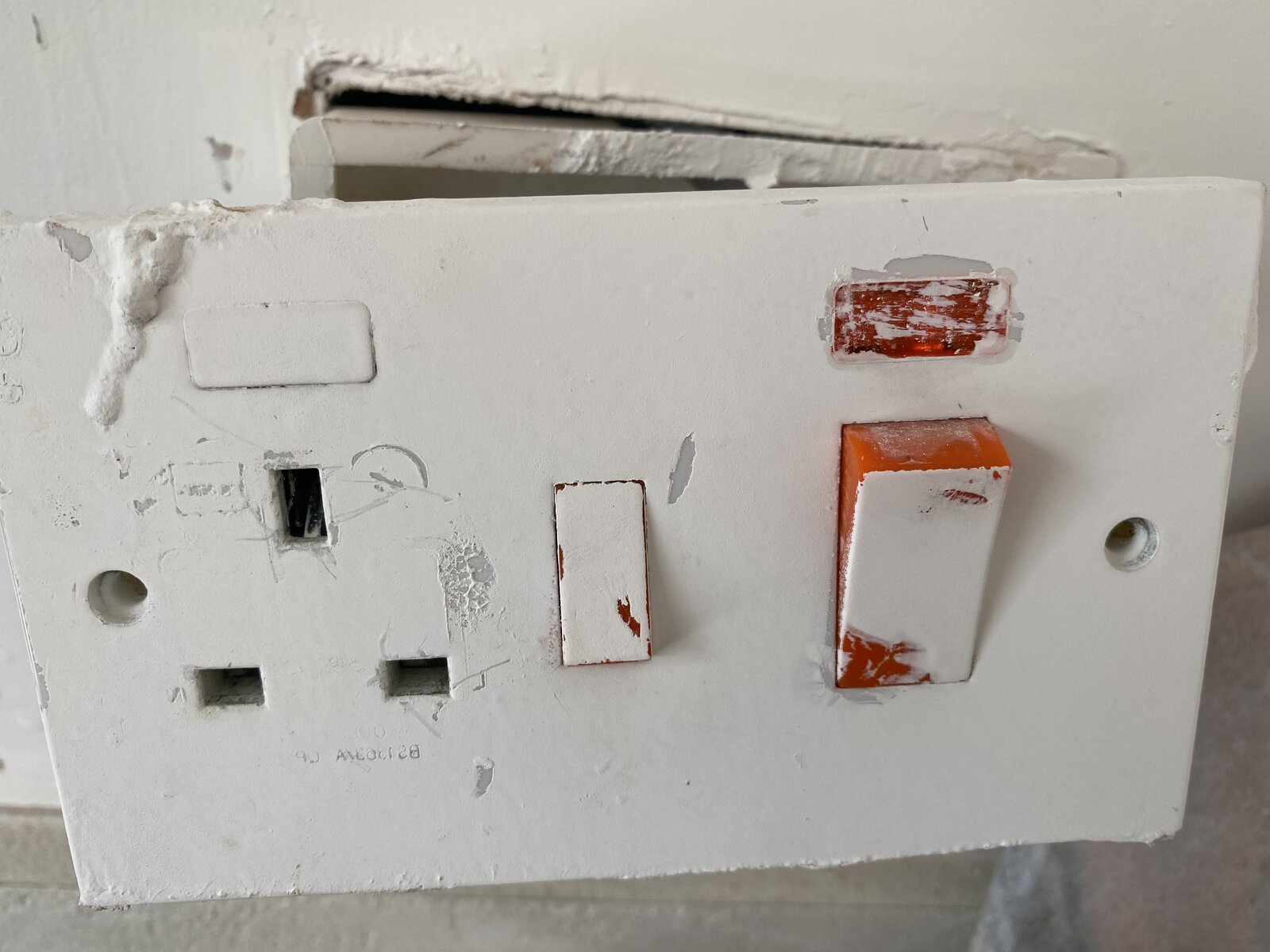

We had the original 45a switch with plug socket, which is still in place, and I replaced the cooker connector unit with a dual connector unit behind the oven to accommodate the two appliances.
I have 6mm wire running from switch to connector unit and then to the oven. I am using the wire built into the hob connected to connector unit. (Black wire in photo)

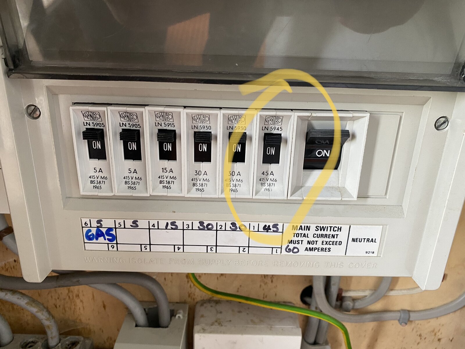

The fuse being provided from MCP is 45amp. The oven is 2.2kw and the hob is 7.2kw.
When I use the hob alone, it works fine. When I use the oven alone, it works fine. Together though, it’s clear there is not enough power being provided and so neither applications can reach their desired temperature.
From what I have explained and also the pictures provided, I’m hoping that someone might be able to see what I’m doing wrong.
Ps, please don’t judge the paint stained switch too hard, it will be replaced with a chrome one soon!!

Just to stay, the picture of the connector unit shows the wires disconnected. This was to accommodate being able to use the hob temporarily on its own
Power is not provided. The appliances will draw whatever they need regardless. They will not be limited by the 45A MCB (miniature circuit breaker).
What is the black wire connected with the brown?
The black with the brown is from the hob. I believe these are both live.
Ok. Five core with Brown and Black Live and Grey and Blue Neutral if that is how it is supposed to be.
I can see nothing which would cause the problem you have.
Nothing to do with the problem but I have just noticed that the supply cable earth terminal has no screw. Put the wire in the other terminal with the other earth wires if you do not have another screw.

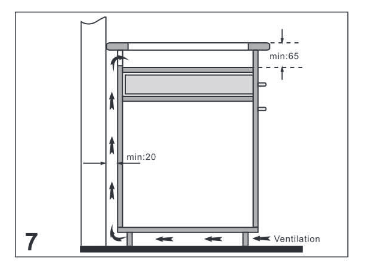

Thank you. In the case of 'the problem occurring when the oven is not switched on' - the problem does not occur when it is not switched on, but does occur if the oven is running the fans to cool down from previous cooking. I just removed the connection entirely to prevent this. As soon as I did this the hob was able to boil water as normal.

So looking at other reasons, like hob having an over temperature device which lowers output should the hob get too hot, or RF from the oven's fan affecting the hob.
In general the whole idea of separate hob and oven is so oven can be fitted at a higher level to reduce bending. Can't off hand remember distance hob to any item along side, but likely some thing like 100 mm so any oven not really that close to the hob.
However have seen it where a kitchen is done as stages, when we moved into this house the oven was under the hob, we up graded to our stand alone cooker, with a stand alone cooker the oven has a 32 amp supply, so the elements can be used together, we have side, top and fan back, allowing door closed grilling, which works well, but mothers over also had door closed grilling, but used a time share between the elements so as not to exceed 13 amp, so result was it did not work anywhere near as good as with the stand alone cooker. So in real terms no point having a built in oven under the hob, may as well be stand alone.
So my first thing is suggest you read the hob installation manual, the electronics of the hob need keeping cool, so how the oven cools is very important, in the main air is drawn from front bottom and blown out front top, it is important that warm air does not heat up the hob. There should be some thing to divide the oven from hob. Seem to remember mothers hob giving a distance between it and oven which could not be done due to low counter her being in a wheel chair, so oven had to be eye level, in fact to be able to miss wheel chair yet allow mother to see items in the grill, there was around ½ inch lee way. Even then they forgot the temperature was written on the top of the knobs, so unreadable in a wheel chair.

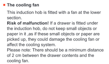

I did an internet hunt for "induction hob installation instructions" don't know the make of yours, so just selected the first one which was Bosch,
It says it should not be mounted over the fridge or washing machine or similar items, I would guess that is because of the heat from them, as to if an oven is considered as a similar item not sure, but main difference is a fridge or washing machine normally stands on the floor, so you can't get the ventilation shown.
So what does your installation instructions say?
I did an internet hunt for "induction hob installation instructions" don't know the make of yours, so just selected the first one which was Bosch, View attachment 278128View attachment 278129It says it should not be mounted over the fridge or washing machine or similar items, I would guess that is because of the heat from them, as to if an oven is considered as a similar item not sure, but main difference is a fridge or washing machine normally stands on the floor, so you can't get the ventilation shown.
Tnx, I wasn't aware that induction hobs need airflow.
