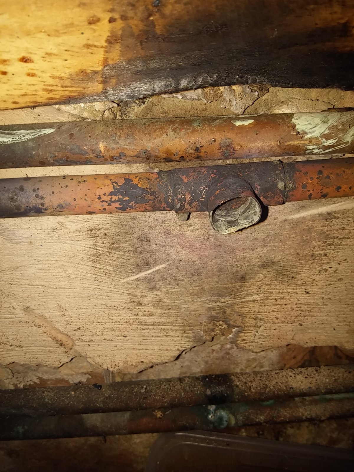

I just managed to remove the soldered joint and I am left with the below..
Is this salvageable or do i now need to replace the entire tee?
Oh, erm, my :eek: ... that aint the best
When removing the small stub of pipe you were only to use just enough heat to melt the solder on the leg of the tee that the stub of pipe was into , not hot enough to bend the copper out of shape and losing all the solder in the fitting ..... and starting a bonfire with the baton ;)
That Tee will need to be removed from the pipe as it'll never be right and a new Tee put in ..... probably safest with a brass compression Tee. I'd also maybe cut the small sections of pipe back to pipe that's not heat damaged and put a new piece in.
As per madrab. Sorry, needs to come out, it might have got distorted when removing, but you probably won’t get a decent re-solder without several attempts and swearing.
