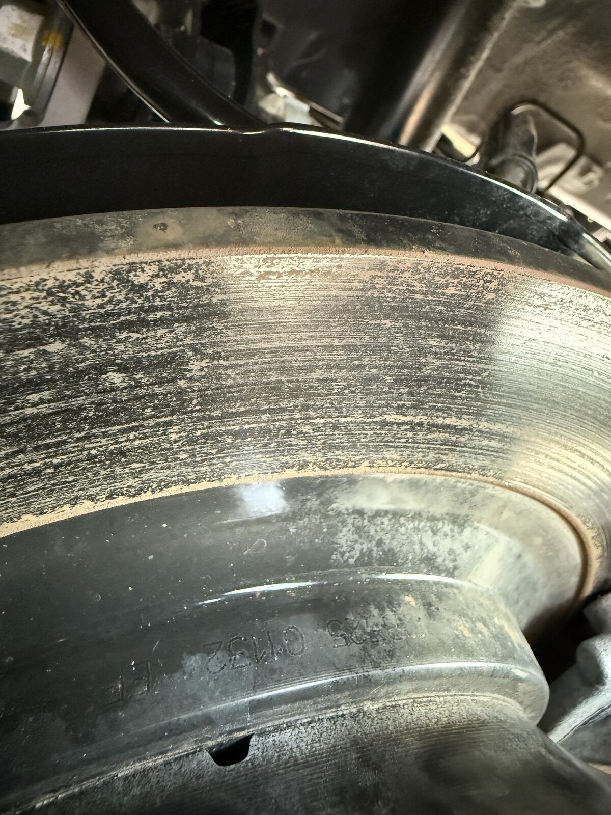

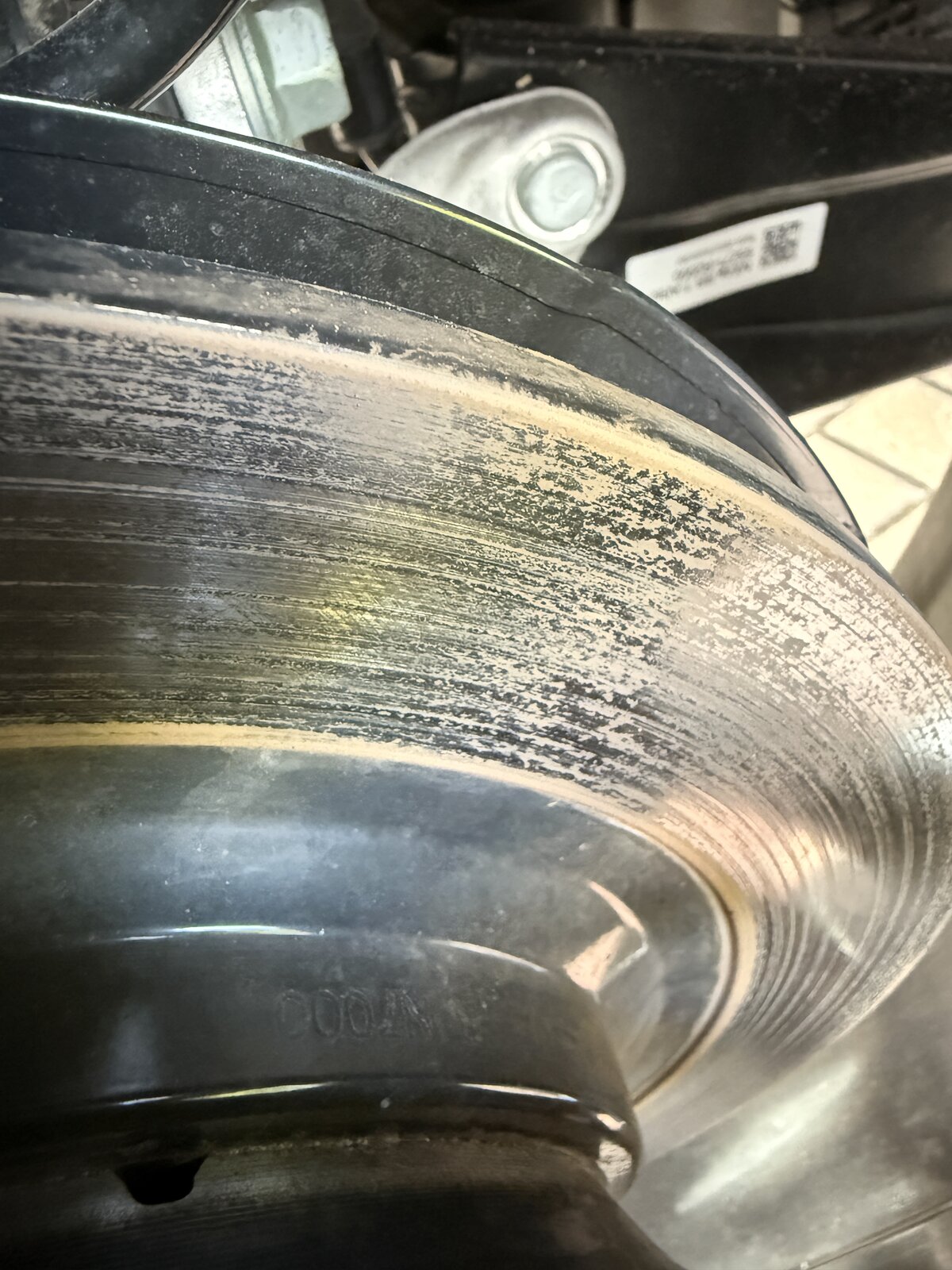

Just noticed this - I'm going to get on to the dealership tomorrow to take it up with them. Bearing in mind I only picked up the new car yesterday and it had 46 miles on the clock, look at the condition of the rear brake discs. Pitted to fùck! Fronts are fine. I know some cars can get rusty discs after just washing them (our A3 was like that) but they clean off after a few hundred yards. I’ve done about 30 miles in this and they are looking terrible. Must have been sitting about for a while. I’m not having that!
N/S/R
O/S/R
Are they really "pitted" though, in that are there actually indentations, or is it just patination on the surface?
Whilst it doesn't look great, it probably is quite normal for a new delivery car, given they have to be on a boat for some weeks. In a few months, they would look like this anyway.
Not good - they have surface rust already which will just be polished by braking, rather than being removed.
Replacement needed!

Just found out that it’s a common problem with hybrids in so far as that you hardly have to touch the brake to slow down. In regen mode 3 on this car you can practically come to a stop by taking your foot off the throttle! Reading up, there’s a 'Disc cleaning' programme on the car! Just been out and tried it and it has cleaned them a bit. Can’t see too well at the moment but I’m going to notify the dealership to tomorrow that I’m not happy and if they don’t clean up after a week or so, they'll have to sort me out a new set of discs and pads.
A disc cleaning programme is a completely new one on me! Time I packed it in.
Anyhoo, we all know that the rear discs don’t do a great deal compared to the front so I’d be surprised if they cleaned up perfectly.

Have a look through the papers that came with the car. There should be a single A4 sheet called a "Certificate of Conformity" in amongst them. It will have loads of data about your particular car on it and is a valuable document. Field 0.11 will give the date of manufacture of the vehicle, so you can see how long it has been sat in a field before you bought it.
