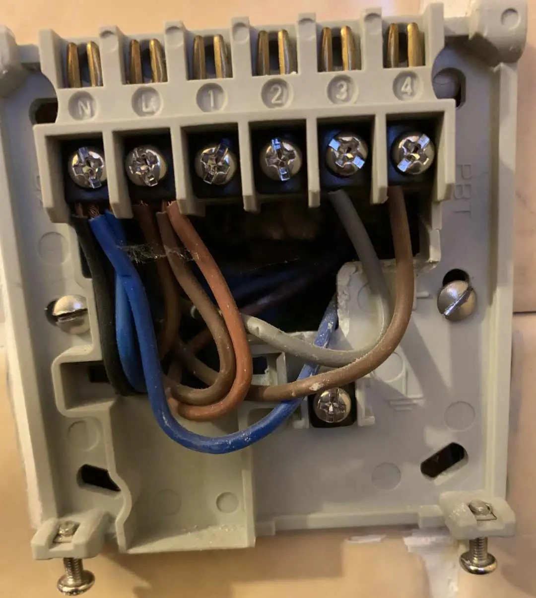

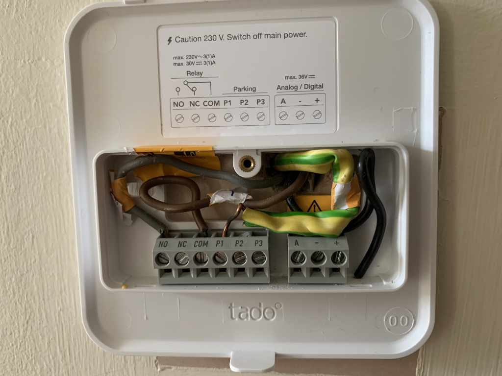

This is the wiring for the old Honeywell T6360B thermostat:

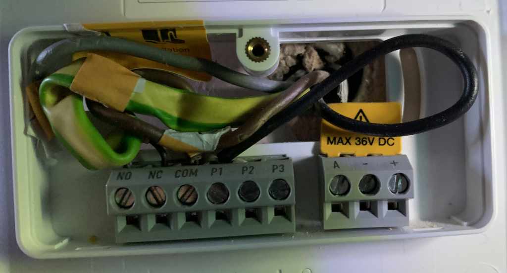

This is the wiring for the new Tado wired thermostat that replaces the Honeywell:

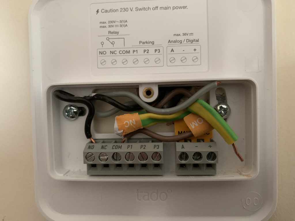

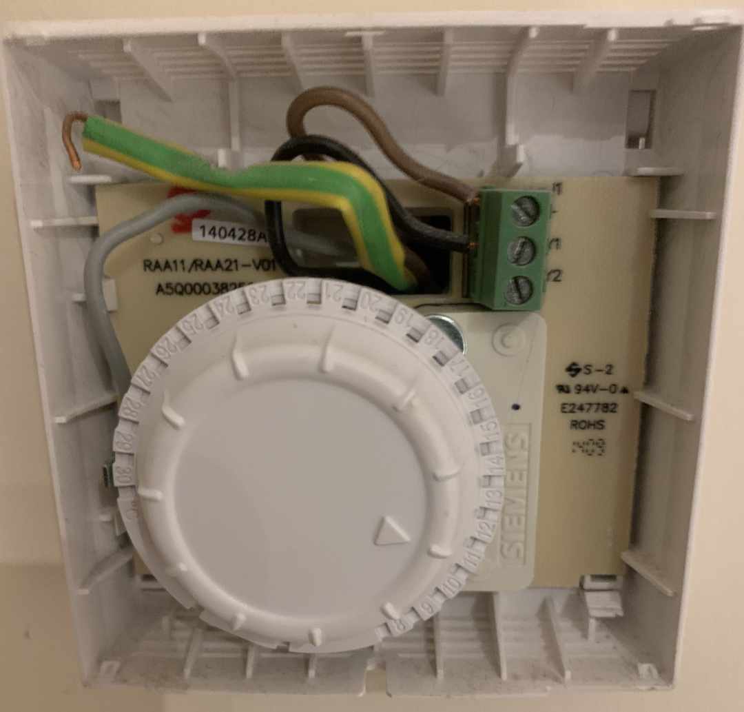

This is the wiring for the old Bosstherm BRTMK2 thermostat:

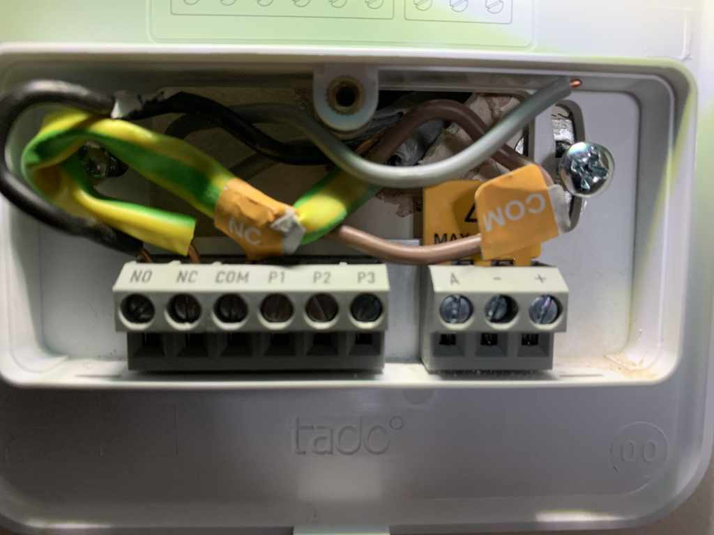

This is the wiring for the new Tado wired thermostat that replaces the Bosstherm:

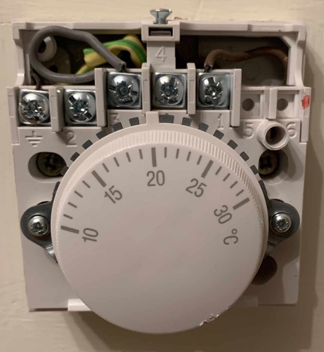

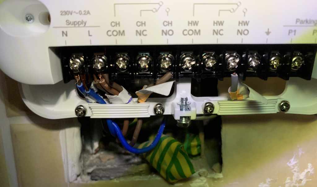

This is the wiring for the old Siemens RWB9:

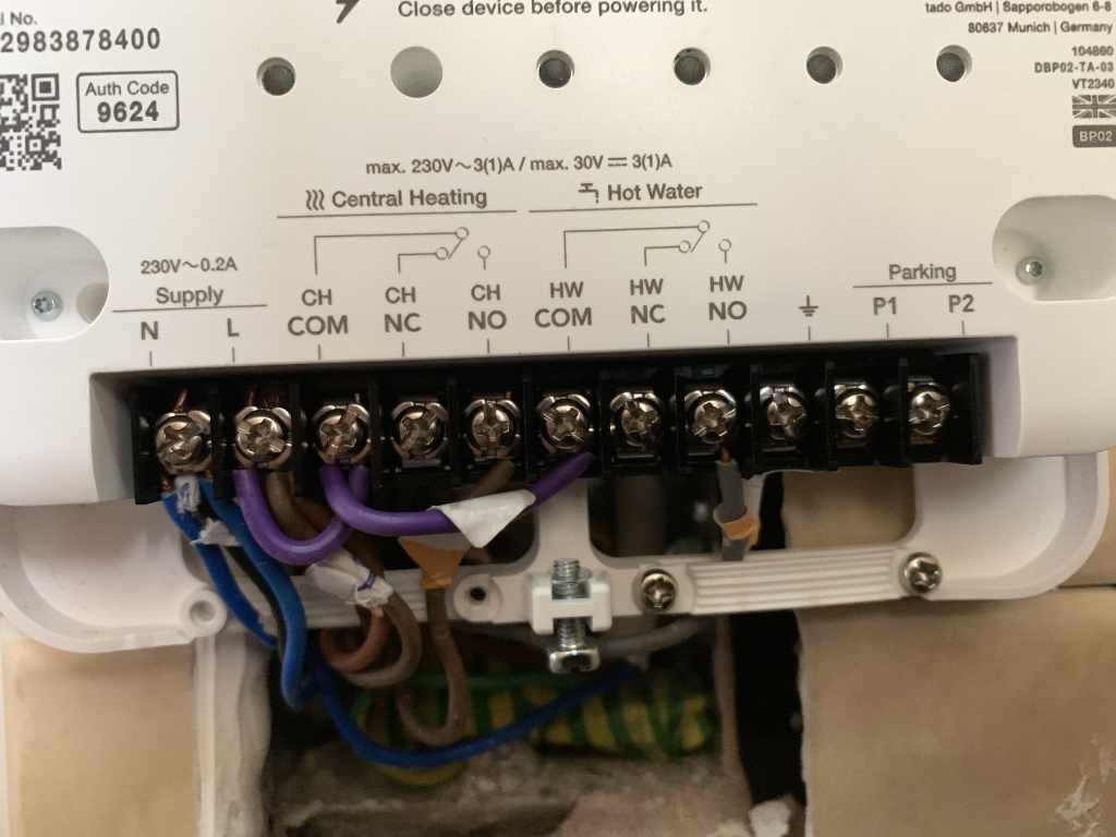

This is the wiring for the new Tado receiver that replaces the Siemens RWB9:
Oh my where to start?
You seem to have put earth/cpc into normally closed terminals.
You seem to have an additional black wire from original Honeywell
It’s hard to see where you have put the common on the Tado that replaces the Siemens, it looks like the wrong terminal and could have caused damage.
In the last one, you don’t have any commons at all, which should be linked from the L terminal
I looked at Tado which seems very similar to Nest Gen 3, and noted no wires in common so clearly will do nothing.
What we have to remember before Part P often central heating was wired by plumbers who had no idea of what the regulations required, and would use earth wires as live wires. And also fail to run earth wires.
With my own system I had to work out what wires ran where, then select a system that would work with existing cables and design from scratch.
I selected Nest Gen 3 as two wires would power the thermostat and transmit all info, not that it was best for the house.
I understand that, but it looks like they were terminated in the correct earth terminals originally, it’s the OP who has done it wrong.

The hot water however doesn't seem to work. Any ideas? Here is my updated wiring:
Tado Wireless Receiver
I don’t suppose the thermostats would have any impact on the hot water. But I have included the updated wiring:
Replacement for HoneyWell:
Replacement for Boss Therm
Thanks again for the help and patience!
Did the RWB9 do the hot water too? It seems there’s 2 zones for heating, but no additional control?
Thanks for all the replies and suggestions RandomGrinch and CBW!
I got this working! The Tado comes with a wireless thermostat. Tado advised me that this wouldn't work for my house and I need two wired thermostats. However, it turns out the wireless thermostat controls the hot water.
So if anyone has this situation, you just need to do the following:
1. Set up the wireless thermostat following the instructions to pair it to the main receiver.
2. Run the test mode on the main receiver for hot water.
Once all this is done, the hot water will work. No changes to the wiring is needed.
You can then either assign the wireless thermostat to the same area as the wired thermostat. Or you can make it it's own area. As an own area, it can't control the heating, but it can show the temperature of the room it is placed in.
