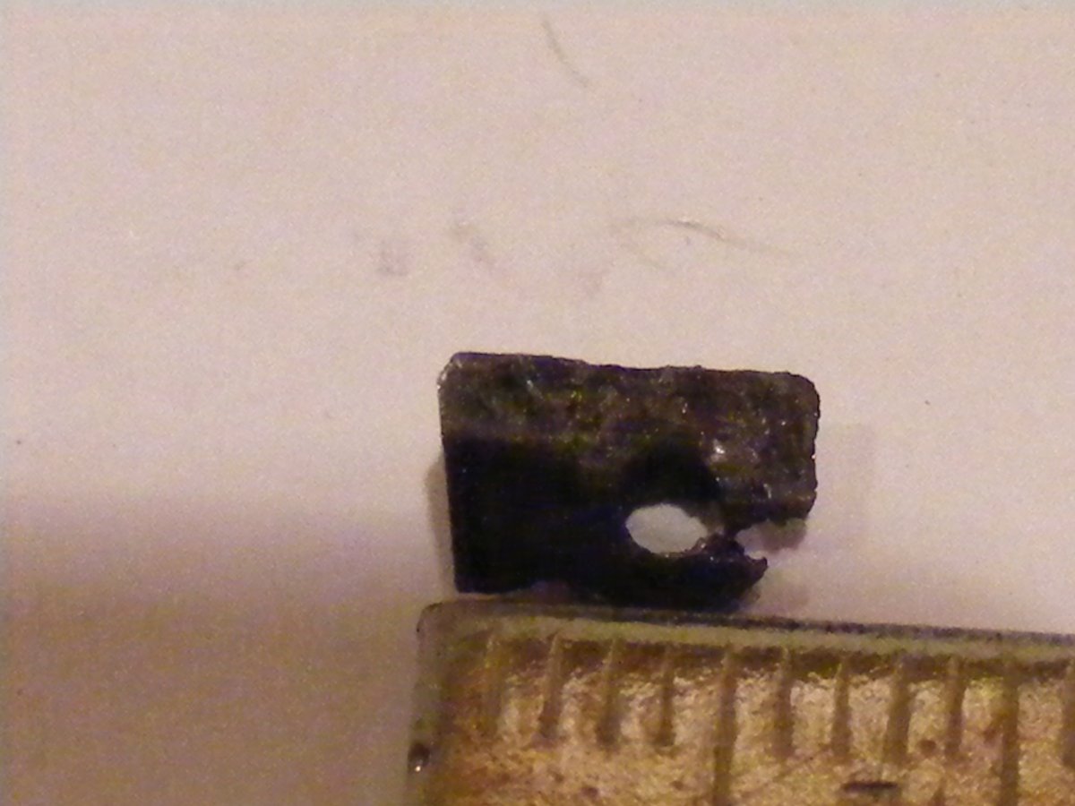

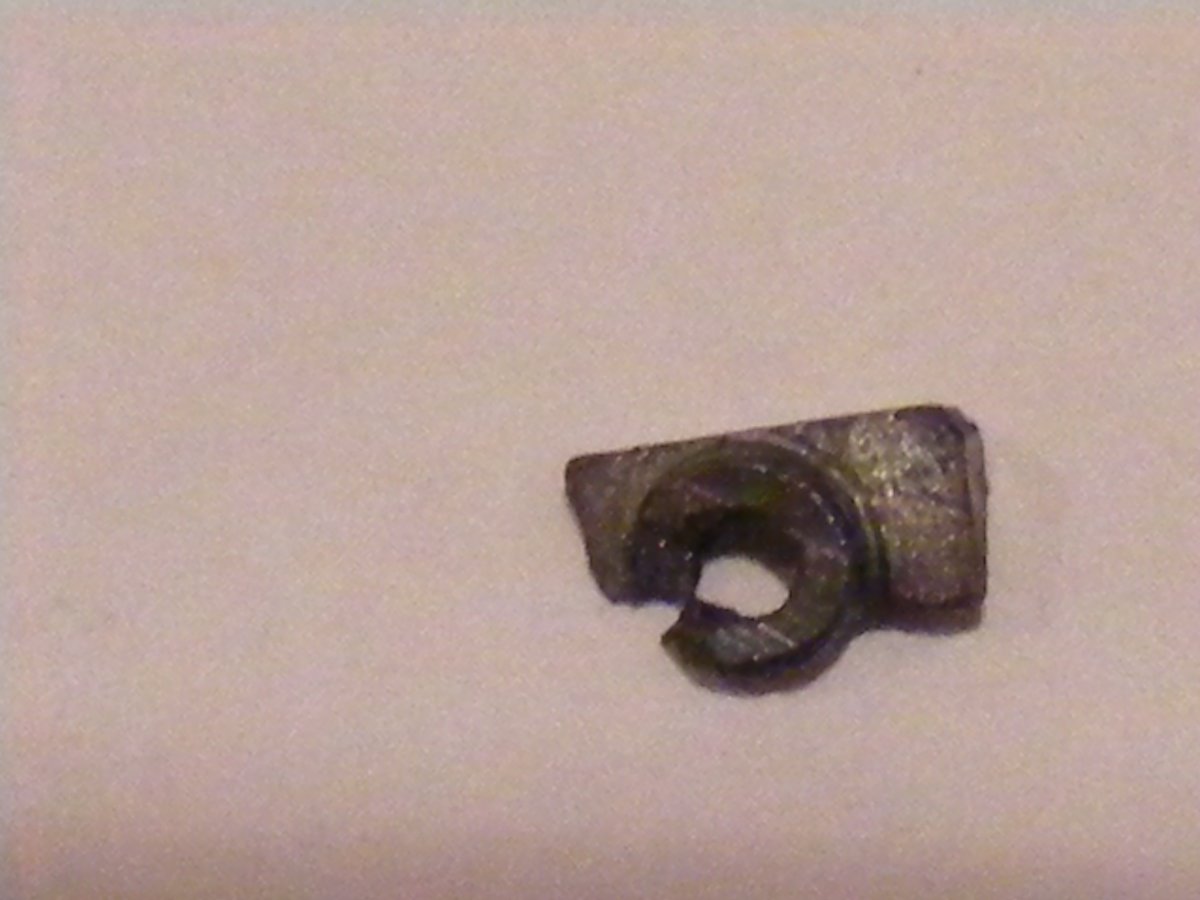

Quite possibly its from the brush assembly itself.....the carbon connects to a small round cap by a flexible lead, enclosing a spring too. The round cap does tend to fracture on occasion.

Hello John,
I have taken a couple of super macro picture of the fragment that came out it's length is 5mm I do not think it is part of the brush what do you think?
