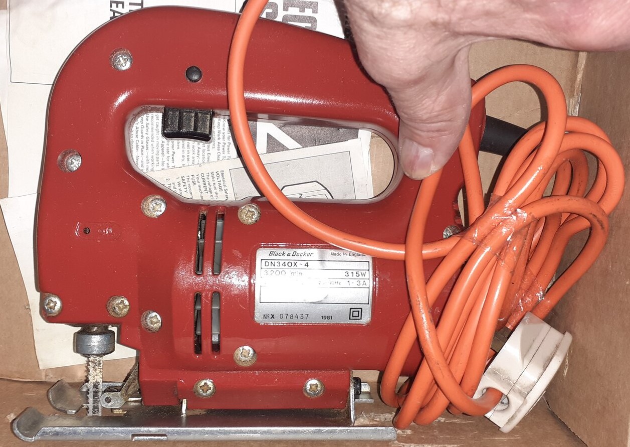

This thread has got me thinking about a couple of vintage B&D jigsaws I picked up just before COVID. One of them had an interesting design with a big, and hopefully rigid, blade holder/motion rod design. The other was a reasonably clean, not much used, bright red DN340X jigsaw. This is probably a rubbish tool but it was such an odd colour for a B&D tool (it was made early in their light grey/teal period in 1981) that I bought it.
How's that for a weird colour for a Black & Decker tool?

What has surprised from refurbishing a number of old power tools me is how accurate some of the DIY jigsaws from the 1980s were in comparison to their modern counterparts, B&D in Germany made some really quite decent saws for a while, presumably until the bean counters caught up with them
Yep, I have one - I think they were called the Pro range. Nice bit of kit, quite battered, but still working like new.
