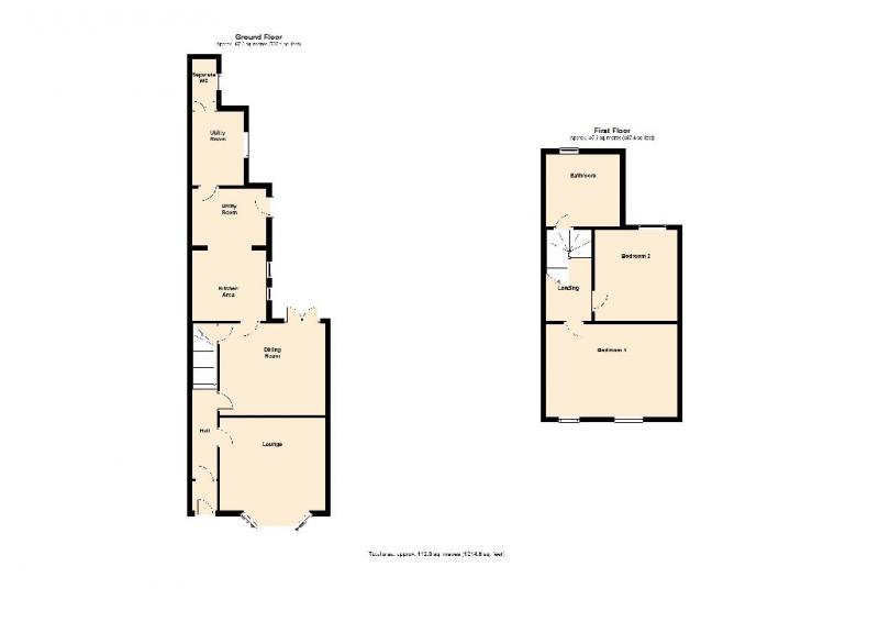

Just cut out the holes for the kitchen downlights. Only one is unobstructed.

Joiner cockup as in he was told to leave at least 130mm between new ceiling and the joists of the bathroom above.
This is now 90mm at worst point.

Can anyone clarify whether or not Fire rated downlights are actually needed.
The lights are needed in the Kitchen. Above the kitchen is only a bathroom
I have attached a pic of a floorplan that is very similar.
2 sparkies have told me I don't need them but they do commercial work
