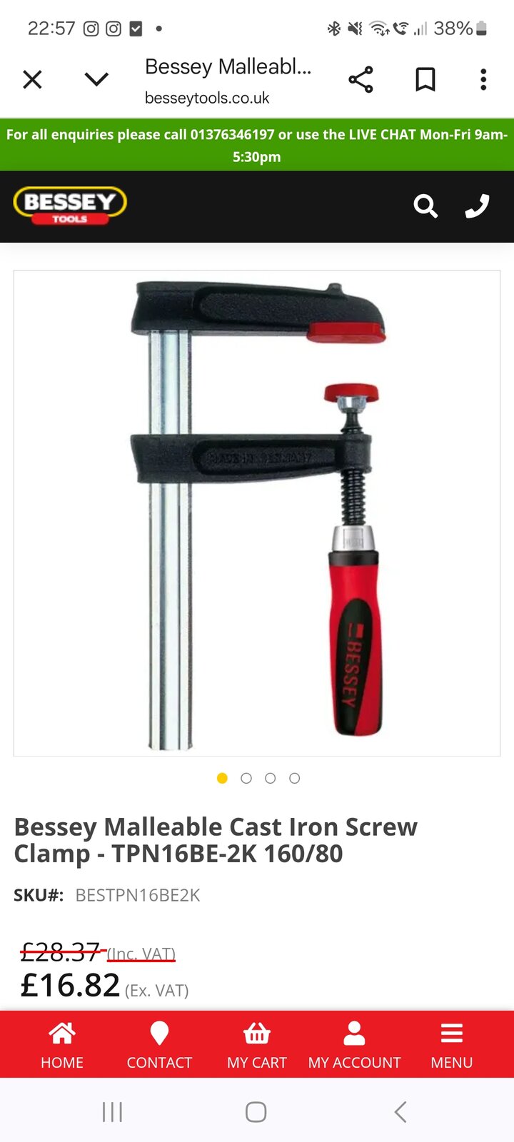

"Bessy Clamps"
had various bessy clamps on my list to purchase - so maybe a good excuse -
maybe NOT at that price

i have a few of those type of clamp - and various about 8 various lenghts - normal type (yellow) NOT mini and XP heavy duty (silver) - Irwin quick release clamps, which have a throat depth of 81mm - along with wickes and lidl versions
is there an advantage to that bessey clamp ?
throught depth 80mm - opening to 160mm

I wouldn't dowel there is no need.
Quick release clamps aren't strong enough imo, they can release! any clamp that you can tighten with a thread will hold better. I was just showing the cheaper fit for purpose bessy clamps.
