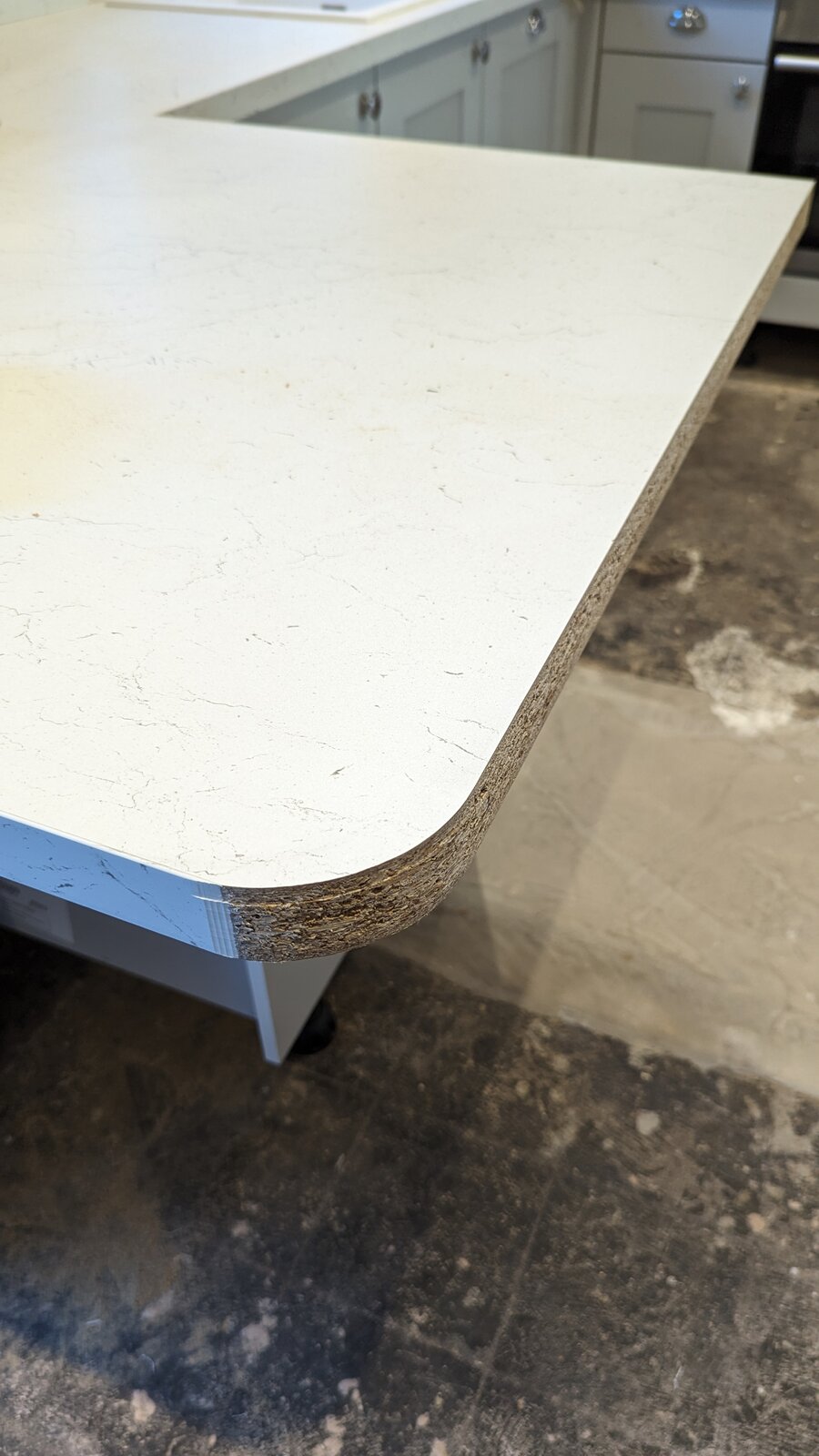

Joining laminate worktop edging
14 Feb 2021
24
Has anyone got any ideas on the best way to join edging to this?
Is it even possible? Or would it be best to try and remove it and put a whole new strip on?
You will really struggle to get it to stay on that part of the curve and far better to remove it and renew with a full length or if you must have a join do it on a flat section.
Hot air gun - pair of pliers.
To refit new edging you will need,
Contact Adhesive
Loads of face clamps
A trim router
A swear jar and a Pocket full of coins.
