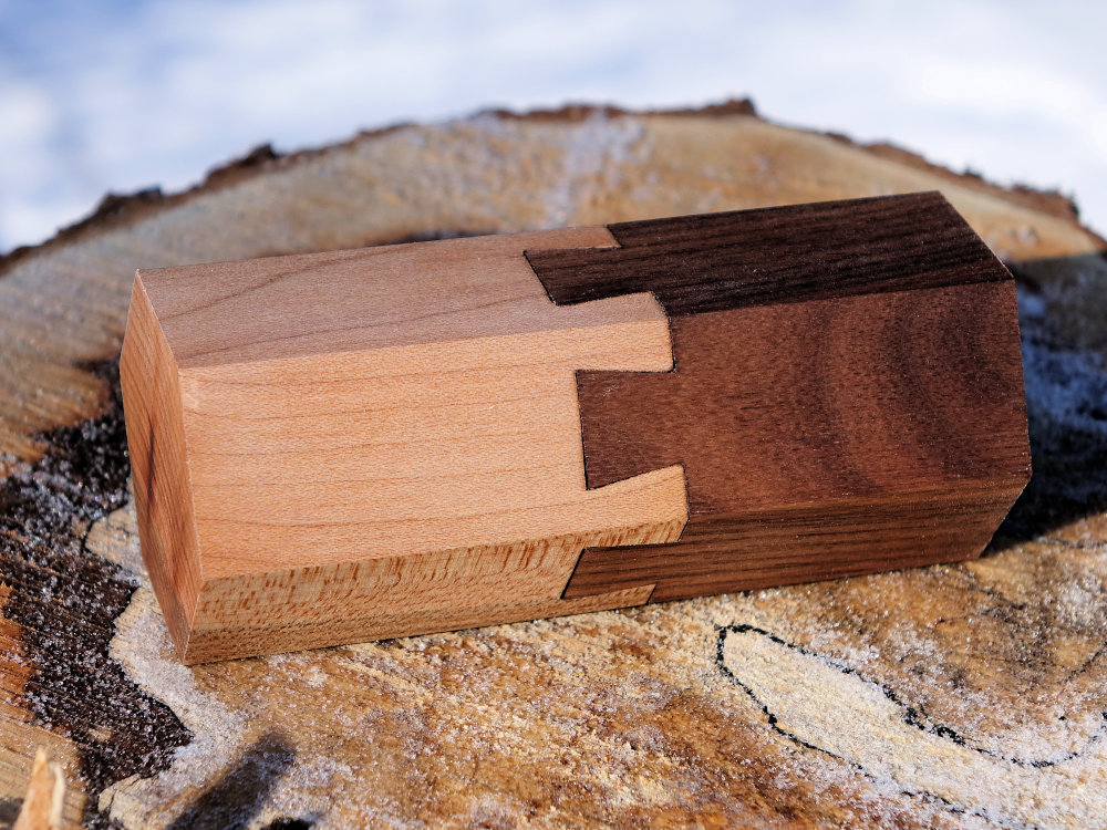

Anyway, I'll see your overcomplicated and over-priced domino idea and raise you a Japanese scarf joint. :cautious:
Perhaps? ;)
