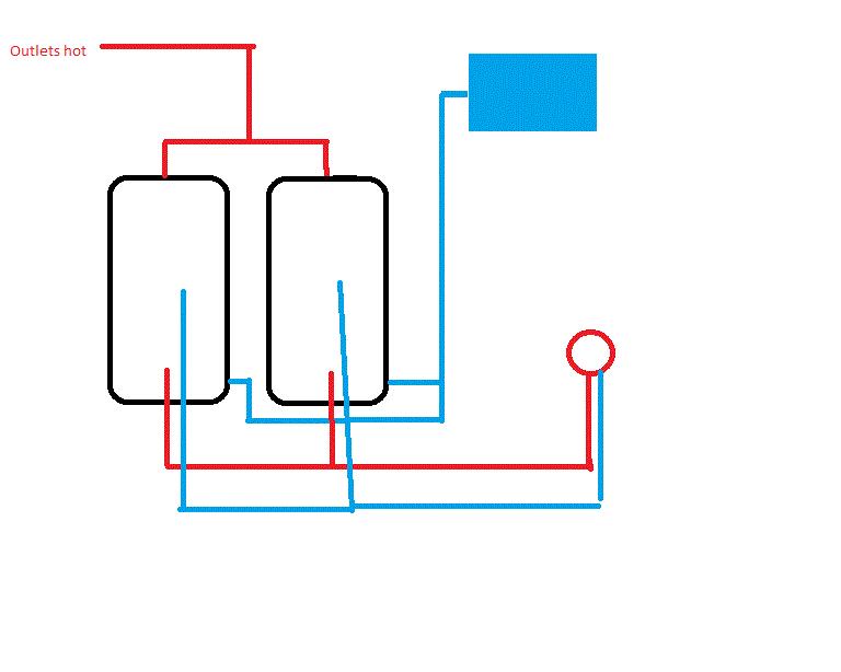

I have a 900mmx450mm size cylinder about 114 litres and I have plenty room for another next to it. Is it possible to join them together? I need more hot water capacity due to a large bath, two mixer showers etc.

would this design below work?
The red circle bottom right represents my CH pump. Blue box is cold cistern. Make sense?
My thermostat goes to the cylinder on the left, Presumably the cylinder on the right won't need a thermostat then?
The primary side and cold feed would be fine as the drawing but not the secondary circuit.
As the drawing is, one cylinder will be dominant, whereas the other could stagnate.
See my last post.
Very good Kev :cool: thats what it want for the secondary circuit. so get drawing. :idea:
na
if you think about it
where you gonna put the stat if nothing else
if on the left once it opens the other cyl gets no heat
if on the right the left cyl will heat to the boiler temp before the other is hot
the way you had the primary in your first drawing is a better plan
or even the reverse return i posted
along with the sec reverse return dia posted
simple this plumbing lark innit ;)

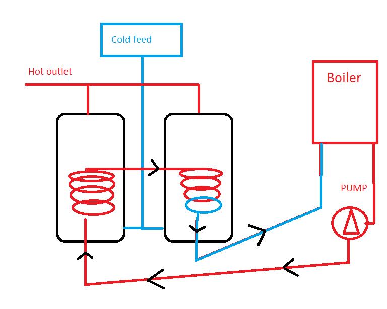

Good day Dan, trust you are well. :cool:
Have added the primary circuit to the drawing.
Not shown are individual valves for shutting either cylinder off for servicing.
