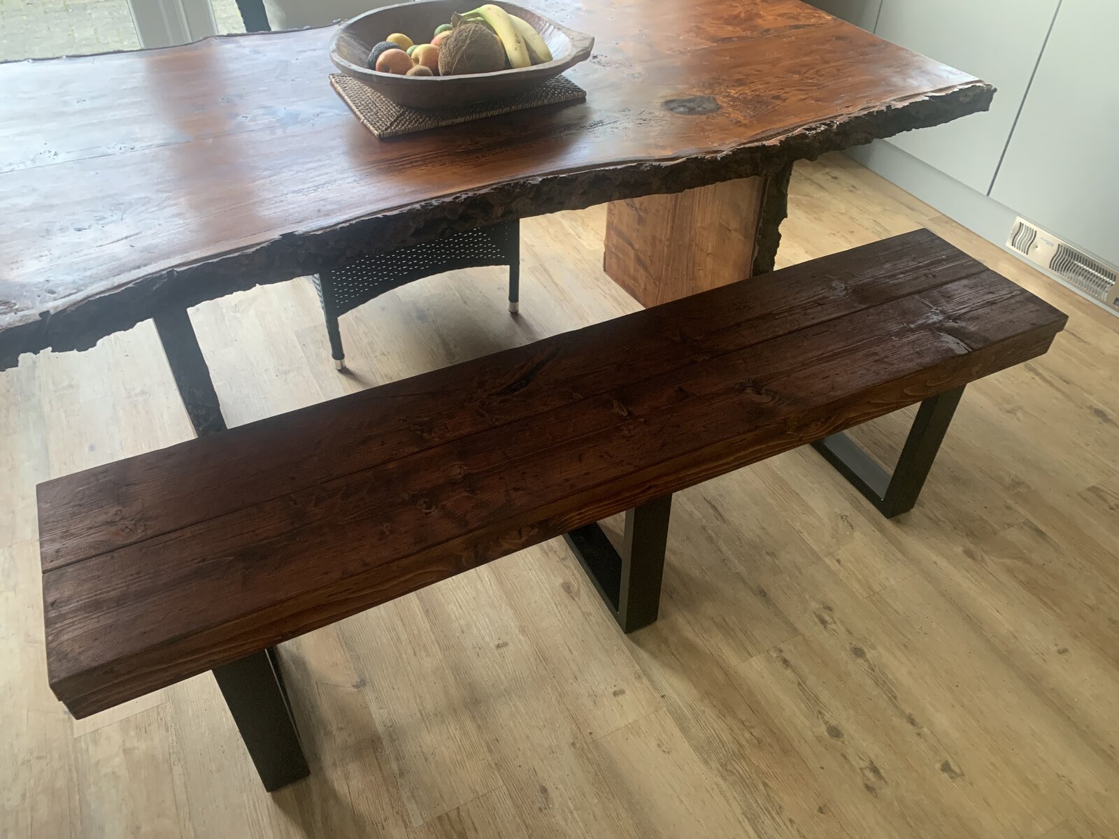

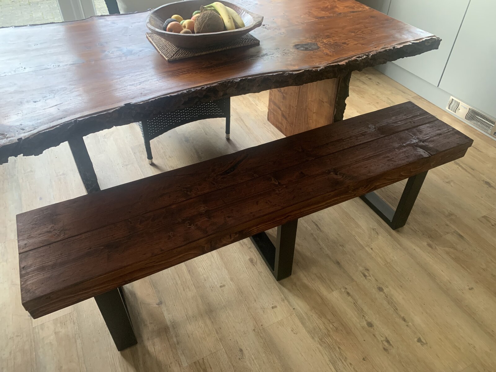

Exactly , using scaffold boards for shelves is for a rustic far from perfect finish .Bench below is two scaffold boards, sanded, oiled and screwed together from underside.
Not perfect , it’s not supposed to be.
Looks good, though.(y)
