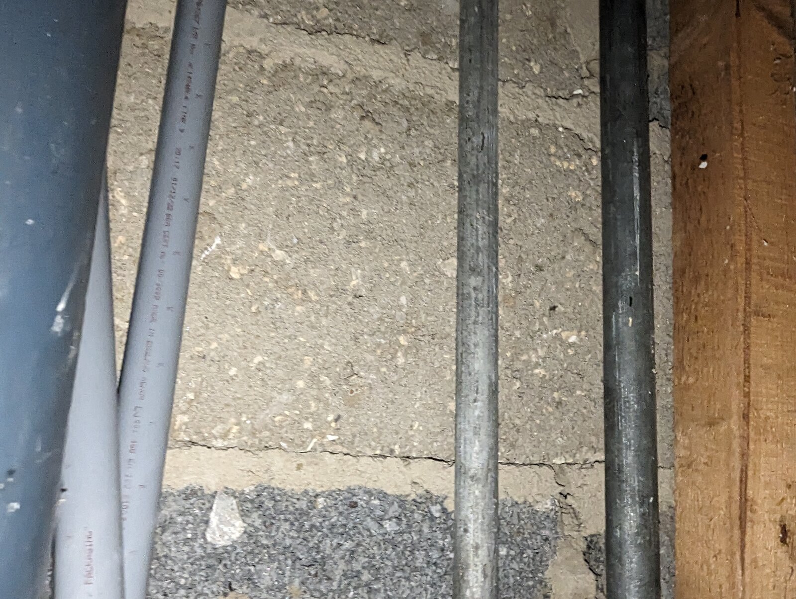

Hello. I need to connect the two steel pipes on right here (hot/cold) to the two plastic pipes on left. The steel pipes run to the existing kitchen and are in use today. The plastic ones end just out of the photo and have been set into the floor to (hopefully) link to a new utility.
How do I put a T on the steel pipes? Many thanks

Oh my, that won't be easy. You may end up having to transition the galvy to copper or plastic, tee from that and transition back. That won't be a very pretty solution either.
The norm for that would usually be cut the steel, thread the ends and then attach a dielectric coupler/nipple to transition to copper but that may not be possible given the orientation, alternative may be a plasson/philmac transition but they're really bulky.

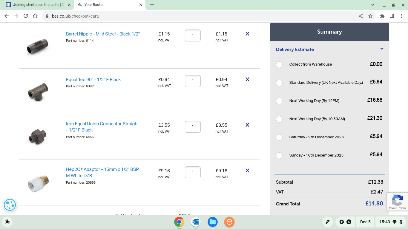

To insert a tee in the steel pipework, cut a two to three inch section from the steel pipe, thread the ends, thread a tee onto one end of the pipe and a nipple into the other end of the tee, thread a union onto the nipple and the remaining main pipe run end, This will leave a female branch that you can insert a male iron/pushfit adaptor fitting.
Obviously the threaded joints will need making with appropriate potable compatible materials such as ptfe or sealant like loctite 577.
the length of pipe cutout is obviously critical and needs to match the tee, nipple & union fittings you obtain.
A flat face union cf cone seat, will be easier to join if the pipe has no longitudinal

Not difficult, hacksaw/sawzall/grinder & files, threader and some stillsons, needs a little experience to gauge the length to cut out. Your best bet is to find an old boy who was around back in the day when barrel was regularly fitted as gas carcass in domestic!
If you fancy a go yourself then a hand threader, not lecky if pipe is adjacent to wall.

Just wanted to say thanks for all the helpful feedback on this, particularly to scw and madrab.
I cut the cold water pipe with an angle grinder and used plasson universal fittings at either cut end, and some mdpe tees and copper adaptors. That's all working well and we have cold water which is running the sink and dishwasher for Christmas.
The plasson fittings / mdpe doesn't appear to work for hot water so the hot water pipe will wait until can get someone into, or can get round to threading ends for the hot pipe.
