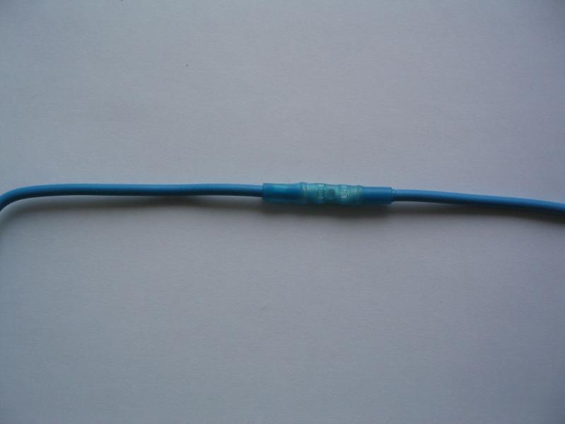

yes they are crimps..
you crimo the metal tube in the middle, then shrink the covers at the ends onto the cable and in doing so melt the hot glue so it adhered to the cable..
How about heatshrink ended crimps? neat sealed connection and nothing can get caught in the ends (unlike regular plastic covered crimps) e.g. http://www.rapidonline.com/Cables-C...-Conn./Heat-shrink-butt-splices/63945[/QUOTE]
Are they actually crimps - they don't state it anywhere, and mention adhesive which implies they're not?
If they are, they sound like a neat idea...
Yes - I think the adhesive refers to the inside of the heat shrink, often heatshrink is lined with hot melt adhesive as well to make it more effective.
