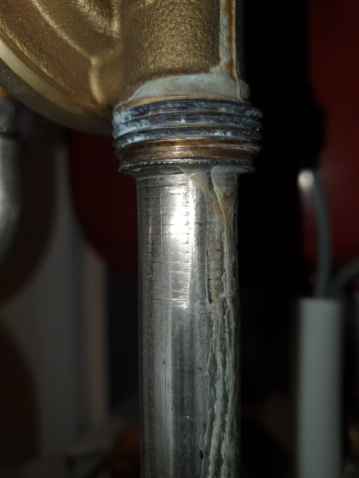

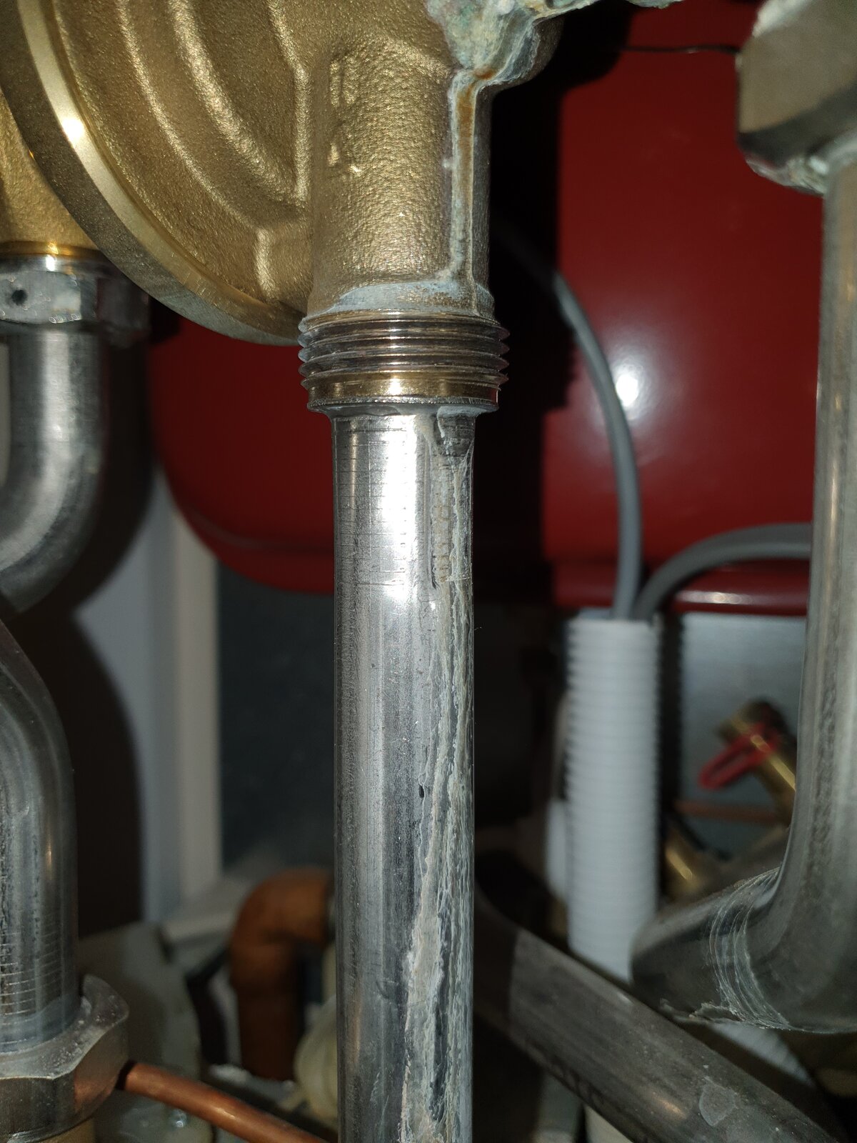

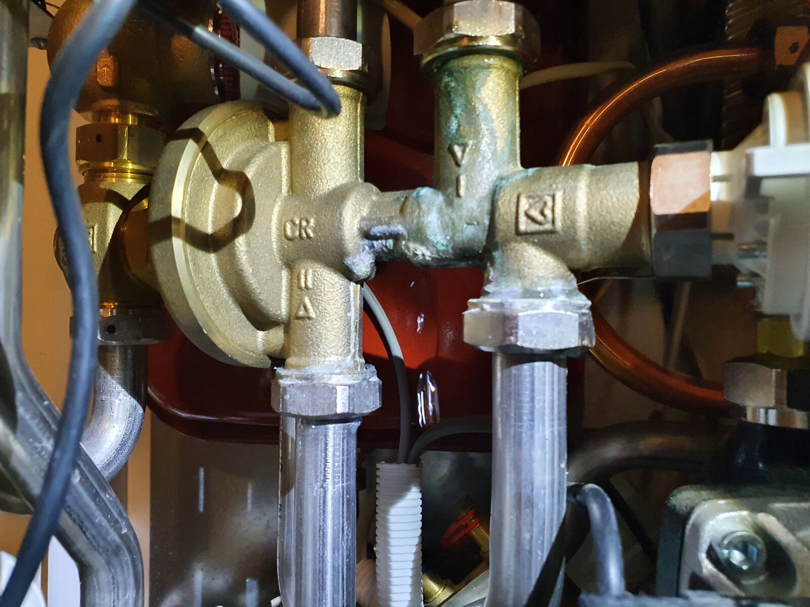

What's the best way to seal this joint?
Is PTFE the answer?

I presume it's not 'intended' to have a washer (?)
Would that be a retrofit method if tightening up doesn't do the trick?
Does the washer go between the trumpet and the brass fitting?
Doesn't want to separate as they're fixed in position

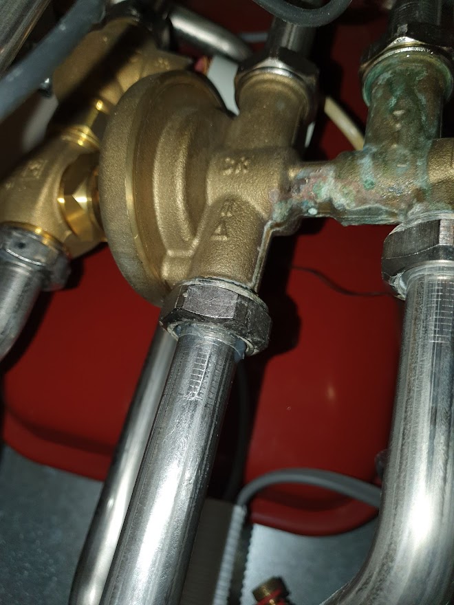

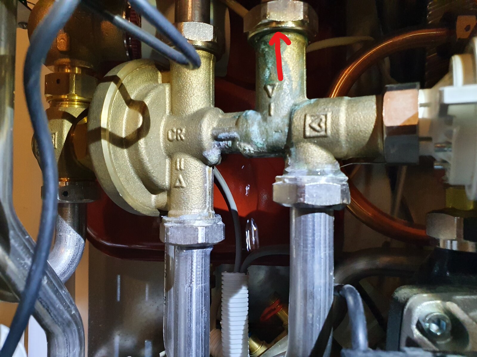

It's an HDU. The 'above' issue is coming from the diverter valve. I'm sure there's a logical explanation... anyone with any advice?
Looks like it is coming from here. post a pic of what is above that, as already said be very carefull, some of these run at extremely high pressures, not really a diy job
I get that, it's not really DIY. In fact as it's 'non-gas' I was sent out to deal with it as the maintenance spark. Someone decided it was an electric 'boiler' which is where I came in. However, turns out of course it's a water issue.
Plumber coming in the morning.
Sorry ianmcd, I didn't take any pics above what you see.
Yes lostinthelight, it is a communal system.
I was intrigued that the middle bit of the Pressure Temperature Control Valve has got a tiny hole in the bottom, which is where you can see the drip coming from. That's obviously an 'intended' hole ... so what's it for I wonder?
Some components that have moving parts in contact with fluids have a weep hole to warn you that the seal/gland is on the way out
