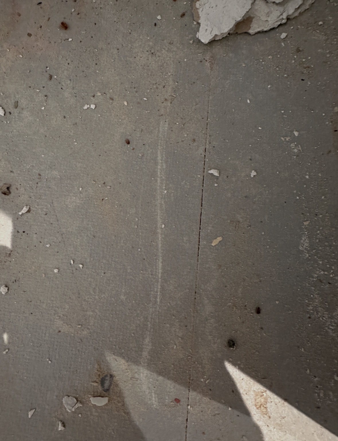

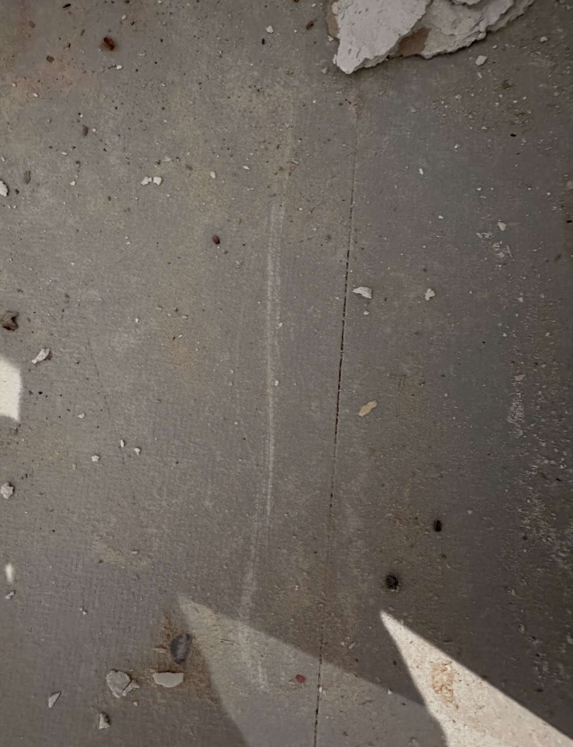

I’m stripping out my bathroom currently. I believe that it currently has a form of tongue and groove chipboard with some sort of grey top layer so not sure what sort of floorboards it is. I’ve attached a closeup photo of the surface.
Three questions:
1. All the floor boards have uniform join lines with screws. Are the joists likely to be going in the same direction as the joints or the opposite? So if joints a vertical in the floor boards, are the joists likely to be horizontal?
2. Since this is tongue and groove, what’s the best way to remove? I’m assuming I need to find the end and start from one end?
3. What is the grey top layer on the board? Has it been tanked maybe?
that looks like cement/backer boards, which would normally be tile adhesive’d and screwed down onto ply/timber/chipboard. If so, the screws don’t indicate joist positions as they only go into the subfloor not the joists.
Yip, these are tile backer boards, and as 23vc says, will be stuck down with tile adhesive and screwed. They don't come tongue and grooved - will be straight edged. The substrate under that is ' likely' to be: for older houses tongue and grooved floorboards which will be at 90 deg to the joists, and for modern houses will be sheets of t & g chipboard.
Unfortunately, if you really have to take them up, it's gonna be slow and tough.
