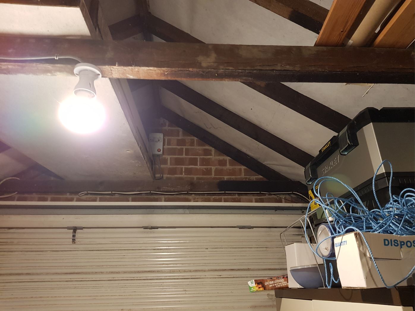

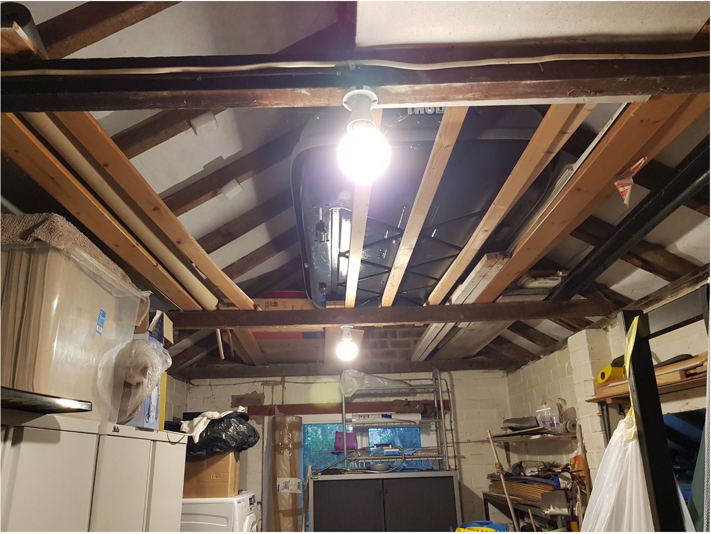

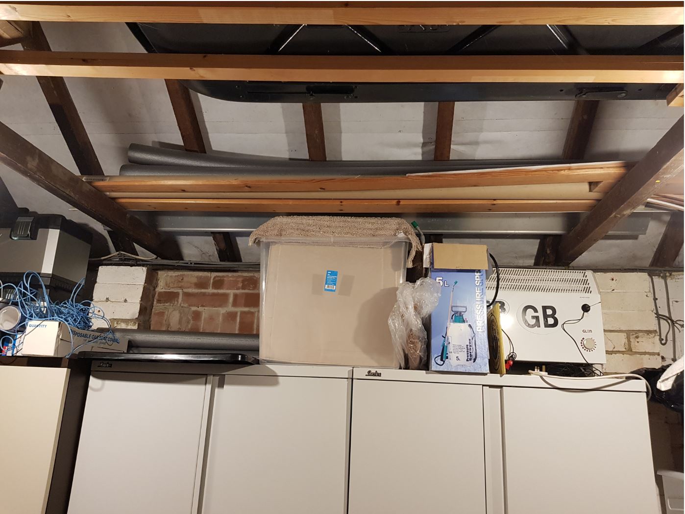

Hello,
I have a detached single skin brick garage (with two brick piers on each length of wall) built in 1961.
Span 8'10"
Wooden Wall Plate Width 3" (sits on top of the single skin brick wall).
Rafters spaced at 17".
Existing Rafter Ties are approx 3"x2" timber spaced at 5.5' intervals.
I'd like to create some joists so I can store more stuff in the roof void. I'm not planning to board it over as I appreciate this will add a lot of weight.
I was considering C16 timber, either 4"x2" or 5"x2" (metric equivalents) to span the 8'10" at 17" intervals to match the rafter spacing. I would rest these on the existing 3" wide wall plates with ends angled to match roof line (provided I can manoeuvre them into place) and nail or screw sideways into the existing rafters so they act as rafter ties as well as joists for storage. I'd leave the existing timbers in place, and simply put the new joist/tie on the opposite side of the rafter in those instances.
Any tips or advice much appreciated. Especially with regards to which wood type and dimensions to use, whether to screw or nail into rafters, and whether I am likely to be able to manoeuvre them into place in one piece? Thanks

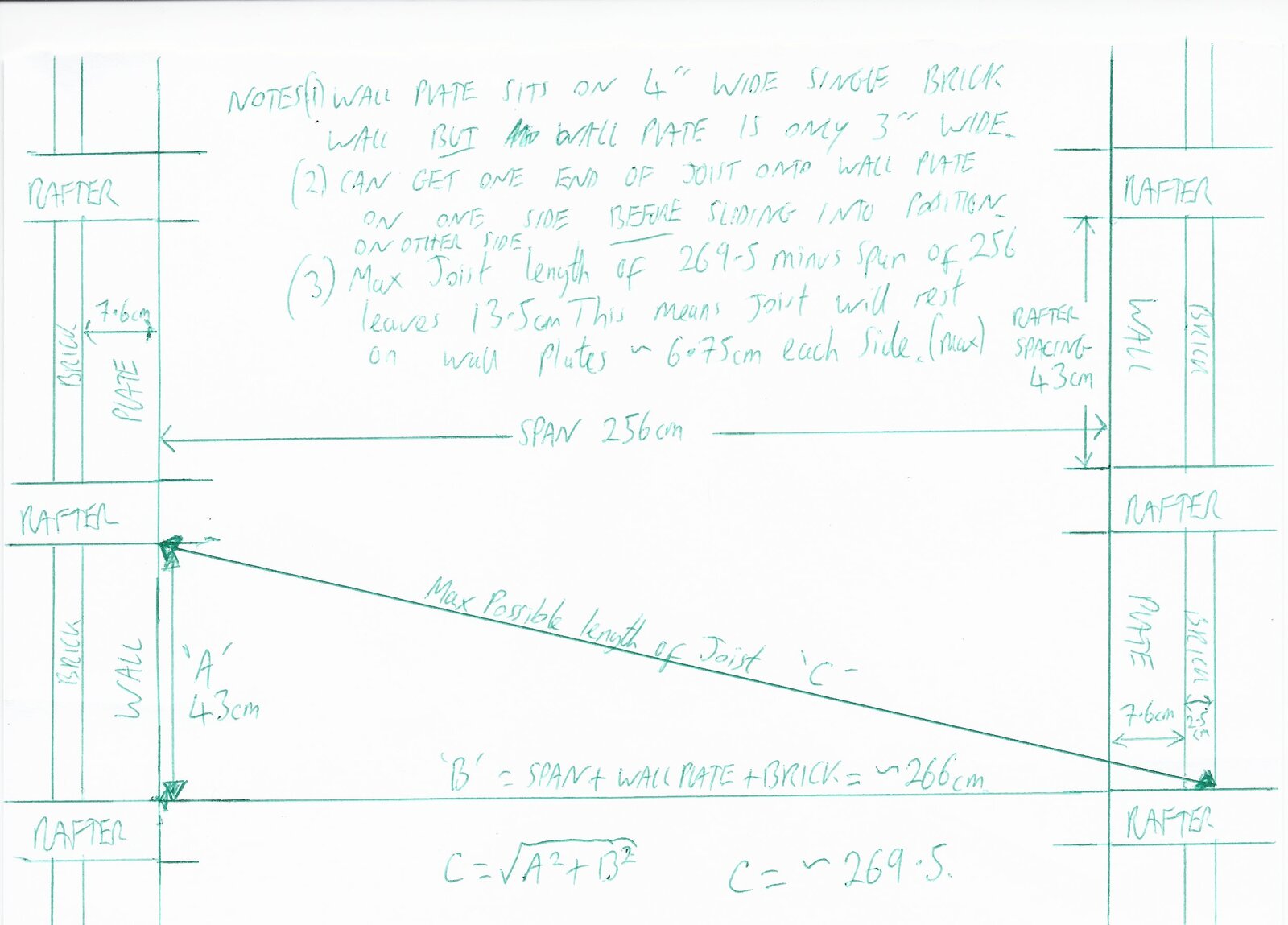

Wiggling them in will be the problem. You need to do some sums....
Length of new joists = 8'10 + 6" so 9'4
Clearance between walls 8'10
Wiggle room 1'5 minus thickness of new joist so 1'3
Pythagorus says you end up with just over 8'11" to play with....

Cheers for the advice :-) Yes, I am worried about this. I was thinking I could get one end in over the 3" wall plate first then manouvre the other end in place, but it will be tight. The bricks are 4" wide so effectively have a spare inch each side beyond the wall plate.

Think your wiggle won't work- or will need you to shorten the joists by an inch. You'll still only have 9'3" to play with...

I'll buy some treated C16 or CLS timber. I assume if I can only overhang the wall plates 2" each side that will suffice as that may be the case in order to wriggle the joists into position. Also wondering whether treated 89mmx38mm CLS would do the trick? It's a lot cheaper

Does this calc look right based on an aerial view of garag
e?
You've given yourself too much gap between rafters, you have to allow for the thickness of your new joists (so useful clearance will be 370mm not 430)
