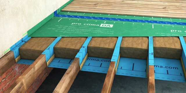

Sorry I may have misunderstood your proposal, don't run the joists from old house to new front wall, run them from side to side and do a double joist at the old building end to take the flex out on the change from the brick of the gap to the new suspended floor....You will need to ventilate the space below and a cross draught is essential, joists should always run in the direction of airflow, otherwise a moisture line builds up on the back of the joist. , . Make sure you bottom batten your joists before you shove them in, so that your insulation has something to rest on if you are using rigid. I would consider very carefully insulation at this point.
Personally I prefer draping the joist with roofing membrane ( felt in old speak) and then slab matting to rigid foam as you don't need an gap sealant and the matting if compressed when you put it in moves with the joist.
eg
